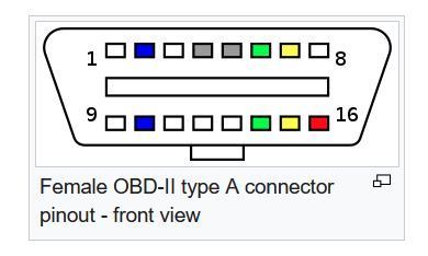

If the car is NOT communicating with any scanner then you have bigger problems? You can check for 12 VDC on pin 16 of the OBDII port.
