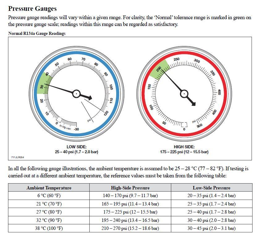

kpoghosyan without any pressure readings it will be difficult if not impossible to figure out what's going on.
Any chance you can post some hi and lo side readings?
This is from a Jaguar AC manual and will get you in the range.
