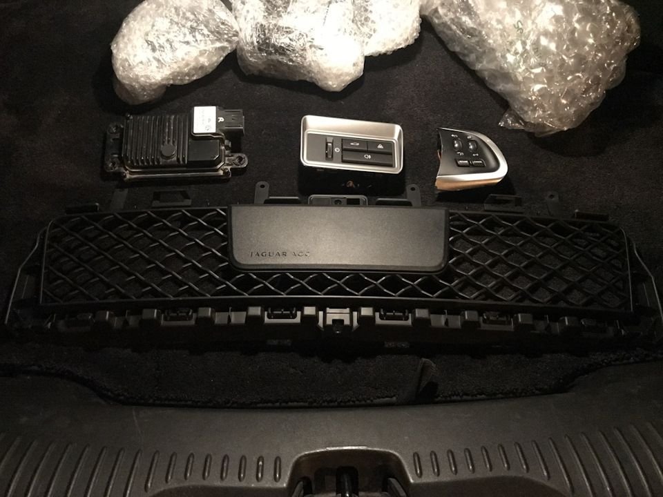

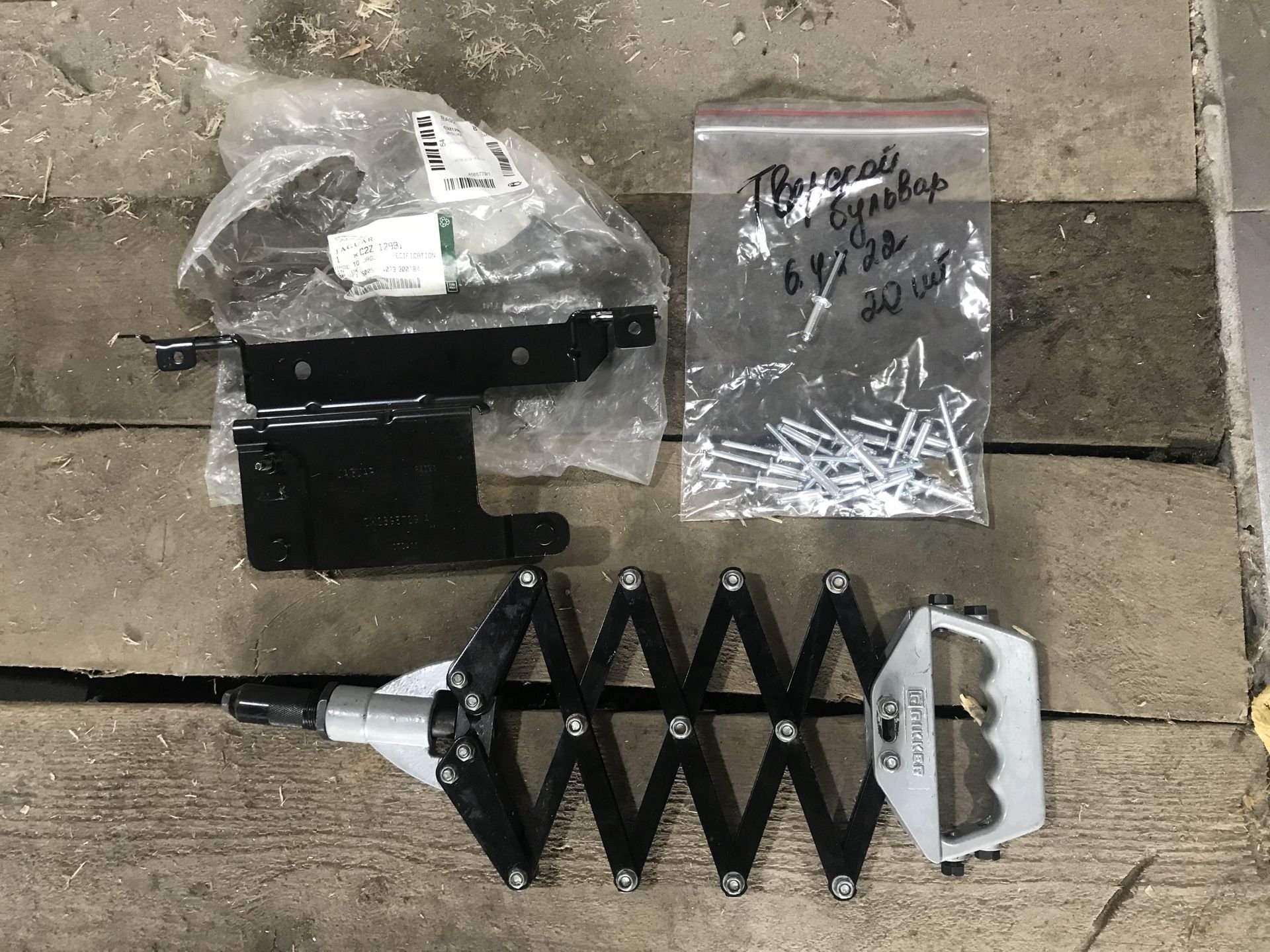

Hello world! I installed adaptive cruise control to my 2013 XF 2.0GTDI and it works great! I got all parts used from ebay, only radar cradle was new. Installation was quite easy, all wiring already exist in all facelift XF. Then i activate and calibrate ACC. It was not difficult too. Just drive about 15 minutes till ACC indicator stop flashing. Then i recode ACC to activate stop and go function. It works ok too. Now ACC doesn't turn off at speed less then 25mph. It stops the car in traffic jam, then i just press accelerator and cars continue chaising another car. Great mod! If any questions - welcome!

of course:
CX23-9G768-AC — radar (you need slim one with hs-can bus. Other part numbers are compatible too, but needs to reflash)
C2z12991 radar cradle
C2z1491 LH buttons in dash. RH/LH are different, but works both.
C2z13445 buttons in steering wheel
C2z16176 R-sport bumper grille for acc

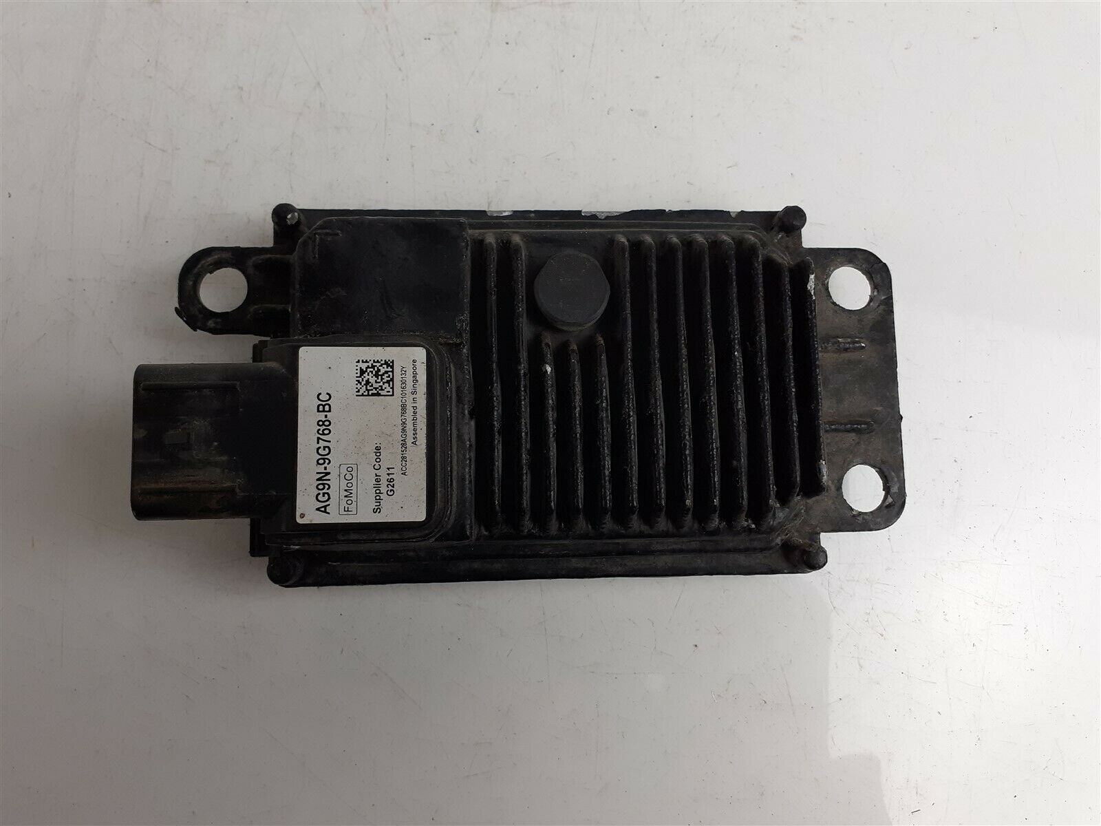

Nice job! How do you reflash the radar module? and can you use the same module from a Volvo for e.g. AG9N-9G768-BC and reflash it
