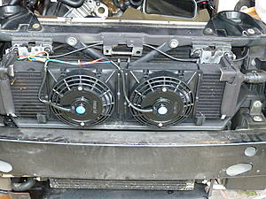

I have done exactly that on my 2005 XJR. However I added 6" fans to it.
I added an upgraded Bosch pump as well.

That is why I have fans to get the required airflow thru not just the addon radiator but whatever is "blocked" behind it in my installation. Also upgraded puimp.
When all fans are running the volume of air going thru the radiators and the engine compartment is quite phenomenal.
