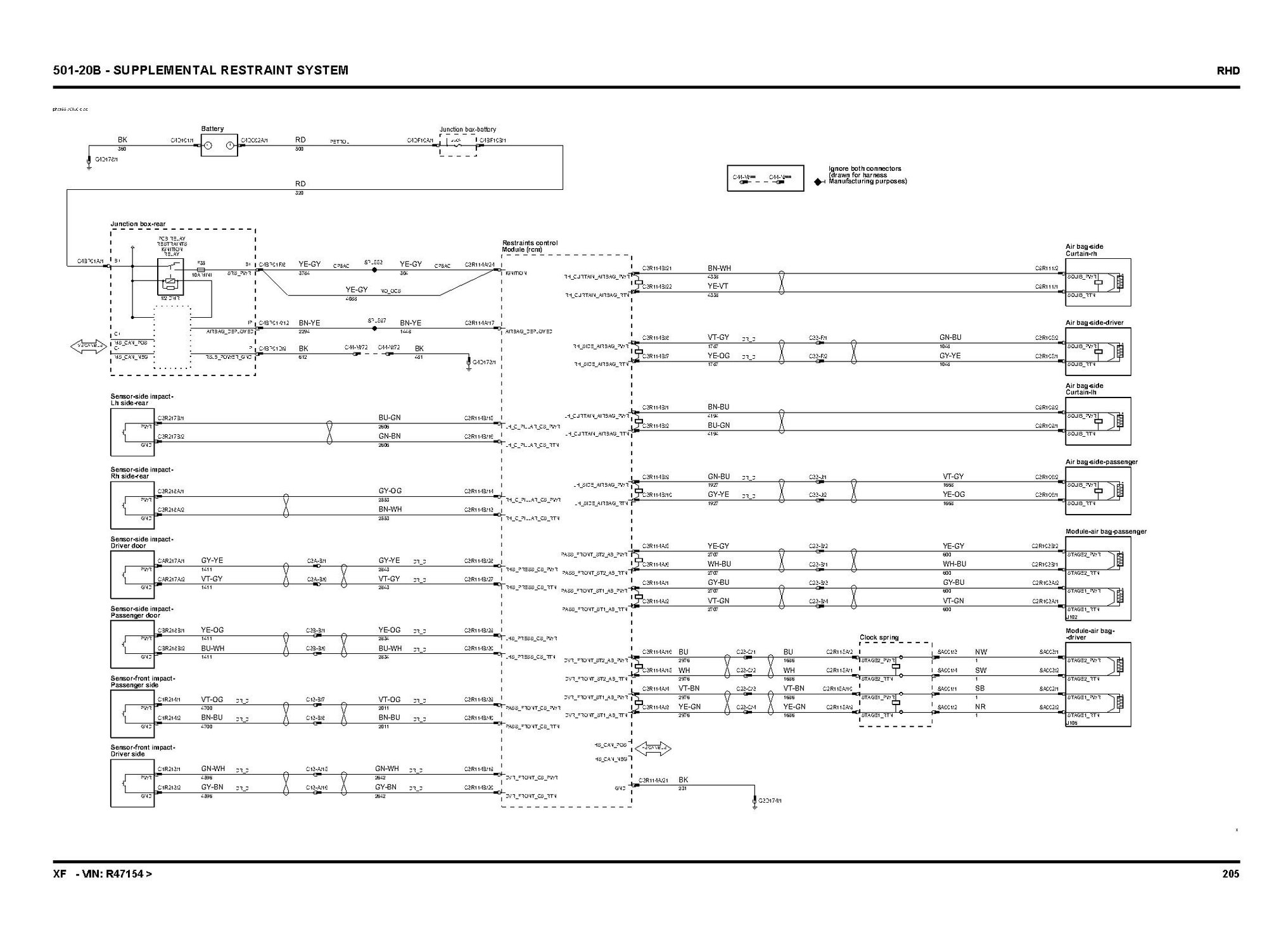

What's my question? Anyone know where the air bag wiring is routed, and where the sensors are in the front bumper?

Hopefully this might help, it is off my 2010 XF NA 5.0 wiring diagrams. If you have SSD, I would run a scan on it just to verify.
If I don't see anything showing the locations, I can compile something tonight for you.

Thanks! The diagrams will be super useful.
Turns out my Innova scanner does scan SRS DTCs, I intend doing a scan tomorrow, I imagine it will show an open in either front or side impact sensors due to Rat action but we shall see.

As suspected, code B1195-13 which is an open circuit on the passenger side front sensor. Now to find the wiring and where the little s**t has chewed it through. I need to re-up my game in killing my neighbor's rats.
