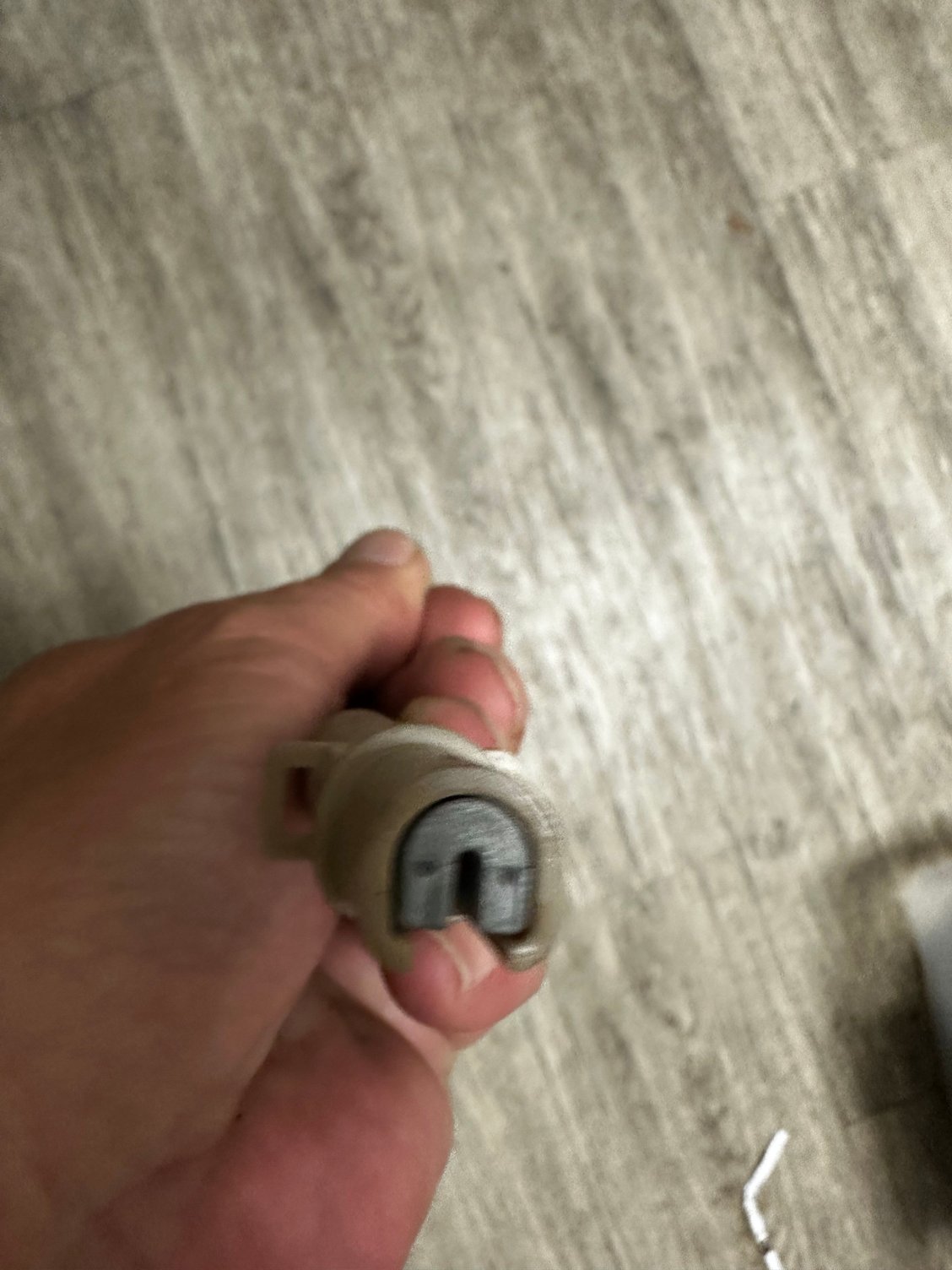

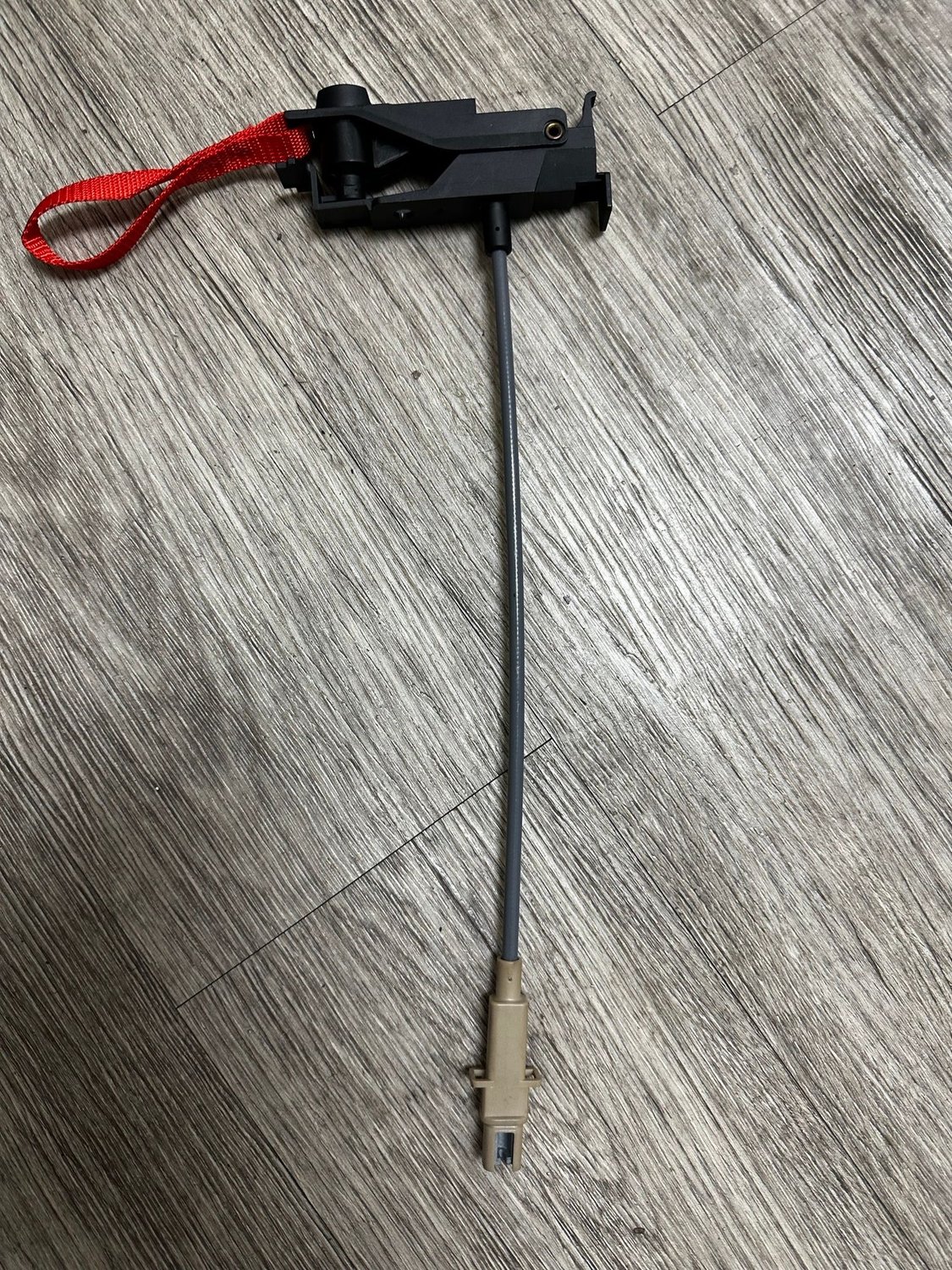

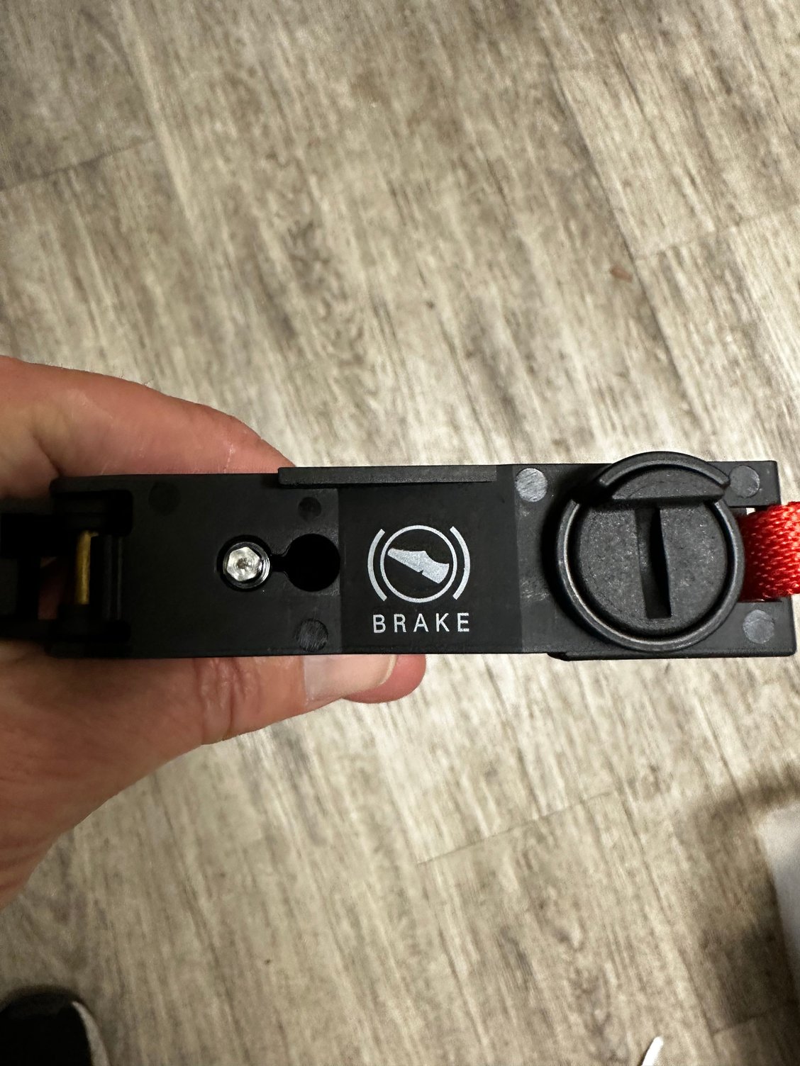

I had to get the complete set for the spare tire and when I was putting everything away, I found this just lying around next to the spare wheel. Just wondering if you guys know what it is and what I'm supposed to do with it. Thanks!

Its to put your vehicle in neutral (from the engine bay), on the right side under the central cover.

My 2015 XF X250 has one of those items in the trunk. The polystyrene insert which is placed on top of the spare wheel and holds the tools has a place for it molded into the top. There is no place for it in the interior of the car. My Owners Handbook neither shows this item nor refers to it and I have no knowledge of how to use it. I would be very much obliged if someone could show us how this device is installed and used.

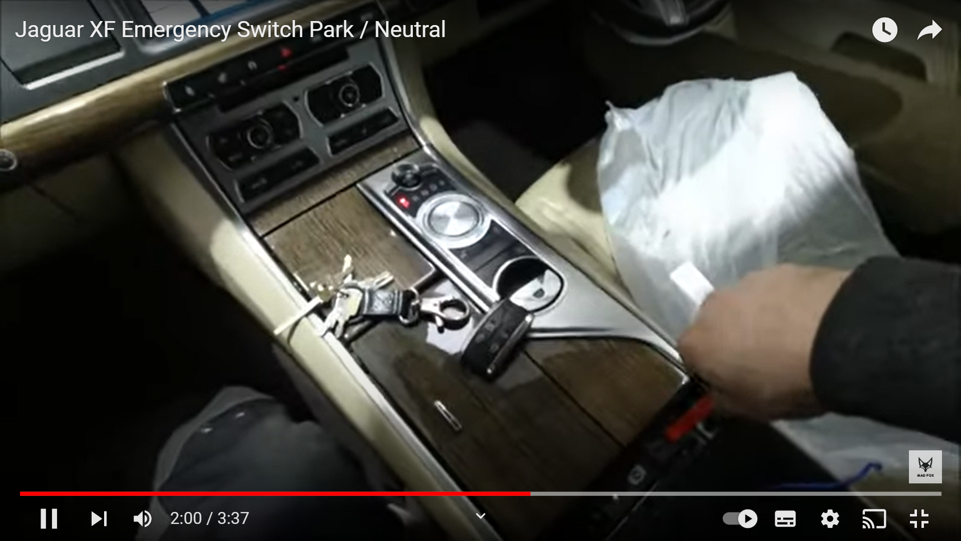

Just found out about this and for AWD cars they use the external tool shown in the original post. So IF you have an AWD version make SURE that release tool is in your trunk. If the car breaks down and needs towed you can place the transmission in N. Also don't forget to release the EPB after placing the transmission in N so you can move the car. It takes very little DC power to release the EPB and if the car is completely dead a jump will provide enough power to release the EPB.
BUT this tool connects under the hood!! Yes I could not believe it. I also could not find a single thing in the owners manual.
This is also how it works on the XJ which I have. Here is a video showing both the RWD and AWD transmission park release methods on the XJ. It looks like Jaguar used the same device across the different models too?
