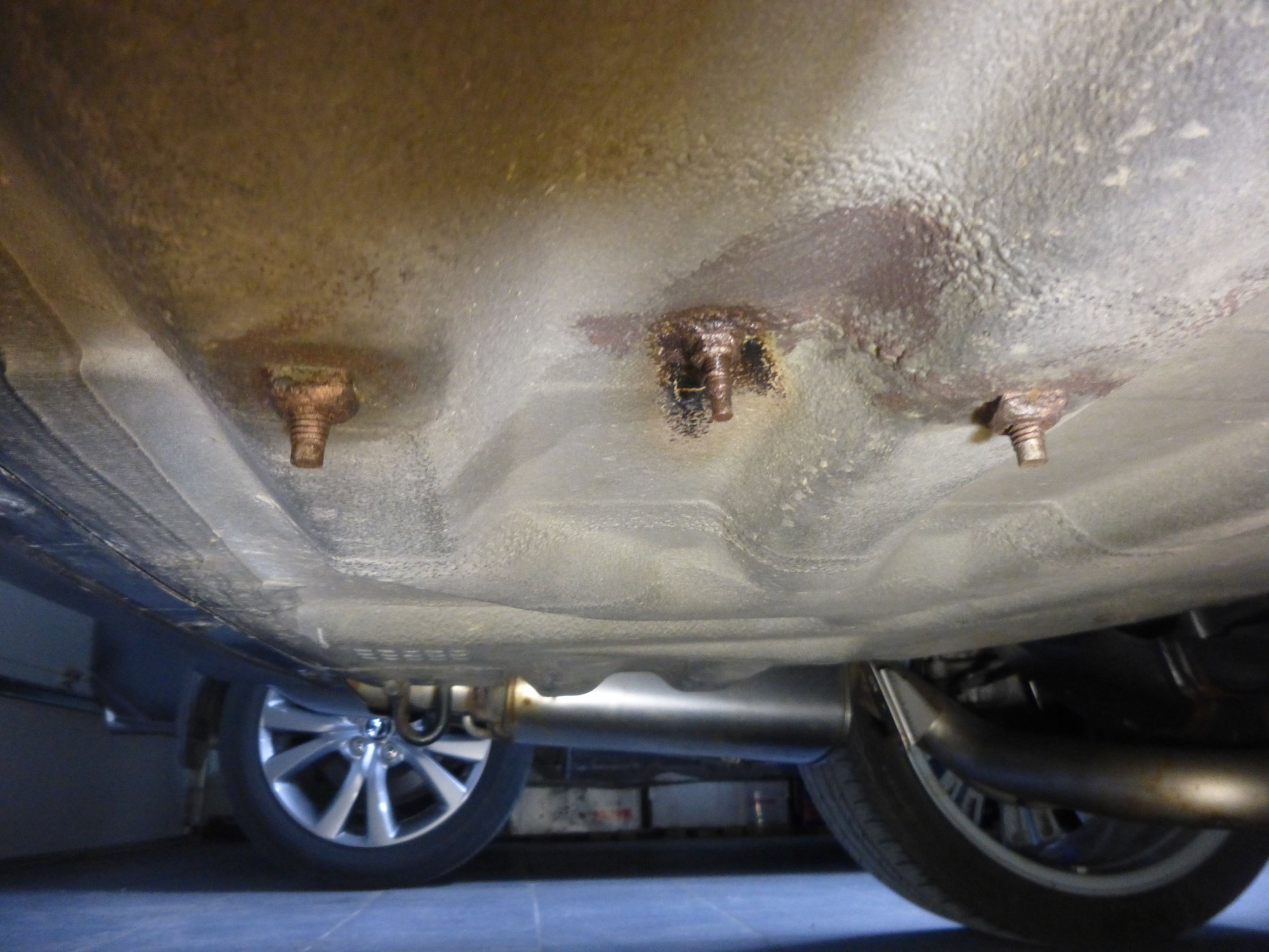

Originally Posted by James_Bond
Excuse my ignorance use vise-grips and loosen bolt on the bottom as opposed to the bolt inside the trunk or hold the bolt on the bottom while loosening bolt in the trunk?
No problem. Attached pic shows the underside of trunk on my 2012 XF. You need an assistant to hold the captive nut underneath. While there you can loosen and lubricate all of them. When I did mine I applied some heat to the bottom of each bolt first and then loosened the bolts.
