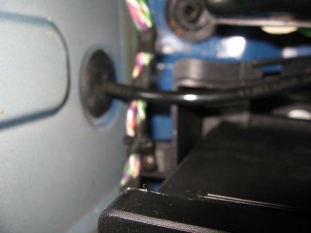

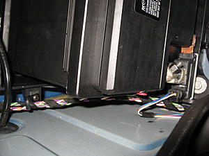

The vent tube definitely comes out of a right-angle piece of plastic tube that is stuck into the front part of the battery. In the attached photo, you can see that it is next to the red covering over the positive terminal. The tube (which is black) goes down and to the left. In the second photo, you can see the edge of a small red plug that is inserted into the hole at the rear of the battery (the bottom of the photo is the positive end of the battery at the rear of the car). If you want, you can insert the tube into the negative (rear) end of the battery, but you'll have a lot of excess tubing unless you cut it down.
The tube exits the trunk through a round black grommet that is on the rear of the trunk (not on the bottom) on a vertical plane (see 3rd photo).
Hope this helps.

Exactly where you said it would be - thanks Long Islander
