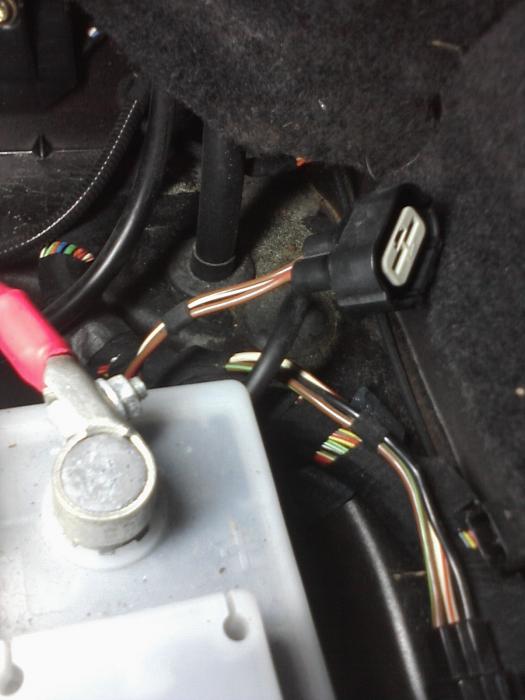

Question
Thanks to this thread I found that I had a vent tube, but it was not connected to the battery. After reconnecting it, I also saw an electrical plug next to the battery that is unplugged and nothing nearby to plug into. Everything is operational, so anyone know what it is?

That connector is used for when the vehicle is shipped, its plugged in to keep the battery from going flat.
