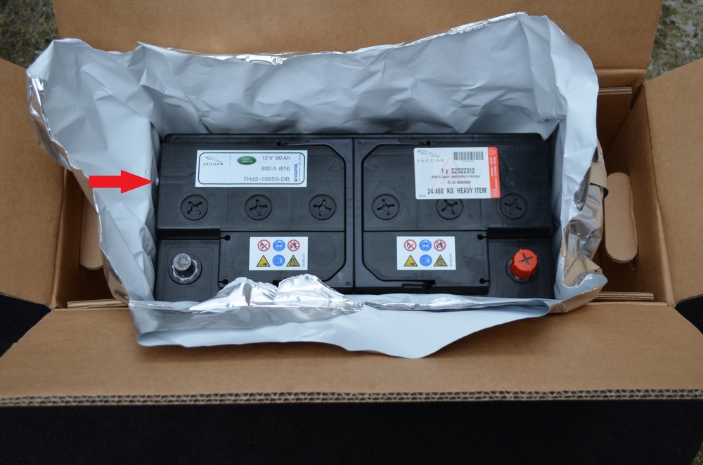

Have new Battery from Advanced Auto. Battery is sealed. Does not appear to have a vent tube hole but there is a hole on the ends. Should I connect to this hole?

The vent hole is "usually" on one end or both.
They sometimes have a sealing plug that needs removing first.
Remove one plug, fit your vent arrangement, leave the other plug insitu.
Old Apr 22, 2015 | 04:31 AM
+1
An OE Jaguar battery is supplied plugged at both ends with the vent pipe adaptor in a separate packet to avoid damage in transit. The left hand plug can be seen here arrowed in red. The right hand is also plugged but this one is not visible in the photo:

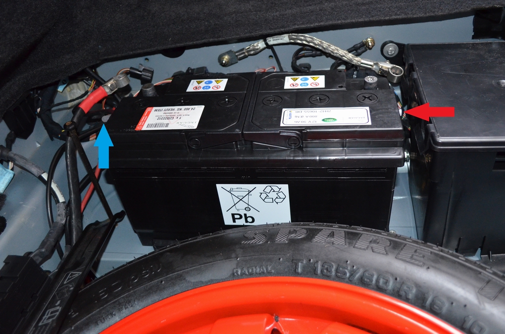

Here the left hand plug has been removed and the vent pipe adaptor with vent pipe fitted (arrowed in blue). The right hand is left plugged (arrowed in red):
If your replacement battery is a 'wet' lead acid type then it must be vented to prevent build up of potentially explosive gas in the luggage compartment.
