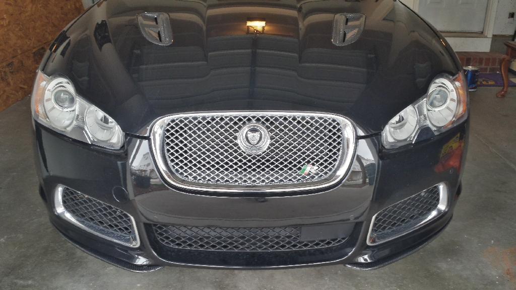

How it sat before in all of it's dirty glory:

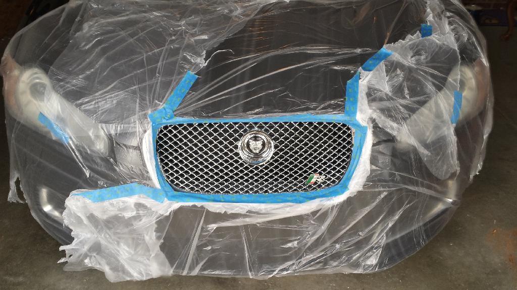

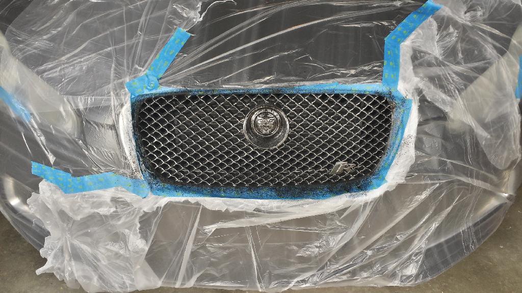

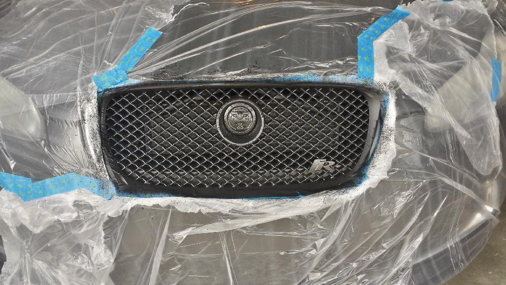

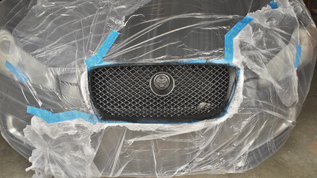

Step 1: Mask off everything you don't want overspray on. Leave about a 1/4 to 1/2" gap when taping off the trim around what you want dipped so that you can peel it off later. Fortunately I don't paint for a living as you can tell from my masking skills but it works haha. *Note* I did not cover the radiator but you may want to if you are worried about overspray reaching it. I will tell you that not much will if you don't.
Step 2: Clean up your grille and apply coat 1. Wait half an hour for it to dry. It's not going to look super great on the first pass so don't stress out. Unfortunately the weather is cold right now and my can of Plastidip was sitting in the garage so I had to swap it in and out of a warm part of my house to keep it spraying correctly.
Step 3-6ish: Apply several more coats, in my opinion 5-6 is the sweet spot because it will be less vulnerable to rock "chips" and protect the grille better. On our particular grille make sure to be deliberate about spraying at diagonal angles and upward angles to get inside all of the crevaces. It is a pretty busy grille design so you don't want to miss any spots.
If it starts to look a little chunky that is fairly normal and it's made probably a little worse by it being cold. Just spray another layer over that area and the dip tends to settle out and smooth a little. Again I'm not the best painter so others can probably get a smoother final coat but the texture isn't noticeable unless you're 6" away

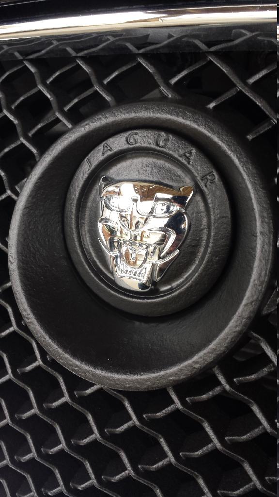

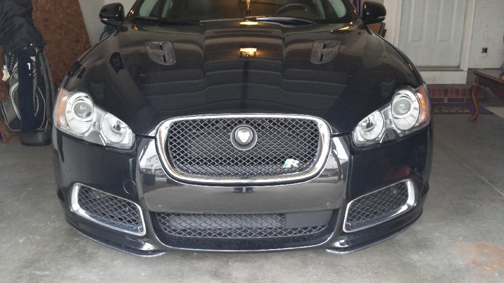

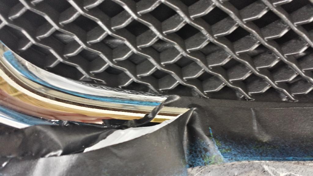

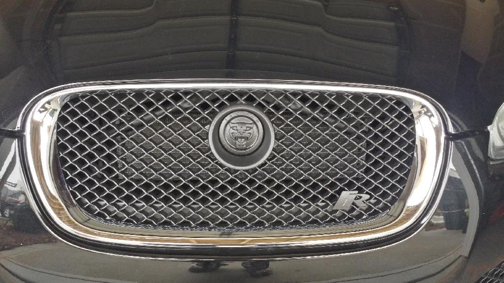

Step 7: Unmask and begin to peel off the excess from what you don't want the dip on. I chose to remove it from the R badge I had on the front as well as the growler. Wherever there is a "threshold" of trim to trim it should peel right up fairly easily leaving what is next to it intact.

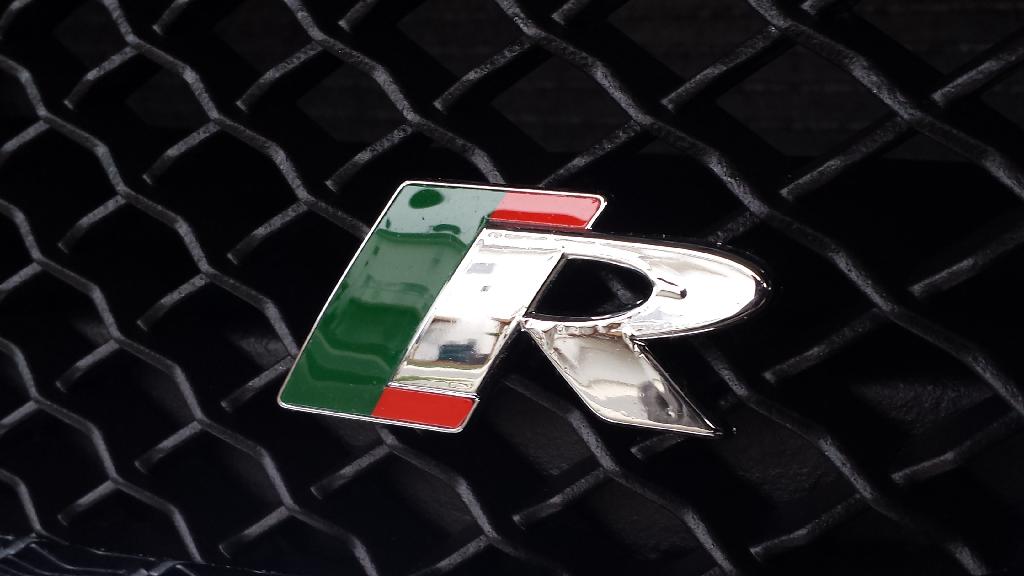

I left just the chrome growler peeking through mostly because I was impressed that it came off of him that cleanly ha. I may end up pulling the "JAGUAR" ring off around him but for right now I'm going to let him stand out:
If you get any overspray, you can pretty easily rub it off with your finger or a clay bar will get it up pretty quick. This stuff is pretty awesome, it can ultimately be peeled off or redone again if you don't like it. Although it would be pretty hard to get it off all of the crevaces in your grille. I even did a TV stand for my wife since I had plenty left over with 1 can:
That's it! Post up if you have any questions!
