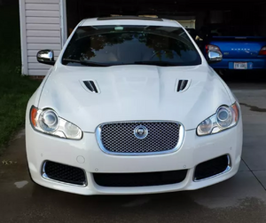

I completely removed my grille and painted it. I took pics so I could post instructions & will try to post this tonight after work.
I have done my grill as well. It has held up great so far, but the Wisconsin winter will be the true test. I also did my emblems and window trim as I am not really a chrome fan. With my last car, which was a STS-V I painted the grill, but it didn't hold up very well at all. PlastiDip works so much better against rock chips and protects the surface.
My last project was to do my wheels. I wanted to try something different so I just did the recesses of my stock Volans to give it a little meaner look. I may go full black at some point, but I kind of like this for now.
What you will need:
Bumper removal:
•Torx Key set (I do not recall what sizes – my apologies)
•A friend
•Patience
Grille Painting:
•Bucket
•Car wash soap
•Brush
•Flat head screwdriver
•Double sided tape
•Automotive plastic spray paint
•Cutting tool
R Badge install:
•Torx Key set (I do not recall what sizes – my apologies) – These parts cost me $119. The screw provided (one of the parts listed below) did NOT fit. Don’t bother buying it. My apologies – I do not recall which part number it was. I used a screw I had.
•Jag OEM C2P22603
•Jag OEM C2Z 1327
•Jag OEM C2Z18830
•Jag OEM C2Z18831

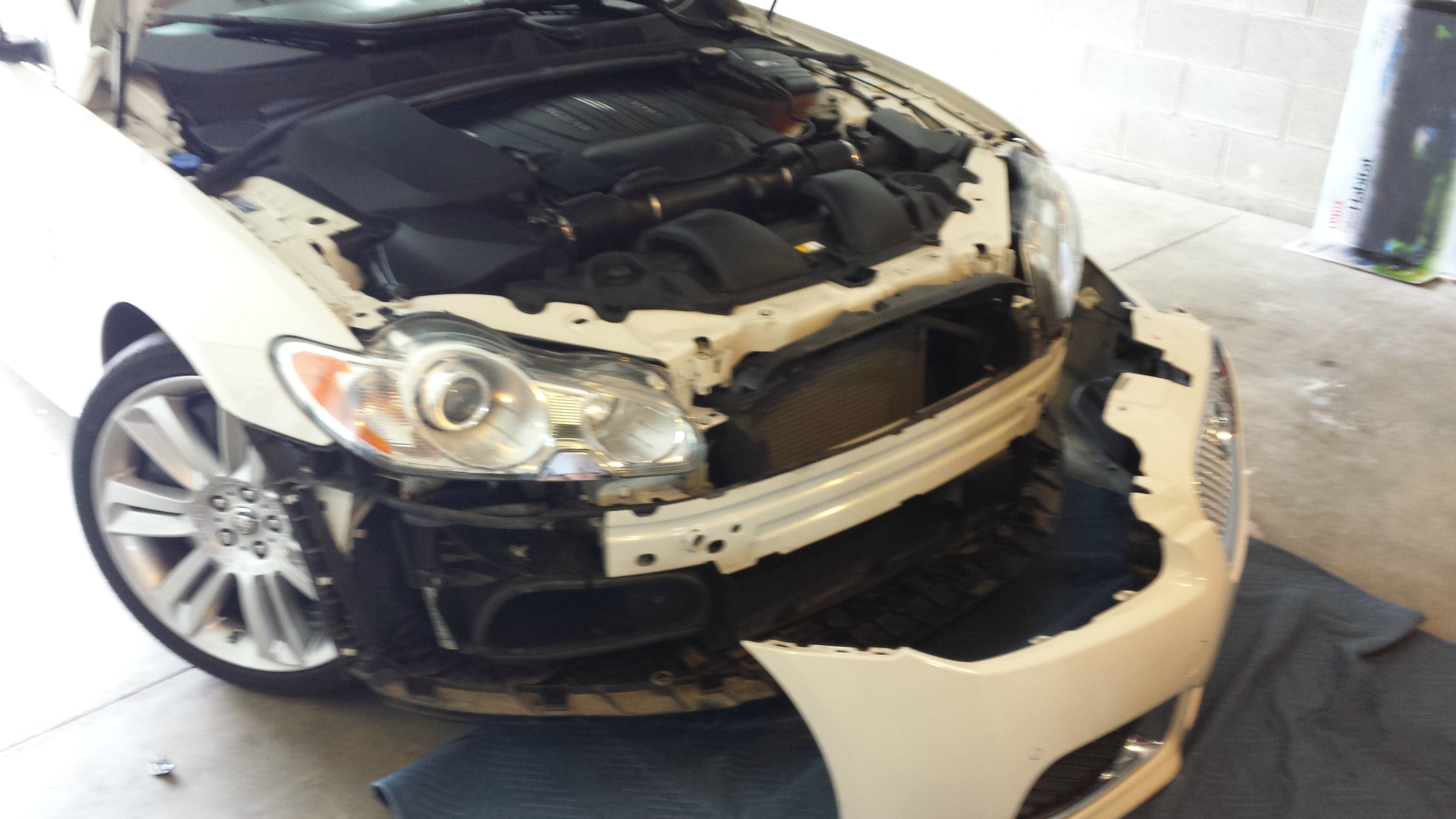

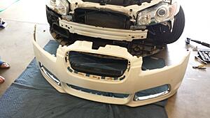

1. Remove a dozen or so screws from the bottom lip. These will be visible as well as recessed. You will also need to turn the wheels completely to the left – or – right to
access three more screws in each wheel well. There will also be 2 screws and one plastic Philips clip above the grille, under the hood.
2. Now you are *almost* ready to remove your bumper. There are three bolts connecting a brace on the driver’s side. Removing this brace will make it much easier to disconnect the proximity sensor connection.
You will notice that the connector which belongs to the sensors is closer to the wheel & the connector which goes to the car is closer to the bumper. While the two are
connected, you can slide this connector off of its mount by sliding it towards the wheel or pulling down. I pulled mine down and it reconnected just fine. You will also have to disconnect the wire from a plastic brace for additional slack. This will give you some additional slack. I’d recommend having a friend around to hold the bumper as you pull it off. Knowing the proximity sensor is on the driver’s side (USA) I removed the bumper starting with the passenger side first. A light tug is all it took to free the bumper from the car. Do not rotate the bumper as much as shown until both sides are free as pictured.
There will be very little slack for the proximity sensor harness. Once I freed these connectors from the harness connected to the car, there was much more slack. Here is what holds the connectors to the car:
And the connector:

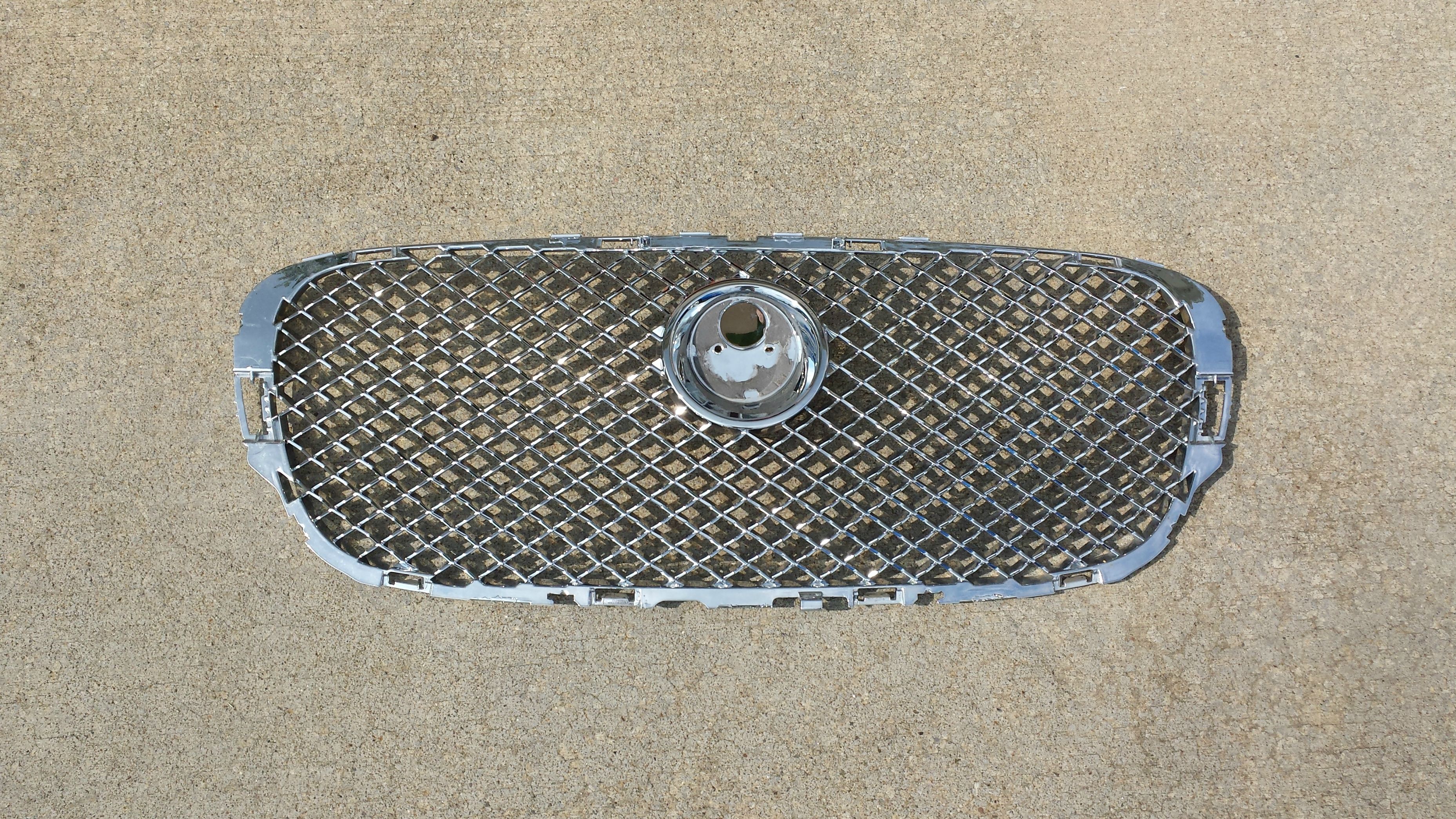

3. If you wish to remove the 3 bottom grilles, there will be six screws for each of the side grilles & some clips for the center grille. I removed these so I could paint them
the same gloss black as the upper grille.
4. The upper grille will require the removal of the foam piece in the bumper as well as two screws and some clips. I then separated the chrome ring from the upper grille. To do this, I had to cut small plastic pieces from under the clips that were blocking the two from separating. The chrome ring is still very snug & the assembly is held together by the 2 screws removed earlier. All of the clips have remained clipped without the small amount of plastic I removed to separate the two.
I removed the Growler with a small flat head. I used a cloth to guard the outer ring in the upper grille so I could use it for leverage with the flat head screwdriver. No
damage resulted.

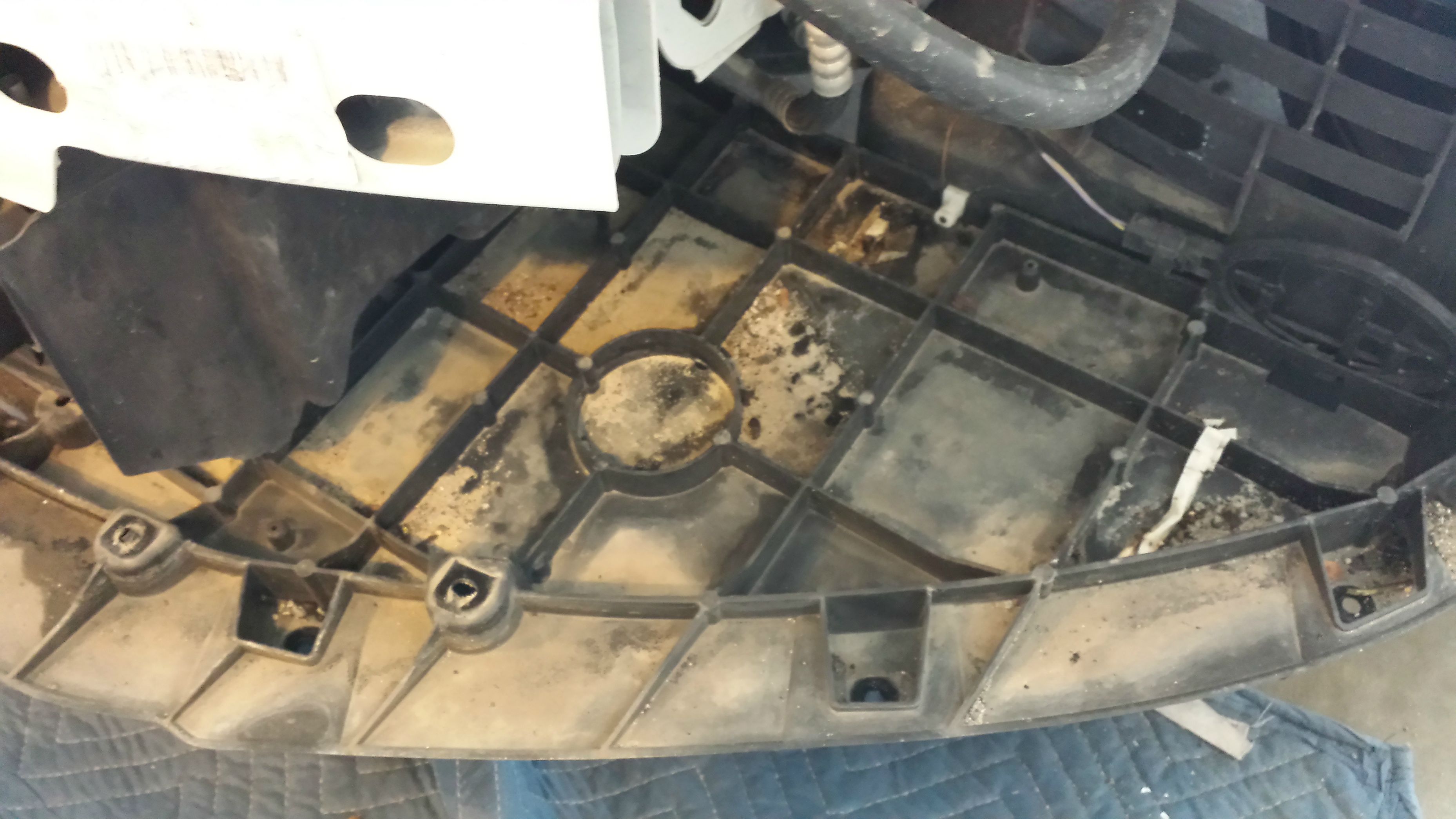

5. This is a great opportunity to clean up what your scrape guard has collected as what has accumulated in the passenger side (USA) lower grille.
6. Next, wash your grilles thoroughly if you wish to paint! I used a scrub brush to get into all the crevasses and let them dry in the sun. I gave 2 or 3 additional passes
with an air compressor at low PSI as water likes to hide anywhere it can. Be sure to get all angles for an even finish.

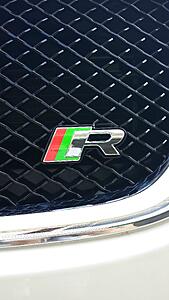

7. The R Badge is more or less self-explanatory. The brace goes behind the grille, the mount goes in front & the screw holds them together. As mentioned, the Jag screw I was given did *NOT* fit and was damaging the mount when threaded. I’d recommend putting the badge assembly together prior to attempting install. I used a screw I had on hand. I may have been given an incorrect part.
8. Put it all back together! I removed the dried paint from behind the growler to ensure good adhesion from the 3M double sided tape I used to replace the Jaguar double sided tape. I picked this up at AutoZone & have used it for many other applications in the past. It is strong and will not let you down. The tape appears red due to the backing.

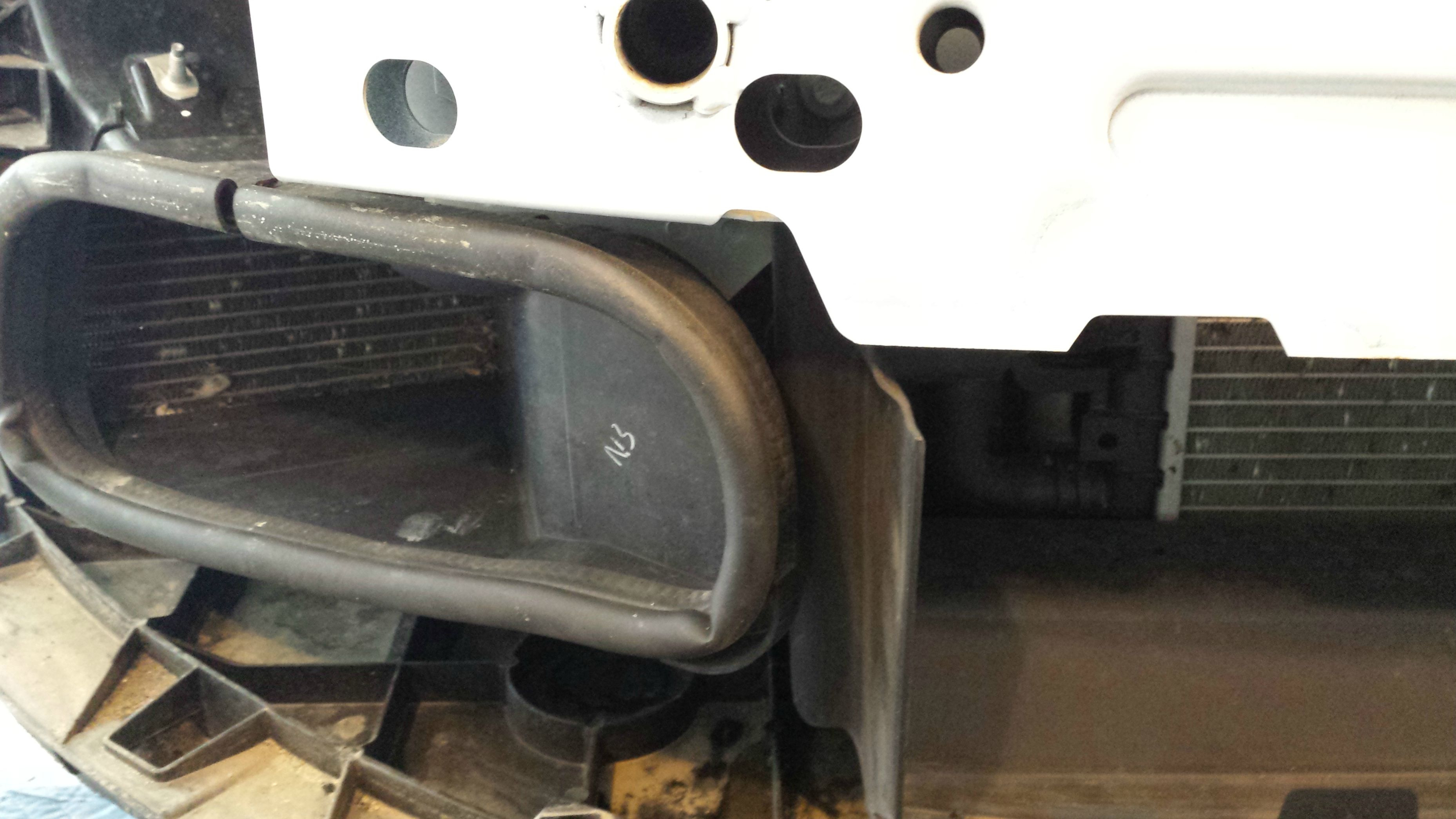

9. Be sure the duct for the passenger side lower intake is aligned with the bumper. Please see last picture.
Before:
After:
