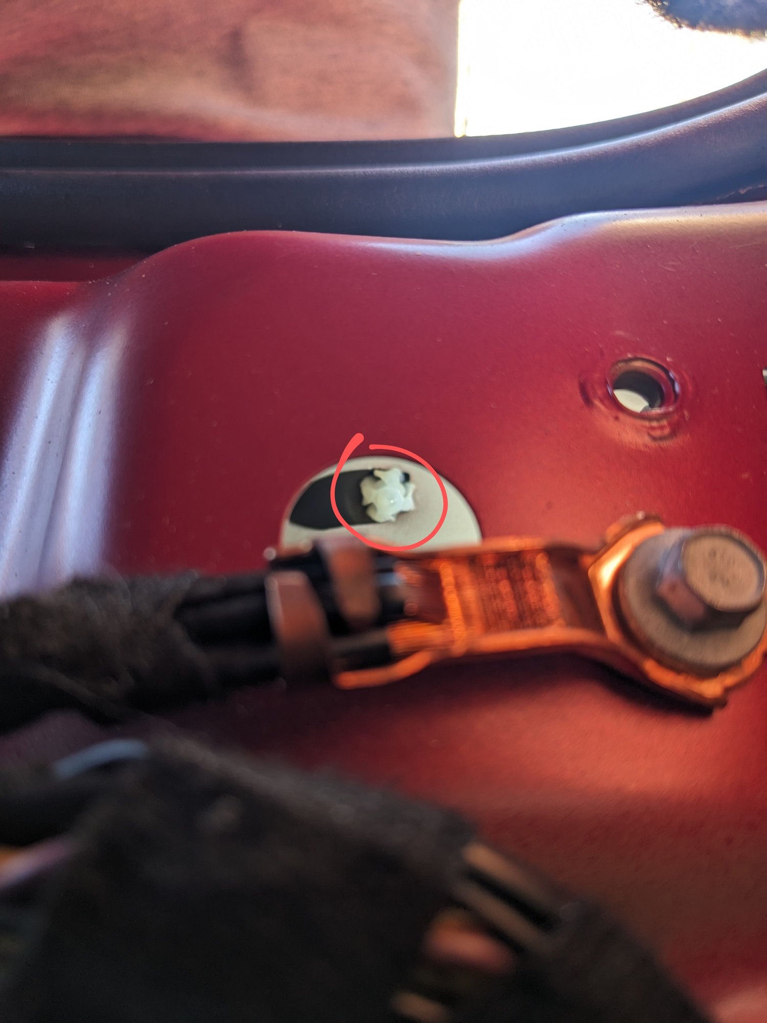

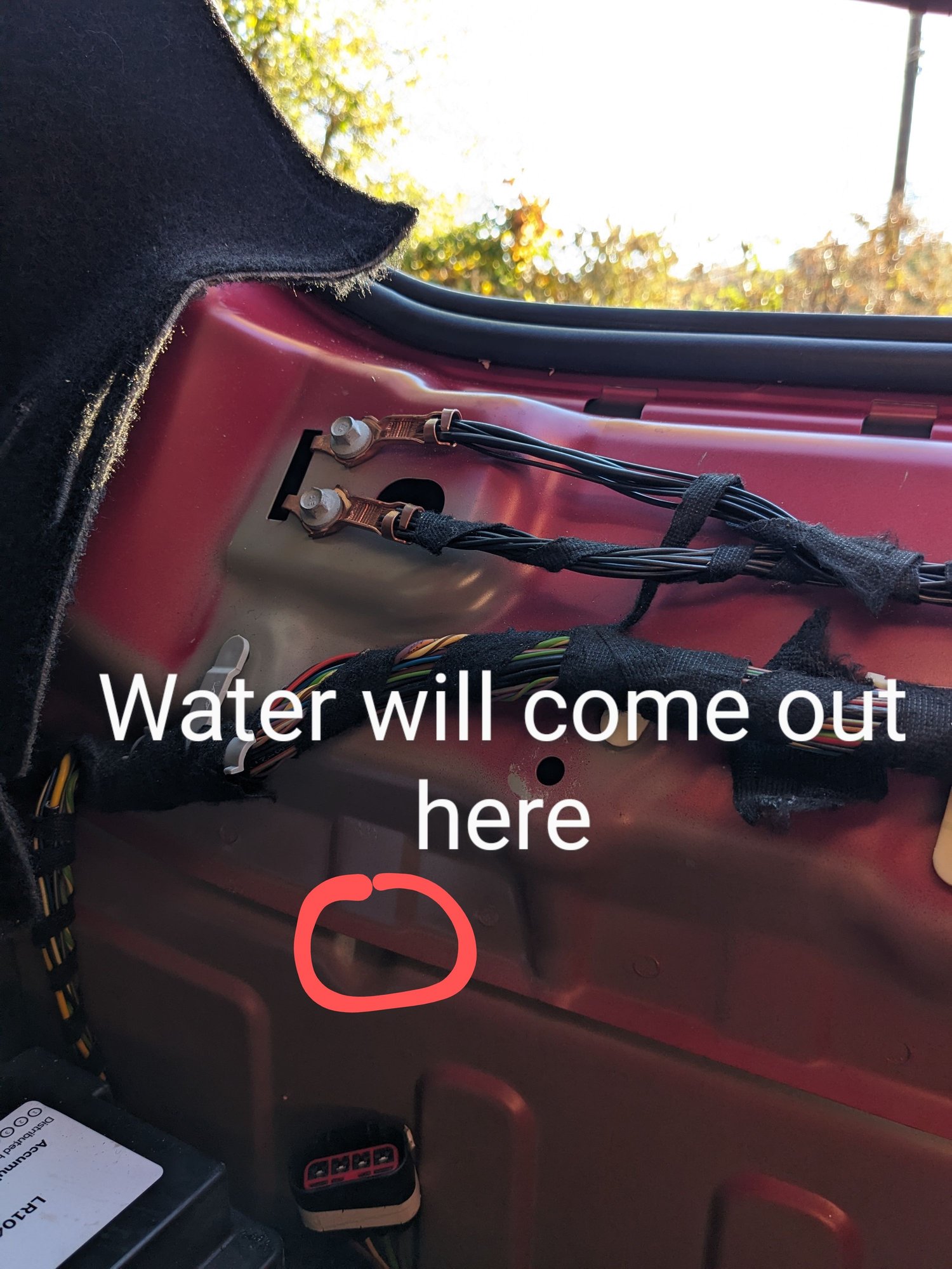

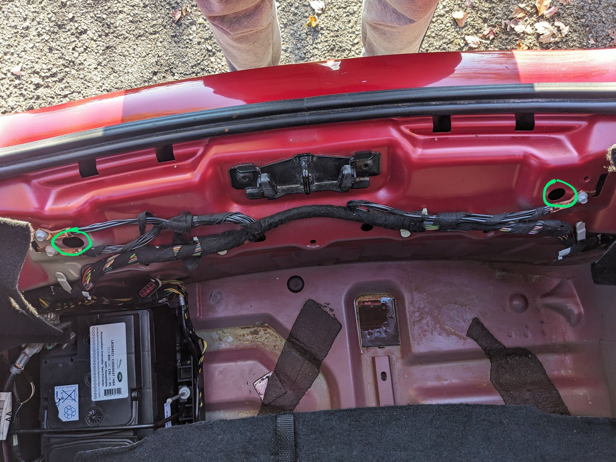

I had this problem and I think I found where it's coming from. I sprayed the back of my car for a while then looked to see water coming through one of these white clips. I'll try silicone it to fix. (I assume it should be sealed from the other side but I'm not taking the bumper off lol) Here are some pics. Hope it helps.

Are you sure your tail light seals are not leaking? Looks to be the right area?
