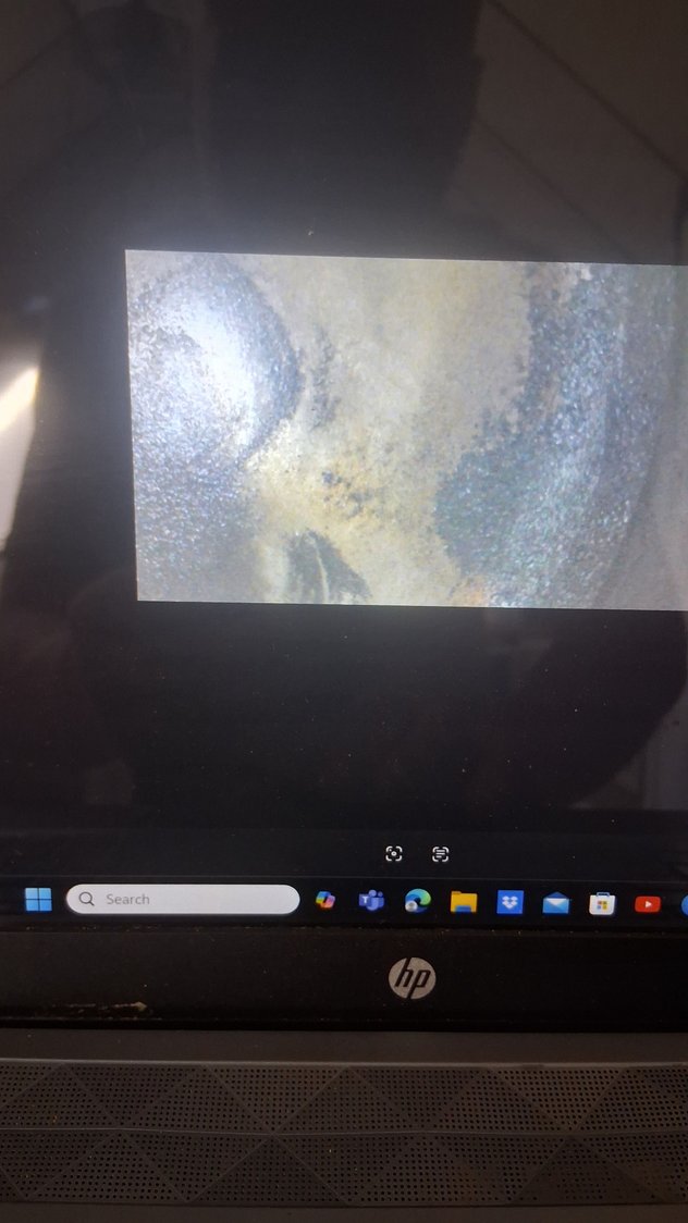

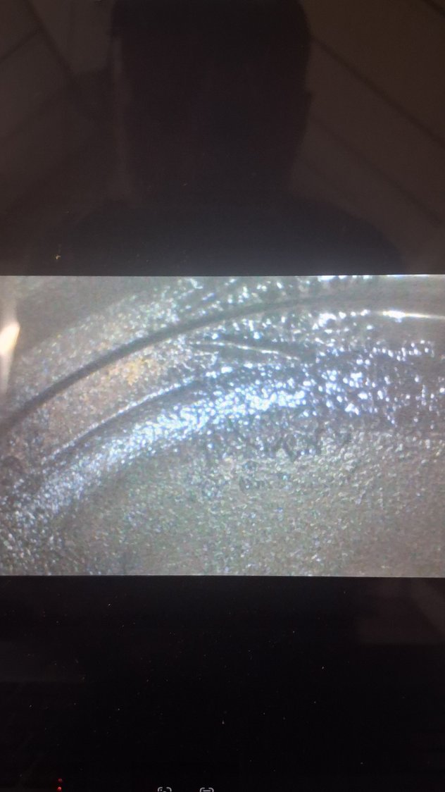

Ive got a 2010 xfr 5.0 sc....had a box-o-rocks rattling sound coming from engine bay. Seemed to be in rhythm with the serpentine belt movement, so I assumed that maybe that sound was just echoing through engine , as I was inspecting with my stethoscope. Well, shortly later , there's a misfire on cylinder 6. Change plug, change coil. Missing on 6. Reduced engine performance. From what i've gathered these superchargers , have a high failure rate and will give you the box of rocks sound with misfires. Logically , i'm not thinking that that would give me a consistent misfire only on one cylinder , though??? Borescope cylinder 6 and it's very clean as if it's been washed with fuel and not firing , it is wet and one small corner of it cylinder with what appears to be a foreign object....have attached photos. Is this maybe a needle bearing from the rear of the sc???

No the SC is very reliable. Not many problems at all. The biggest one is the snout noise but that causes no problems besides the noise. If you wish to check remove the SC belt and start the engine. That will tell you real quick.
Best to post what codes the car has. Maybe an injector replacement but that's a guess.
If that is a bearing from the SC inside a cylinder your engine would be locked up in a smoking pile of ruined metal! Forget that theory.

Yes, that’s almost certainly a needle bearing from the supercharger coupler or rear drive. Common failure on the 5.0 SC. The rocks-in-a-can noise is the bearing cage breaking up, and those needles can get sucked into cylinder 6 because of intake runner length and air flow patterns. Wet cylinder and one clean spot matches fuel wash and a foreign object bouncing. Stop driving it or you’ll hole a piston. Time for supercharger rebuild or replacement plus intake cleaning.
