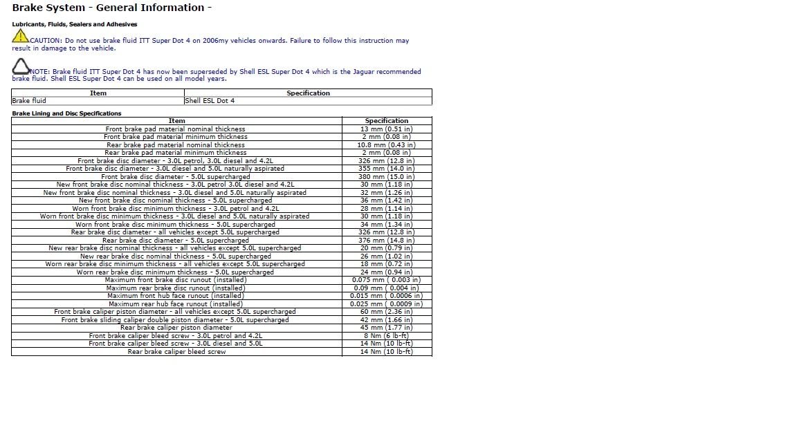

In response to your PM about brake rotor thicknesses, see this:

I ordered new rotors and used my caliper to measure them but I am not sure if the numbers on the screen are right. However, the numbers on the ruler part of the caliper looks to be 32 mm. Can someone confirm if this is correct rotor for my front XF?
That is the exact same gauge that I use and I have found it to be accurate as long as it has been "zeroed" properly before measuring.
So the first thing to do is check that you have zeroed it properly.
The second thing to do is to simply grab a ruler and measure the thickness that way. It may not give you a precise thickness but it will at least show if the rotor is in the ballpark of 32 mm.
