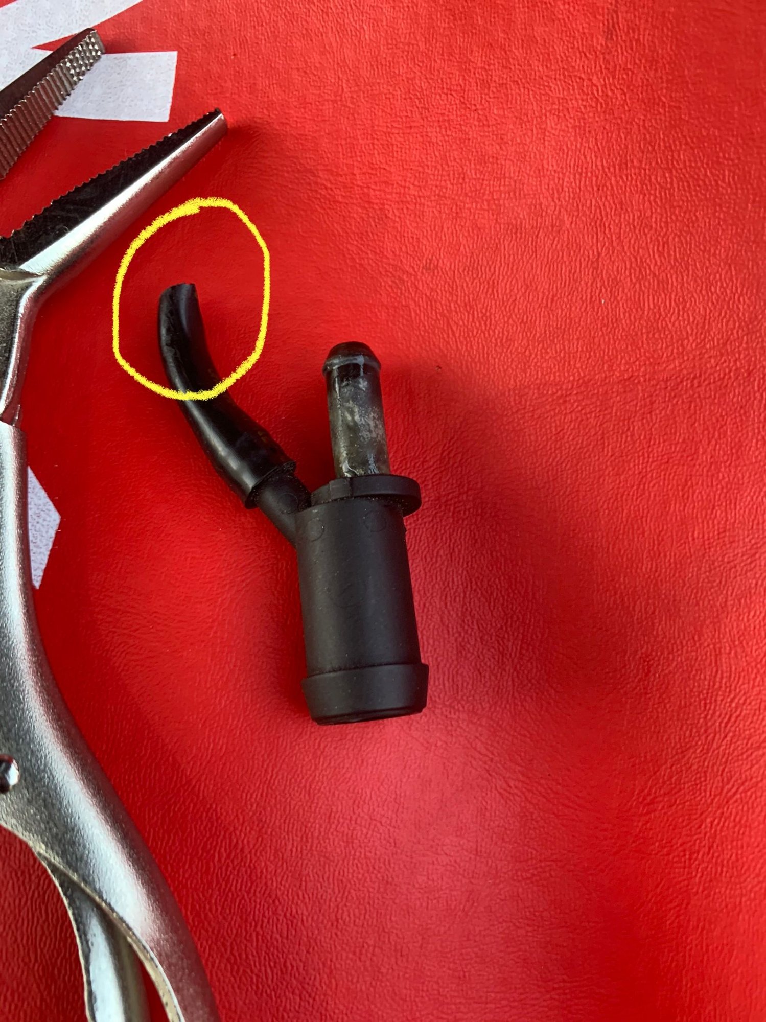

I was working on replacing the supercharger coupler and when I was removing the throttle body. I broke one of the hard lines/tubes. It must have fallen on to the shield below because I could not find it. Anyone know what options I have or do I need to get it at the dealer?

Hi, the same happend to me. Mine broke on a different location, but same problem, brittle plastic, almost impossible to fix. Tried to fix it, did not think it would last long and so I ended up replacing it. There is an updated version available, part number C2Z26930. One leg of that tube is sealed and does not connect anywhere. Instead the bleeder from the water pump connects now straight into the main cooler hose (C2Z28258) so you need to replace that as well. Both parts should fit your car, but better check with the dealer first.

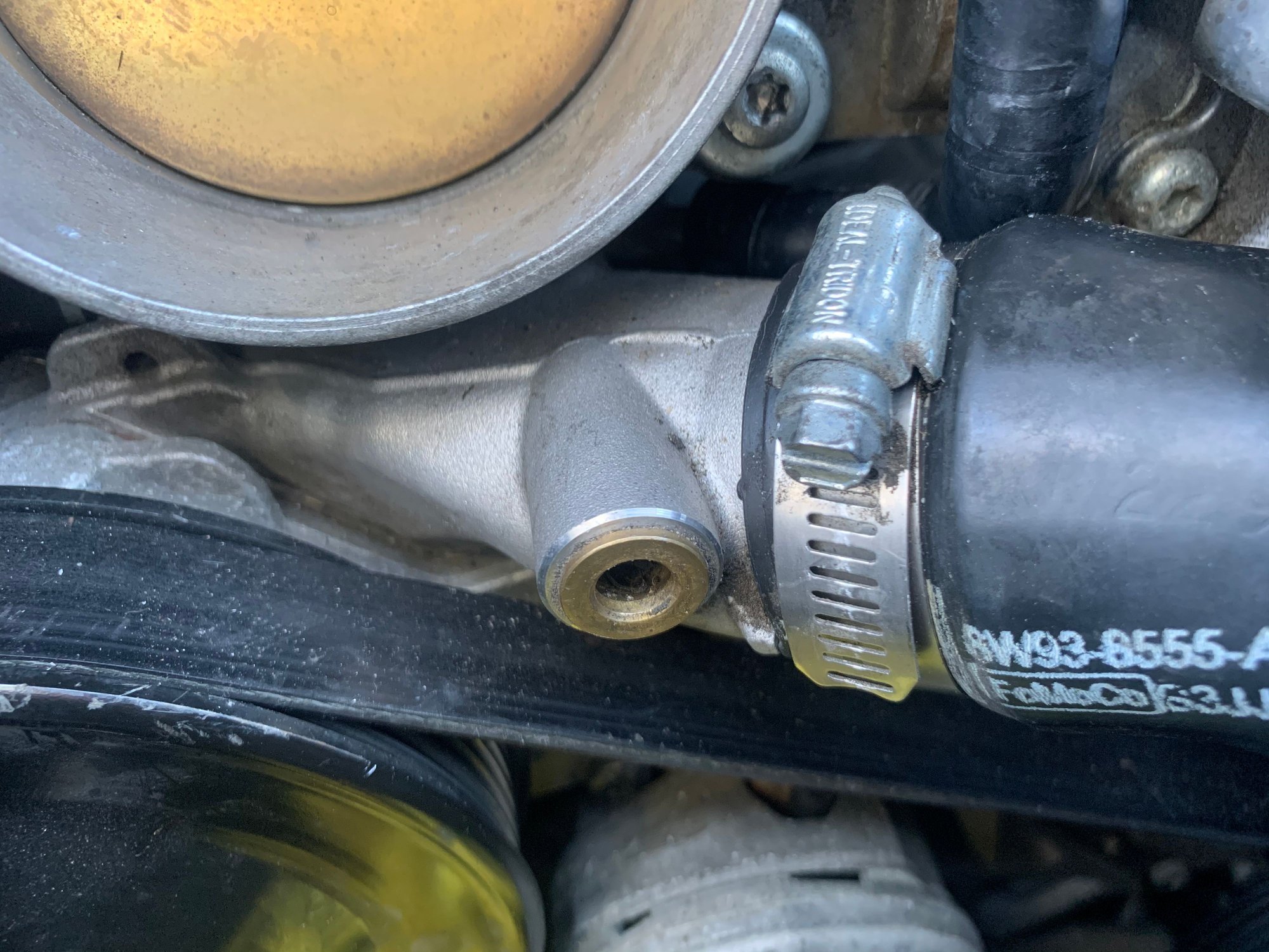

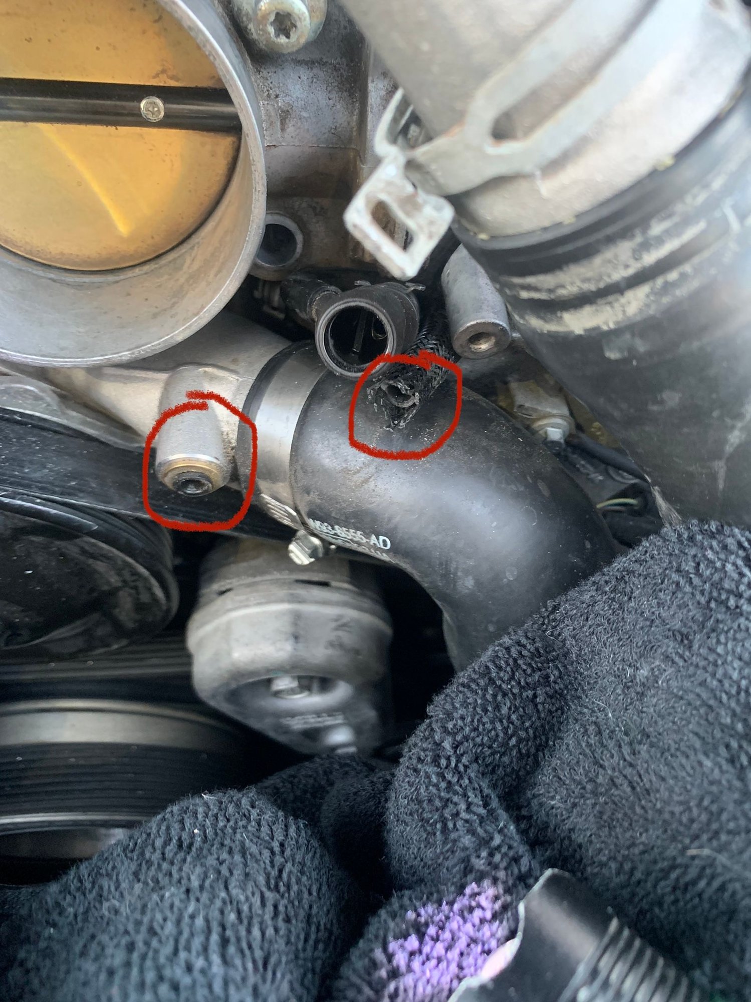

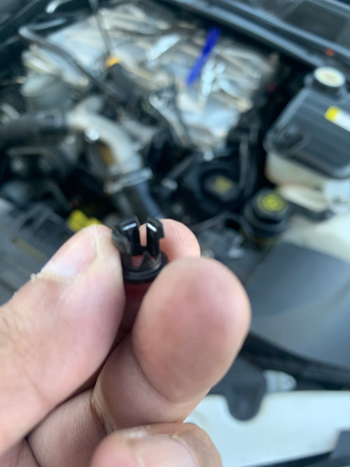

Just an update. I was finally able to put in the new parts after getting the wrong parts. I ran into one problem. There was still part of the old elbow left over inside of the hole. As I tried to remove it I broke the plastic ring that the elbow pushes into. Any chance I can get a replacement? Is there a way I can pull it from an old water pump? (Maybe someone has one).

Just to update the thread, I was replaced the o-ring inside with a slightly thicker one and I was able to reuse the black plastic ring even with 3 feet. Seems to be holding the coolant so far. No leaks but I’ll keep an eye on it.
