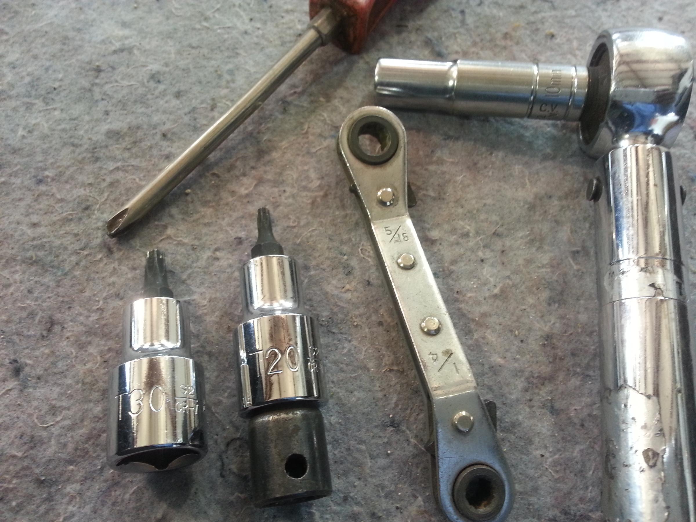

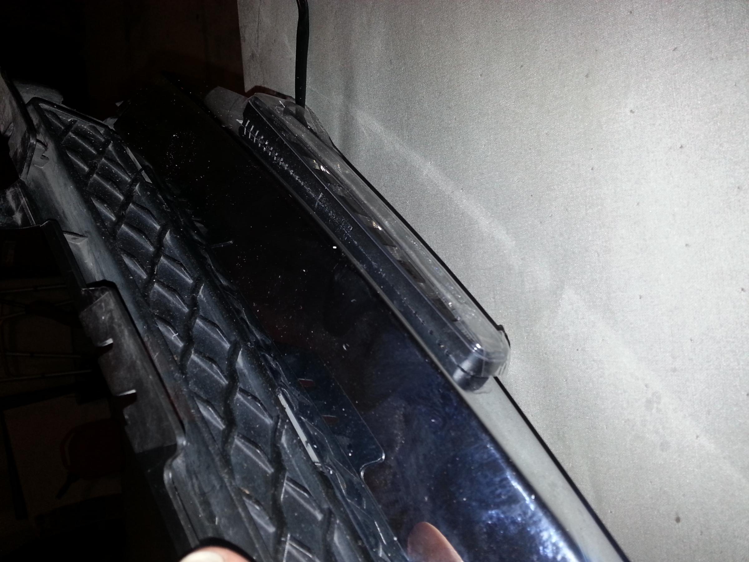

Great news NA owners! I was able to get to the chrome blades by removing only the under panel and not the entire bumper. All it took was putting the car on a couple jack stands, ratchet, couple star sockets (T20 & T30), 10mm socket, 5/16 ratchet wrench and a phillips head screwdriver to realign any of the clips that might shift when you put the panel back on.
Once the panel is removed the pieces come apart from the bumper clips with a little force. Upon taking measurements the Philips DRL8s will fit. The chrome piece backs directly up to the mesh but the form of the mesh is open so the ~1.25" depth needed is definitely there. (Pics below). It looks like I'm going to pull them and cut the mesh portion myself but will send the chrome piece to the plastic co to be cut to make sure the edges are clean and if not make them responsible for replacing them.

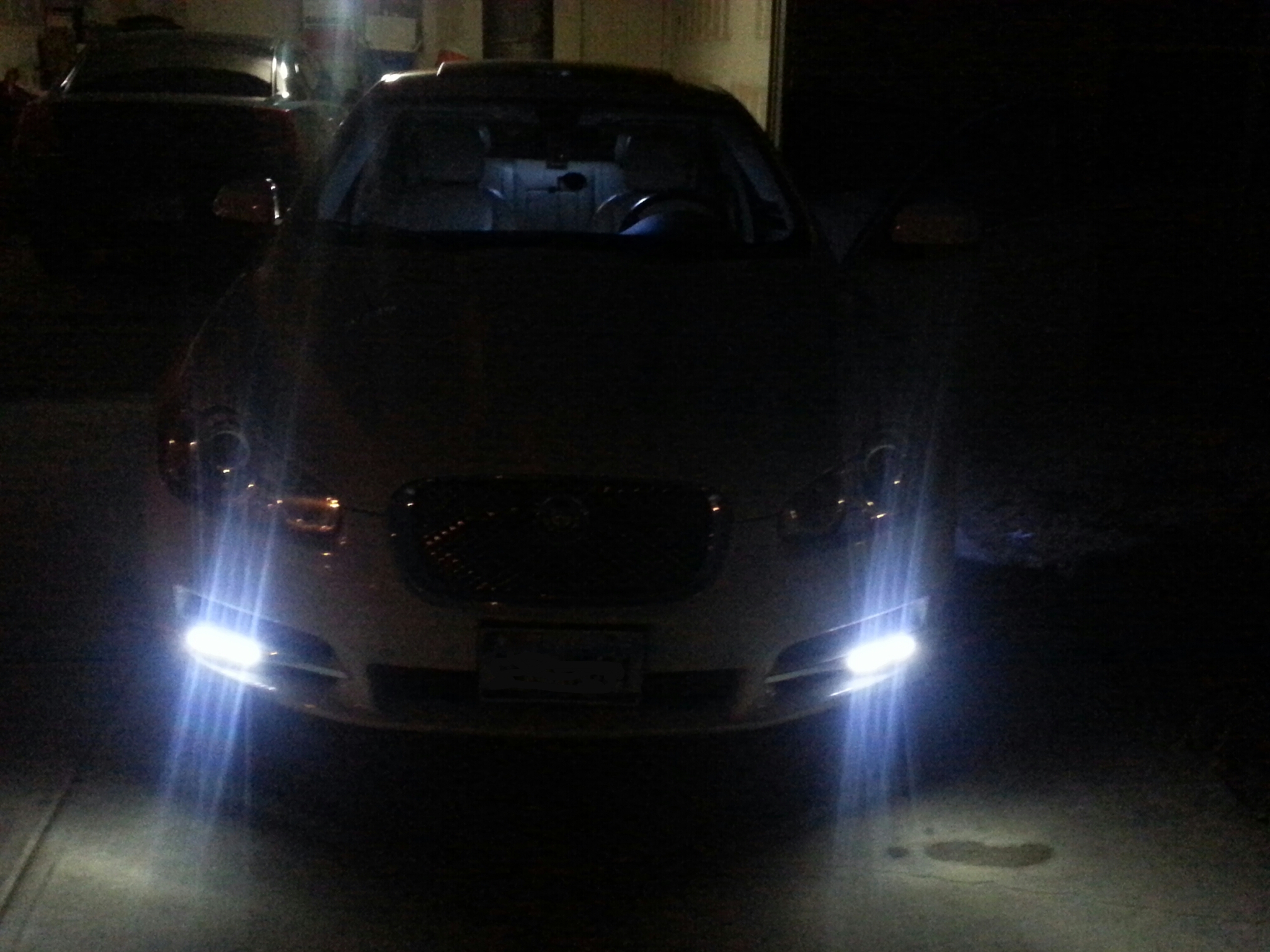

So I set out on this project yesterday and 12 hrs later, a few brakes in between (to eat and watch NBA All Star festivities) and I finally got the Philips DRL 8s installed into my chrome bumper blades. The majority of my time was spent with a rotary tool in my hand cutting the openings in both the black faux mesh and the chrome blade. After cutting the faux mesh and measuring to cut the blades there was a brief moment when I second guessed my decision but once I began cutting the blade there was no turning back. Due to the cuts and the way the faux mesh is contoured the clips that the leds fasten into don't make a flush connection so we had to make a modification in order to screw the clip into the plastic. I initially cut them so that the lip on the lights would creating a "stopping point" so the blades couldn't be pushed into the opening but after the initial cuts and test fit the blades stuck out too much so I had to do some trimming to recess them more. The cuts came out pretty good and rather clean however due to the shape of the blade (not flat) there was quite a bit of eyeing that had to be made to create straight lines and "exact" dimensions. Because of the eyeing there was a bit of over cutting on the 2nd blade. I plan on taking some chrome wrap and rewrapping the blades to close the small gaps. Here are the few pics I took at breaking points, I would've taken more but I was focused on getting this job done. I will post more pics when I install them back on the vehicle and get them all wired up after church.

The finished product

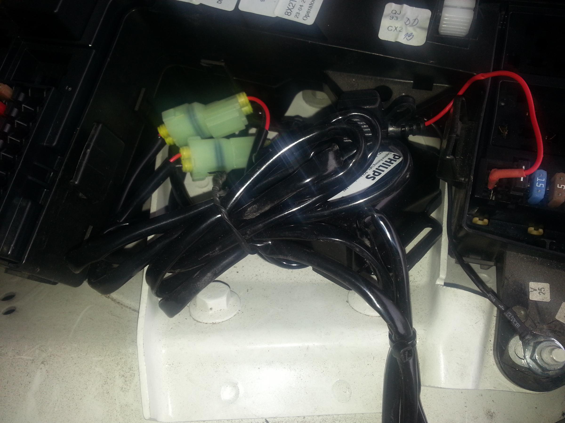

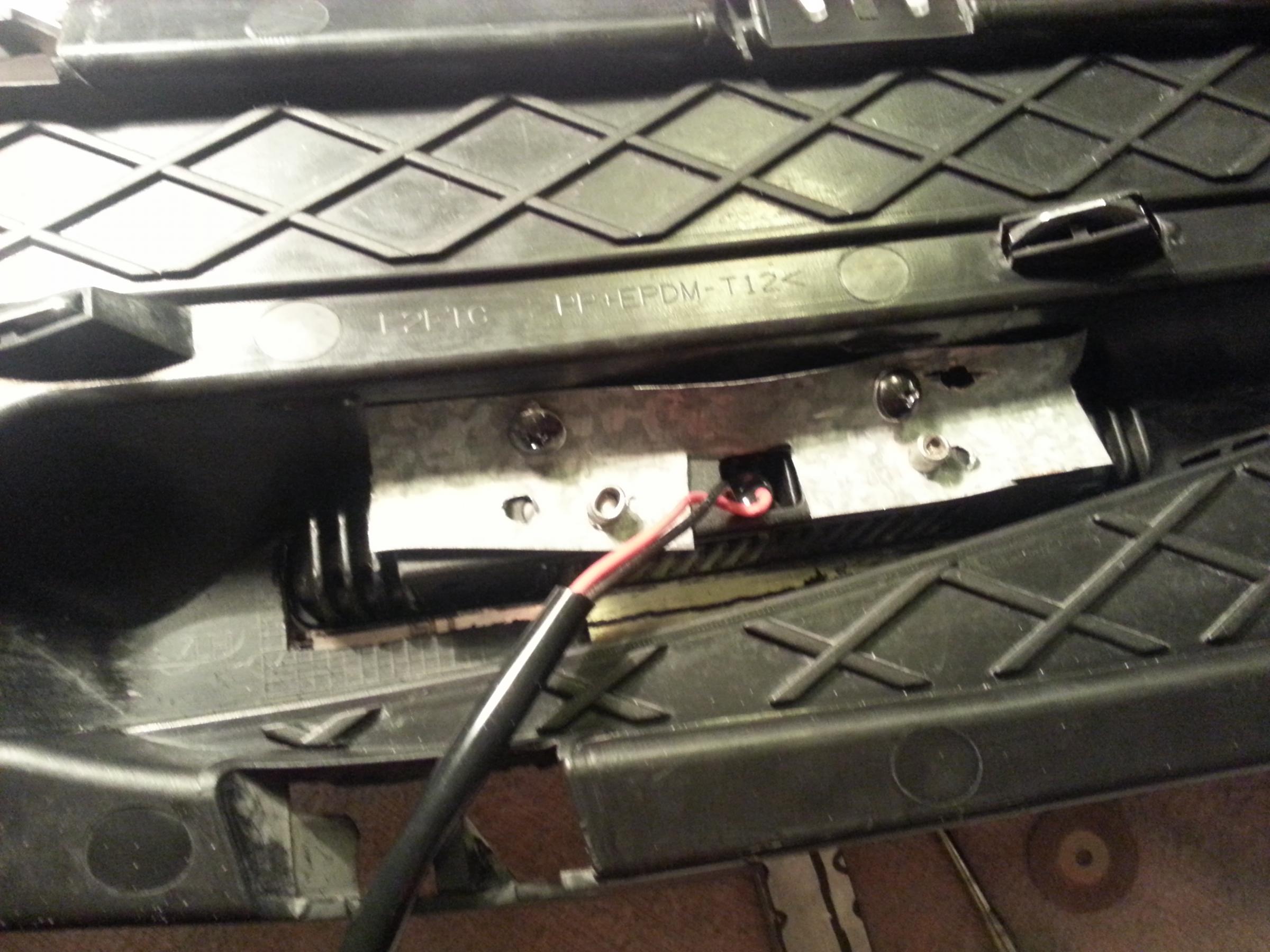

The amount of work it took to do these, I'm not sure I would do it again...lol. I might consider it for the right amount of money but as for the electrics, there's a spare ignition switched fuse in the fuse box. There's also a bolt post right outside the fuse box that I grounded it too. Then just as in the instructions I used a one touch connector and connected the switch to the parking lights so the leds are bright when on alone and dim when the lights are switched on. I will post a pic of the wiring shortly.
I will say that I saved about $350 doing this mod myself based on the ones being offered on eBay from China, which after doing this I don't believe the eBay ones will just swap out like the ones previously offered by Adamesh. The China ones from what I can tell would require modifying the faux mesh also, again just based on what I can gather from their pics and performing this mod.

BritCars, Here is how I wired them. Sorry took so long to get the pix up. For some reason I couldnt upload from my phone yesterday.

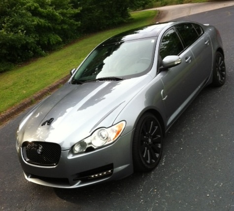

philhef's Avatar
Posts: 2,916
Likes: 547
From: North Carolina
Originally Posted by ttboonie
Rod,
I can't speak on the Chinese version of these lights, but I have the ones that were produced by a UK company fitted to my 09 SC. Bumper removal was required because on the SC there is functioning ductwork attached to the blade grills. Miamijag could be correct about only having to remove the bottom pan. It's been awhile so my memory escapes me. The ones I purchased a few years ago were almost twice the cost of the ones on ebay and they are made with Philips led bulbs. Vestatec Automotive Engineering - Vestatec Group
I think I have the same. Mine came from adamesh and I think they were about 650.00. We took off front bumper and installed, also switched out the grill for full black.
There was a dealer in UK still selling them with a discount for members.
