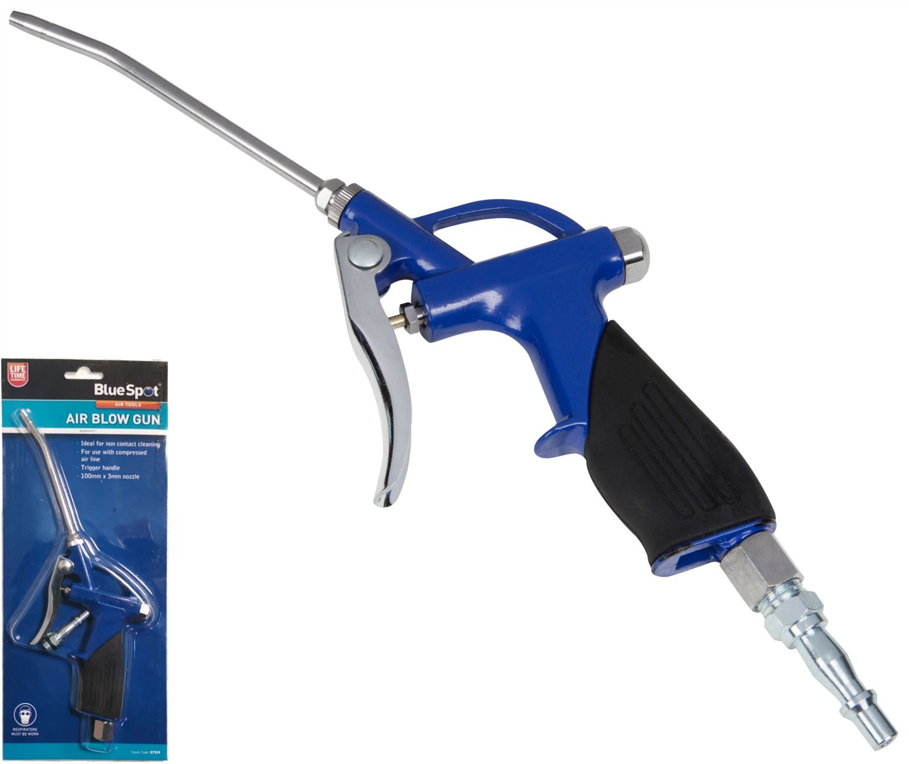

Sorry to hear about the crossover pipe. I also cleaned my intake valves when my crossover pipe failed. I used a few wire tube brushes and some carb cleaner. I was using a blow gun connected to my air compressor to blow out all the gunk that was coming off the valves. I’ll post a couple of photos of the wire brushes and blow gun.

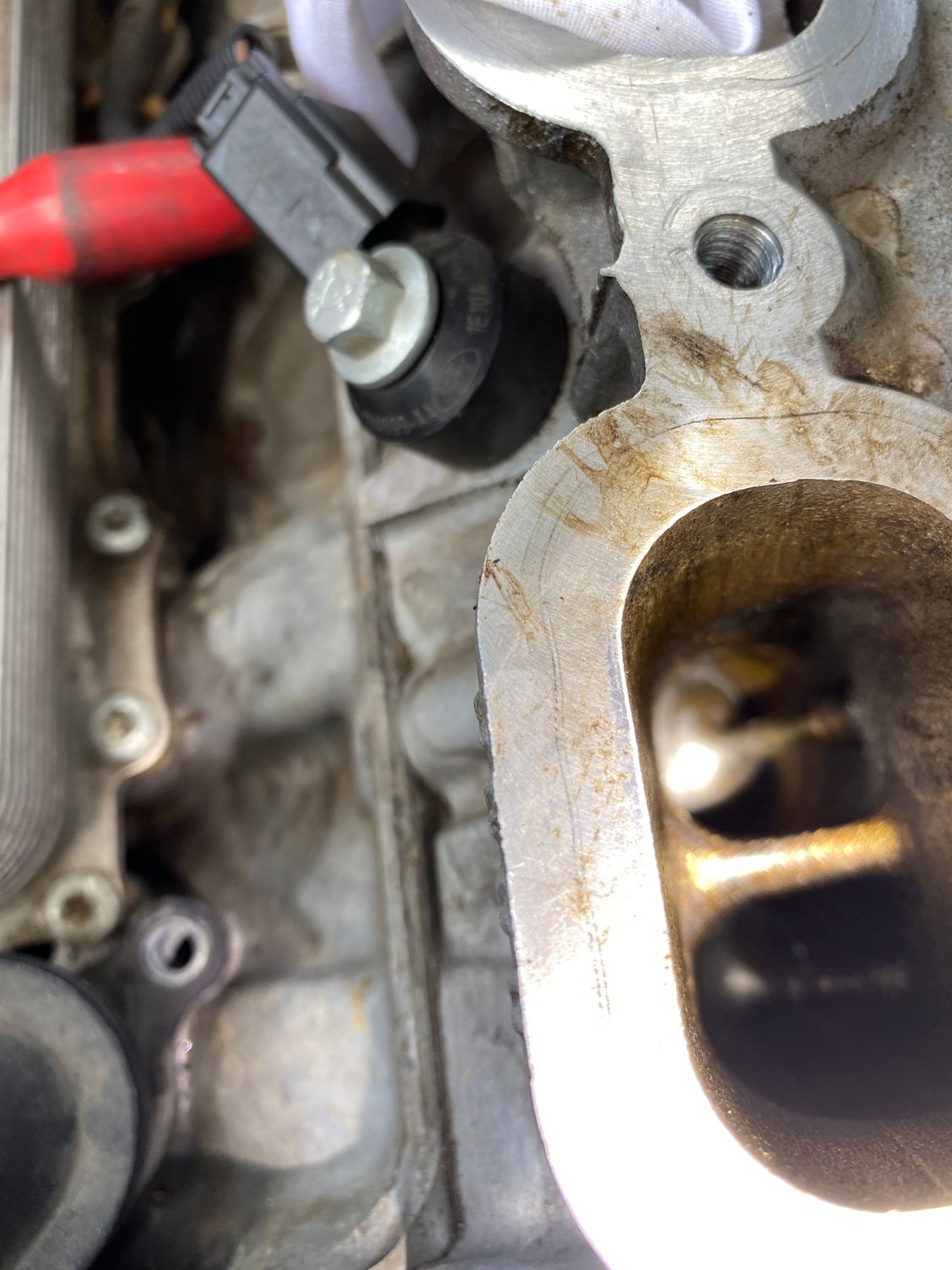

Well, job done. The valves weren't terrible and the gunk comes off fairly easily. I used a dental pick to get behind the valve, a brass bristle brush and a blunted screwdriver. Thanks for the advice swilmer. You're right, my back is killing me, hovering over the top of the motor constantly worried about breaking something.
I didn't try to get the valves spotless, just "good enough".

Nice work! "Good enough" looks perfectly good enough to me and a vast improvement over how mine looked before I cleaned them. Did you get any before pics? What's the mileage on your engine? When I pulled my heads apart the amount of crud on the inlet valves was impressive.

I thought I had a picture, but I can't find one. They really were not bad, I suspect there will be no difference in performance from doing this job, but since the valves are there it may as well be done.
