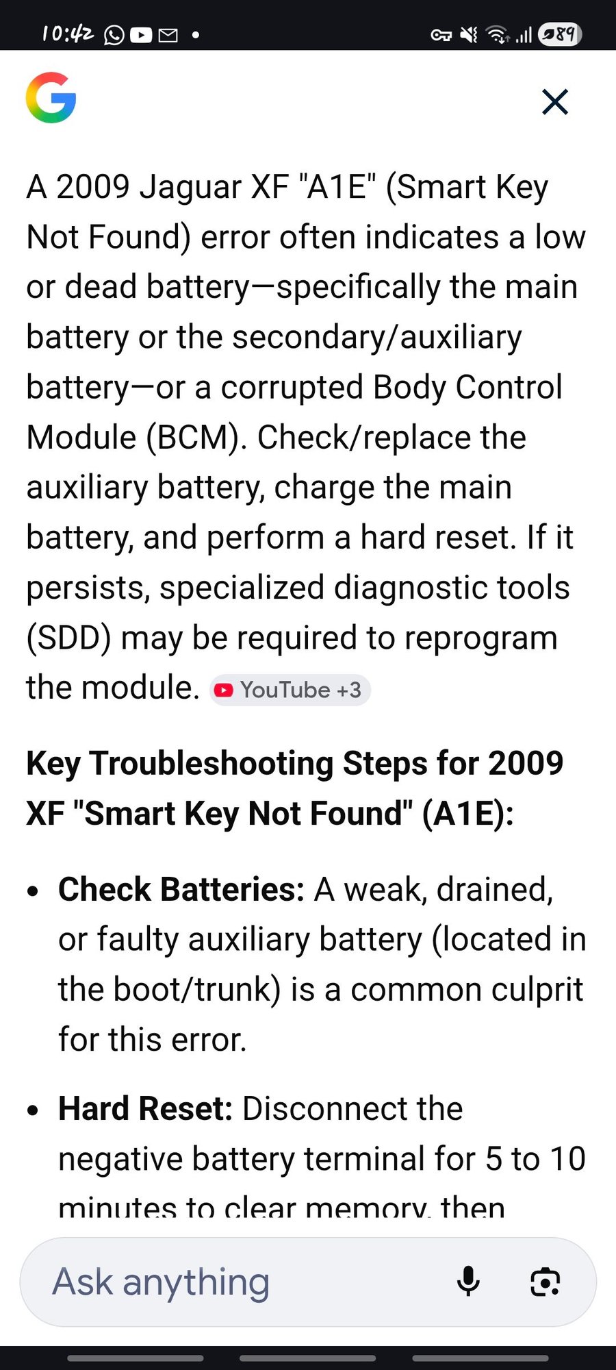

When you google that code it relates to the smart key not found
