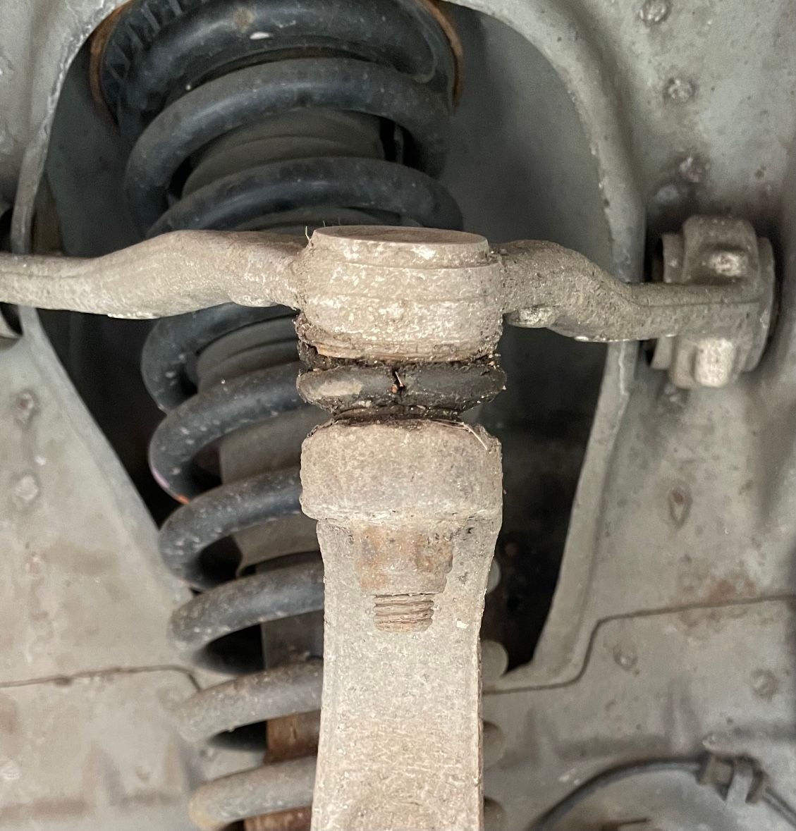

If the ball joint is good underneath on the wishbone control arm can I remove the nut... prize up the control arm...remove the old rubber boot... clean and grease the ball joint... put on new boot cover and circle clip and put the nut back on
Old Mar 13, 2021 | 03:25 PM
Six Rotors's Avatar
Posts: 953
Likes: 293
From: Toronto,Canada
Yes . You need to treat the threads with DW-40 or similar and clean out the hex inside the threaded part ---this allows you to prevent the ball spinning as you undo the nut. Mine separated by themselves. You also need to restrain the upright as you remove the nut.

Old Nov 28, 2021 | 10:02 PM
Sean W's Avatar
Joined: Jun 2013
Posts: 8,946
Likes: 4,747
From: USA
Looks pretty beat up. Once you release the ball joint you'll feel it loos and maybe click so you may have to replace. You have to remove the strut to pull the bolts. They slide inward toward the damper and too log to clear.
