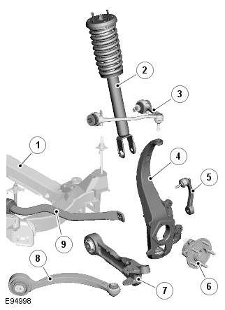

So is this a control arm bushing, or a wheel bearing, 2 completely different things...... from the picture below, #8 this control arm bushing is common to fail, and the bushing in #7 as well. #6 is the actual wheel bearing assembly. You can get the whole arm, or you can get the bushing separate for both #7 and #8. Do you have a copy of the repair order or the piece of paper saying what you need to replace, can you scan it and upload it here?
COMPONENTS
ItemDescription1Subframe
2Spring and damper assembly
3Upper control arm
4Wheel knuckle
5Stabilizer bar link
6Wheel hub and bearing assembly
7Lower lateral control arm
8Lower forward control arm
9Stabilizer bar

yes my mistake it is the control arm bushing not the bearing. I dont have a work form unfortunately, i was getting it aligned by my trusted tire shop and he told me they need replacing. ive also noticed it when driving sounds like somethings knocking when it goes over small bumps or cobble stone.
