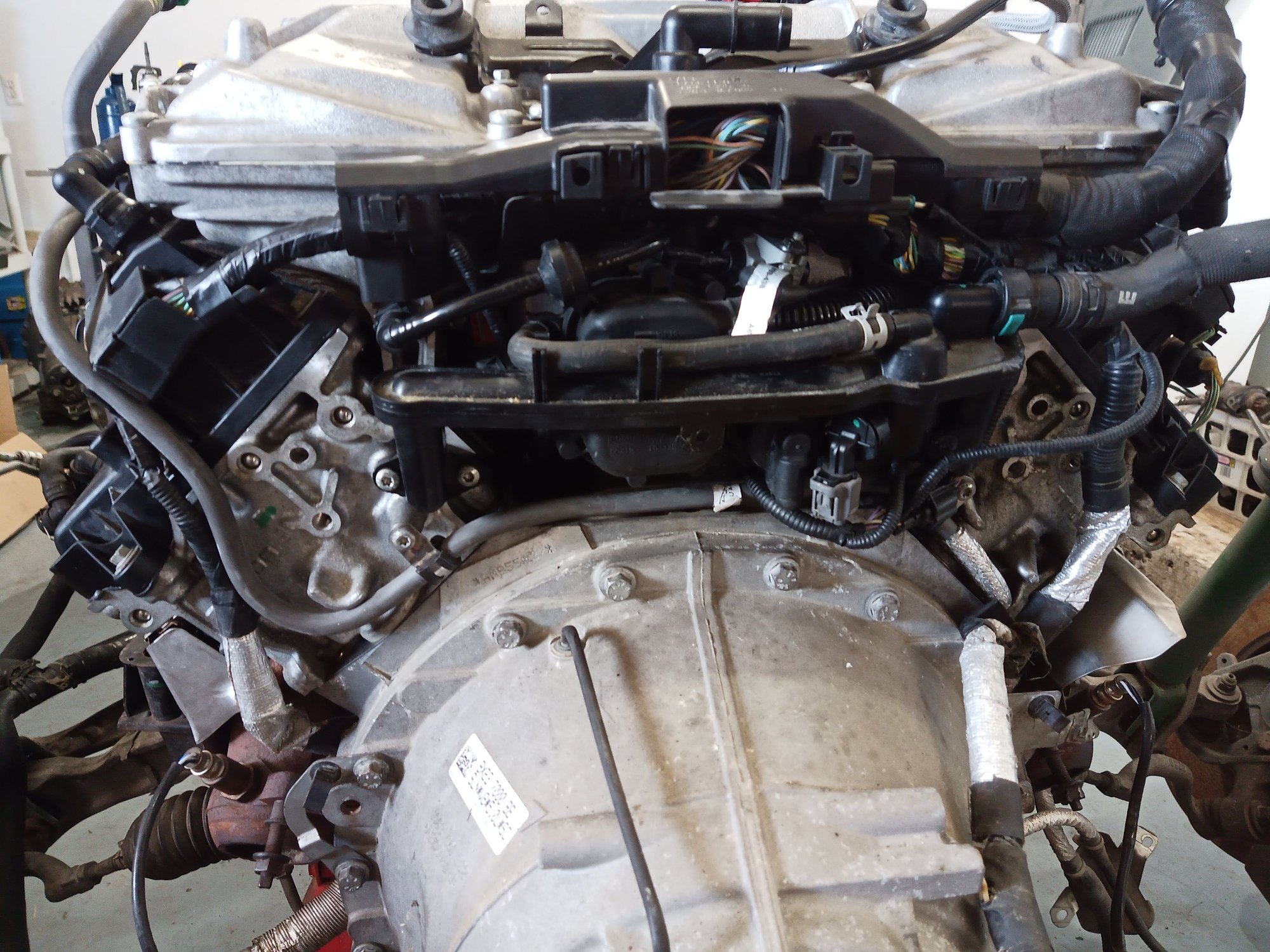

On my XFR the water pump was leaking into the V of the engine from the small plastic pipe that goes backwards from the water pump into the engine oil cooler. It was pretty invisible. New water pump, 2 new O rings for the oil cooler pipe, and an aftermarket aluminium replacement for the plastic pipe to the cooler sorted it out. Be aware though, if you break even the tiniest plastic hose while you're doing it, most of the plumbing on the front of the engine has been redesigned and to replace broken bits you may have to move to the new plumbing layout which requires a few more parts!
I would expect the coolant bridge at the back of the engine though as the others have said - you'll see drips from this on the gearbox bellhousing and down the back of the engine if you take the undertrays off.
