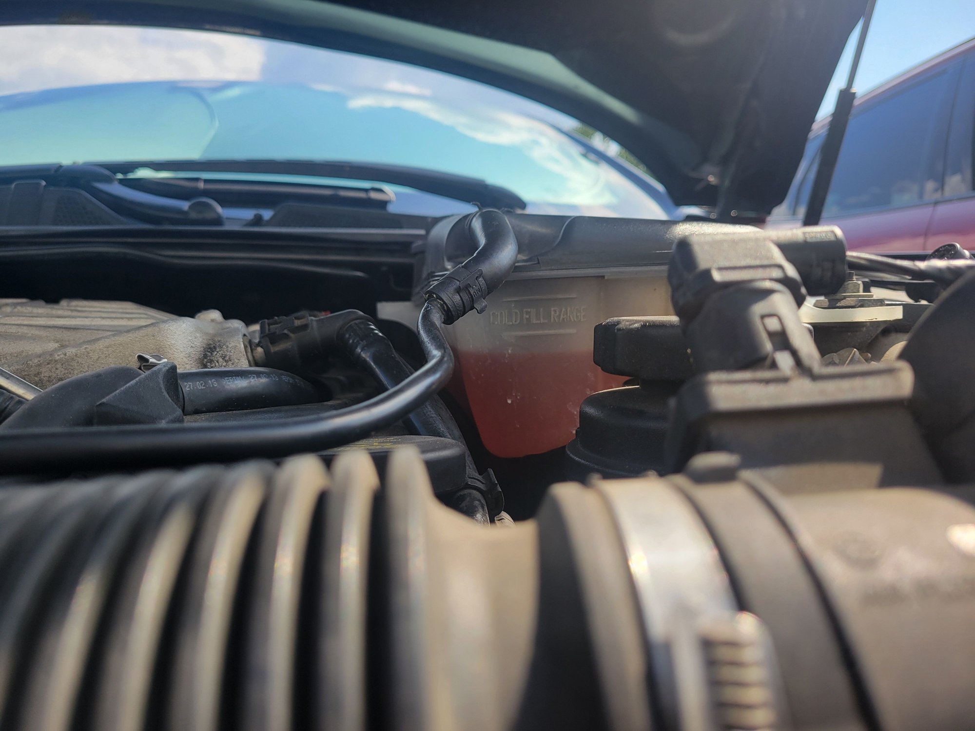

I took this in to the same shop on 08/07/2025 and they checked for any leaks using a “camera on a stick” (I don’t know what this is called). They said they didn’t see any leaks, especially since this pink substance leaves a sticky crystalline residue. They said they checked for an air bubble too but that wasn’t the case either. We decided to check this out for another week, take pictures and then come back to it. I’m listing the levels checked with the dates below. I’m also attaching pictures (dates and times are in the names and listed underneath them as well) for these:
08/11/2025
Didn’t drive car after getting it back from the shop. Checked level at 8:30pm before moving car a few feet as I had to mow.
08/12/2025

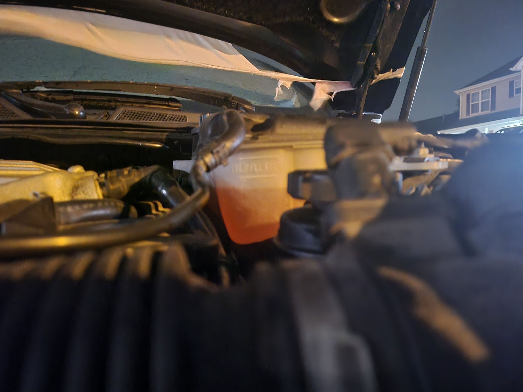

Checked level around 8:30pm again. Looks to be at the same level.

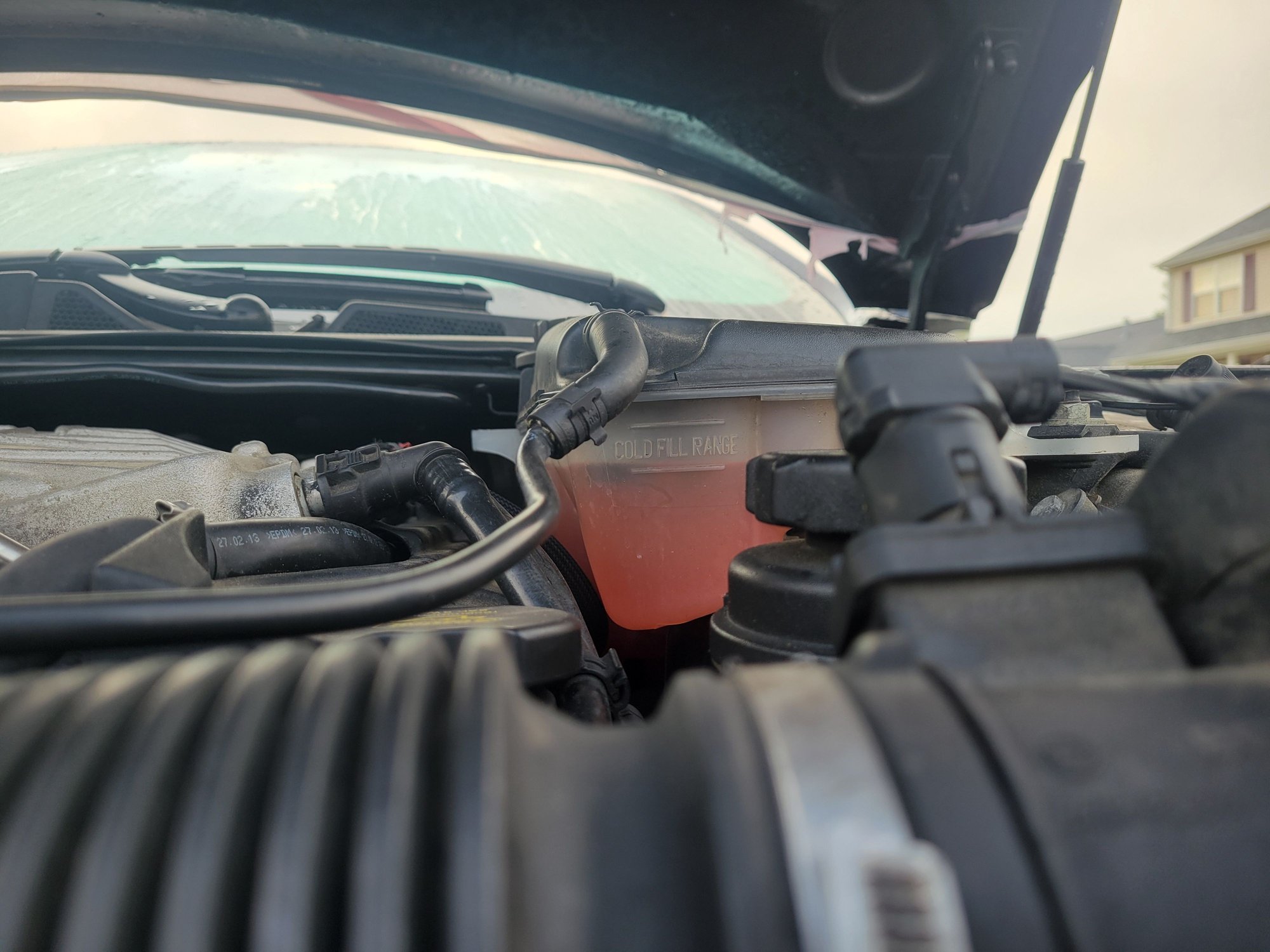

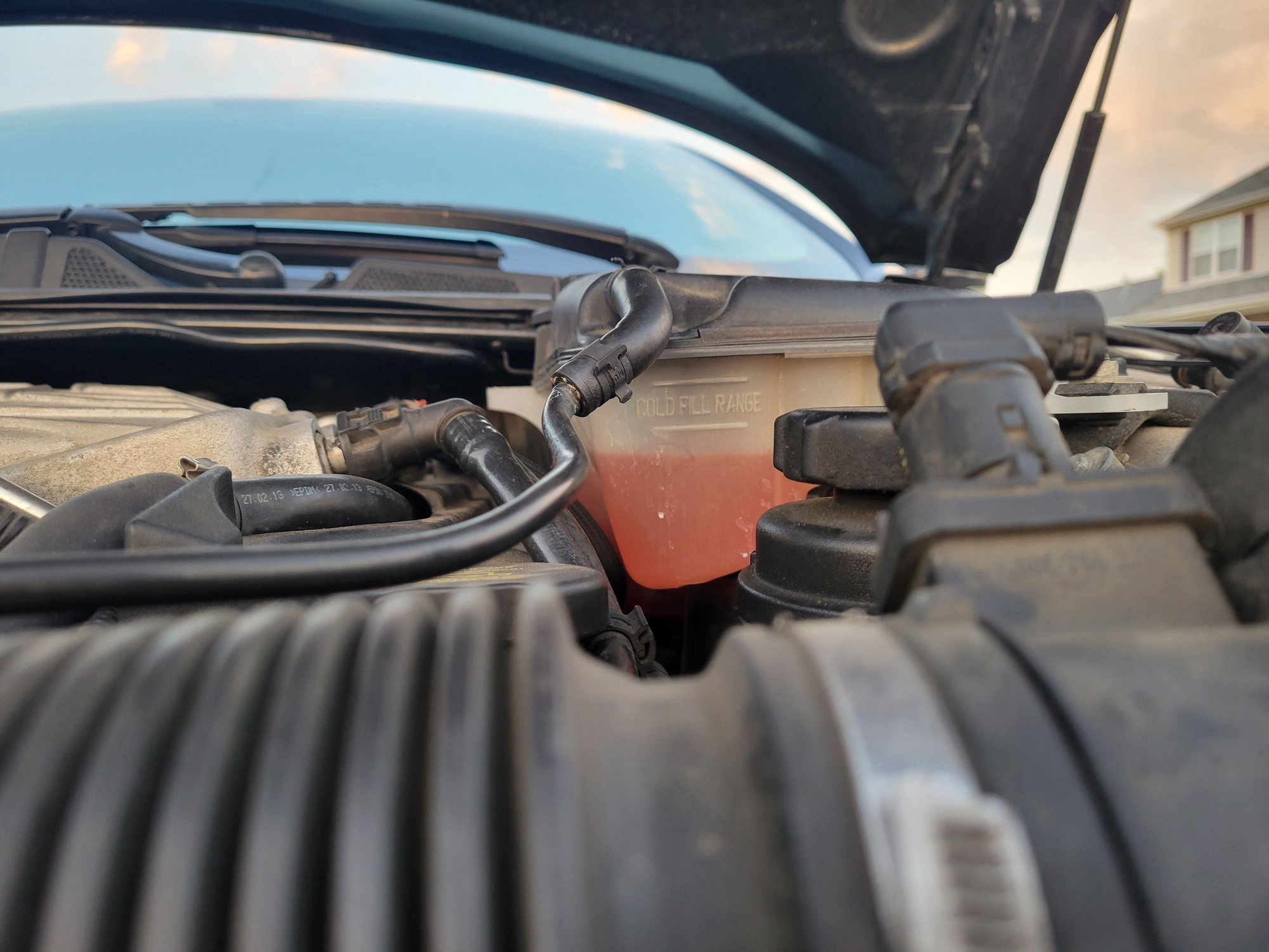

Checked level at 8am before driving into work. Level looked same as the previous two days but I topped it off. Drove to work (1.5 hrs away). Stayed locally (20mins drive) and checked level after getting back from work. This was the only time when I checked the coolant level when the engine was hot. Level was down but I thought it could be because of the pressure.
08/14/2025

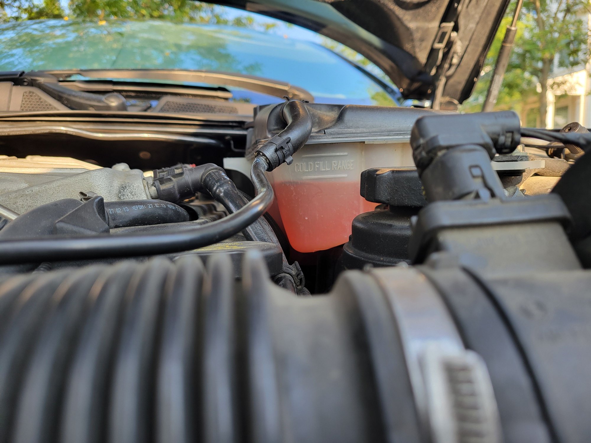

Checked level around 9am before driving to work. Level was a little lower compared to the day before after I had topped it off.

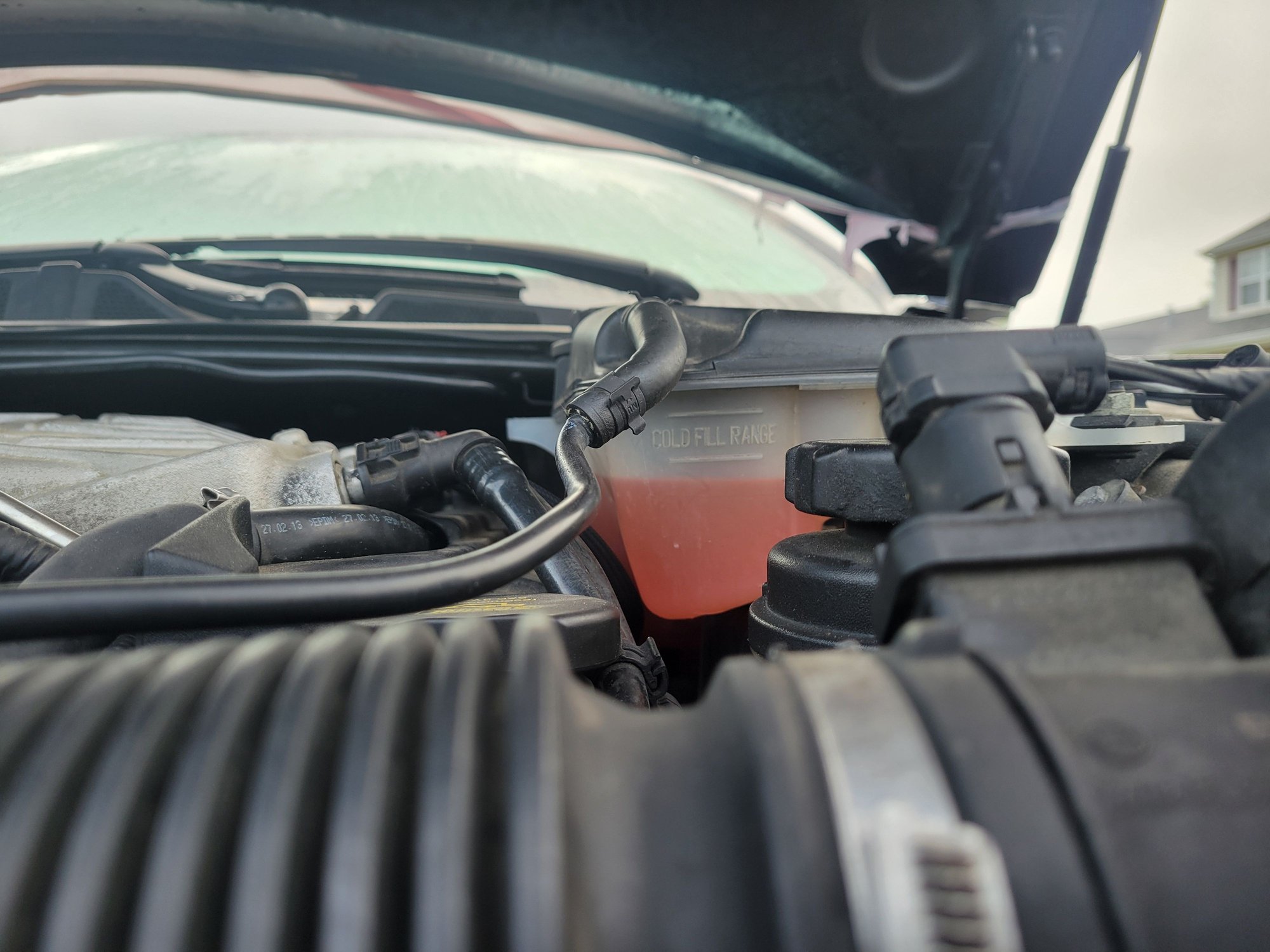

Taken before leaving work around 7:15pm. Level was lower compared to the day before. 5 mins into the drive, I get a coolant low warning and I just turned around and parked the car at the nearest place I could find. The coolant level was a little higher than when I had checked before the drive, so that didn’t make much sense. I thought there maybe an issue with the coolant reservoir too now but I had got this replaced in 2019 I believe (not saying that this doesn’t mean that it can’t go bad again). I took the top off (saw white steam coming out), waited for a little bit and then topped it off slightly so I can drive it back home before taking it to the shop. Kept an eye out the whole time for the coolant low warning again but it didn’t come back on. The drive back was 1.5 hrs.

11th August_2030
11th August_2030
12th August_2230
12th August_2230
13th August_untopped
13th August_topped
13th August_topped
13th August_1630
13th August_1630
14th August_0900
14th August_0900
15th August_1900
15th August_1900
