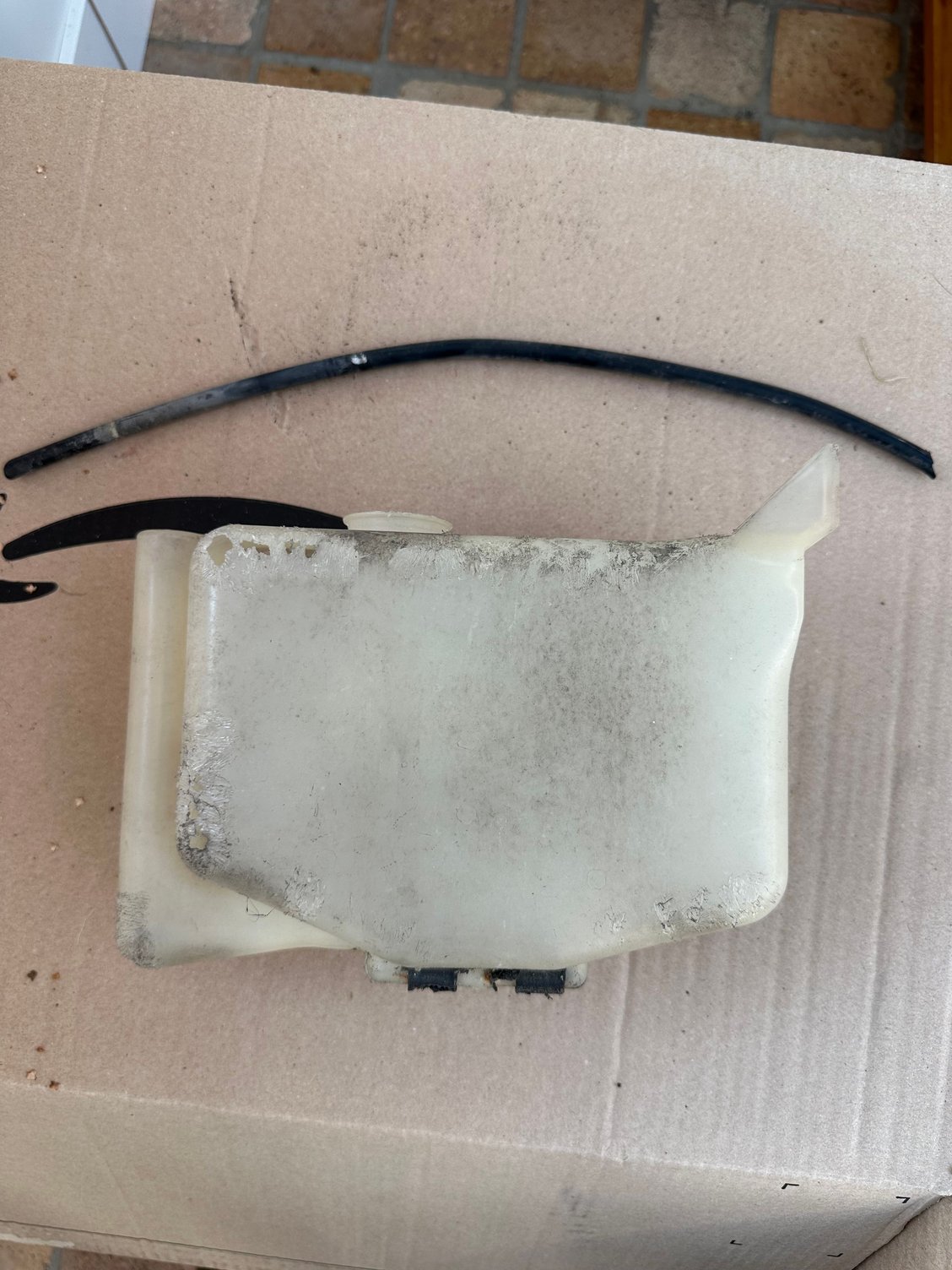

Looking through the gap with my latest toy I see this:
Looks empty to me
A hole at the top of the tank!
So looks like I need a new tank. Thanks to your fantastic tip I did not need to first take of the wheel and the liner to find out!

Originally Posted by Rishi
That is genius my friend and is worth at least a pint!
Looks empty to me
That has got to be rodent damage. It makes you wonder what else the little monsters have been chewing!
I doubt whether the hole is the reason for the coolant loss as the tank is open to the atmosphere anyway but it certainly won't help. Once you have a new tank and it's half full, then re-assess whether there is really any coolant being lost.
Richard

I can't see any other damage but it is a bit odd that the corner is gone.
Already ordered a replacement tank.

Once you have the wheel arch liner out, have a good look at the black pipe which goes from the black header tank to the top of the atmospheric tank. If the mice have chewed a small hole in that, or in the tank nearer the bottom, you could be losing coolant behind the liner which might not be obvious.

Little buggers seem to love coolant. I have a new tank but the feed tube has been chewed through too in 2 places. Trying to trace the route of this tube. Not easy to find! Do you think I can just use some silicon tube?

Yes, silicon tube will be fine. It goes up and across the front of the bulkhead / firewall to the spigot on the header tank.

Wow, routing that tube across the firewall and into the wheel arch was a major task. There were moments I wondered if it was possible without dismantling half the engine bay but after a few hours and many scraped knuckles it’s in with the new tank half filled with the tube primed. That should be the end of my Coolant Low warnings. Off to Provence on Friday so I will find out!
