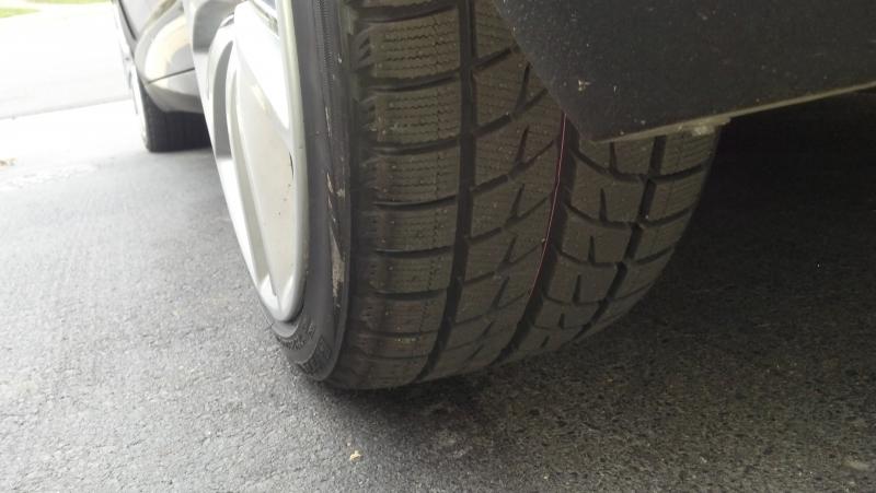

I just got my winter tires put on and the guy at the shop said..."I was researching your car, and apparently it's self learning". I drove home (about 15 miles with 1 stop on the way) and the light never came on. Hoping it stays that way!

Old Nov 7, 2012 | 09:01 AM
  #46
Donk's Avatar
Joined: May 2012
Posts: 100
Likes: 22
From: Rockville, MD
Originally Posted by cwood
what year and model is yours?
2010 sc
