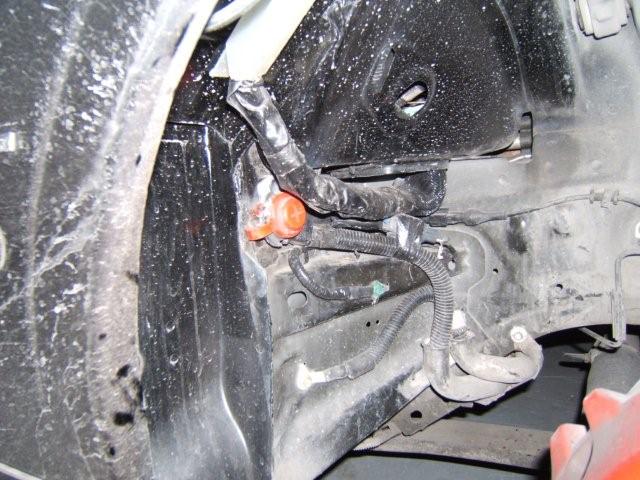

Hopefully Jaguar did not change the XF from the S Type. You should have an emergency jump point in the front fender well on the passenger side of the car. Remove the wheel well liner to take a look. I have not had an XF to check this on yet.
Here is a picture from an Lincoln LS which is built on the same DEW98 platform.
https://www.jaguarforums.com/forum/a...1&d=1451933448
