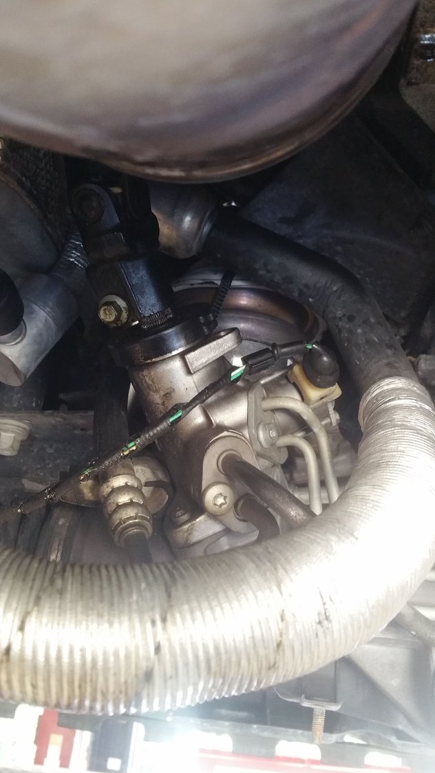

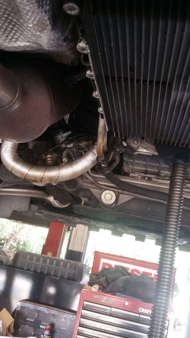

Old Aug 22, 2019 | 07:01 PM
  #32
HoustonSalsaR's Avatar
Joined: May 2019
Posts: 33
Likes: 16
From: Houston
Originally Posted by davetibbs
Huh, I struggled to get enough lift on the engine with a transmission jack underneath to get the mount with it's two threaded ends out of both the hole in the mount bracket and the hole in the subframe, because these threaded ends poke out from the mount quite a way both top and bottom, but maybe I just wasn't persistent enough
Thanks for the hint!
Originally Posted by XJ8JR
Where do you place the jack? The oil pan?

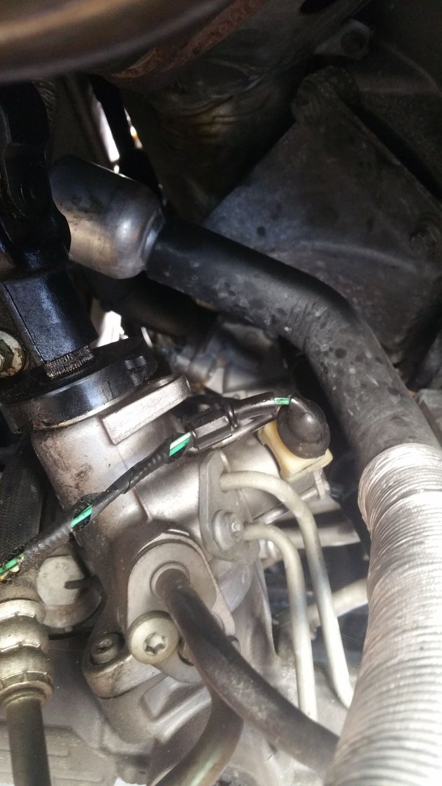

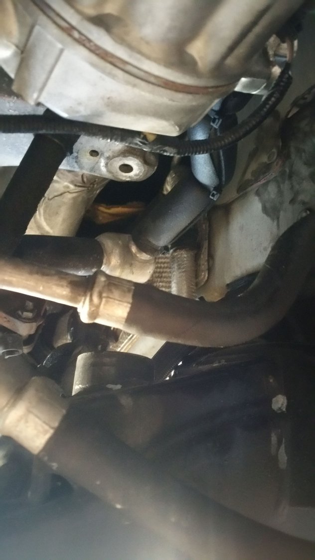

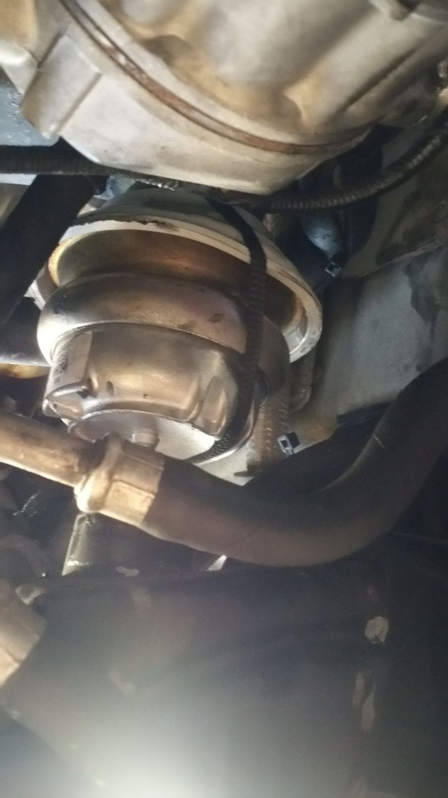

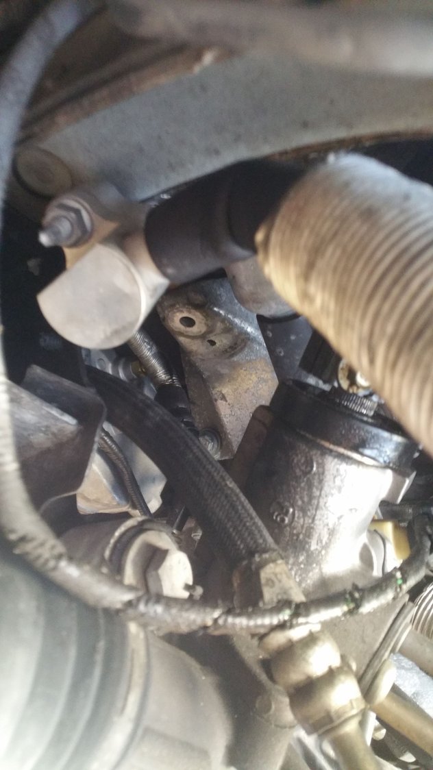

Ironically enough I had one come in to work today that needed the drivers motor mount. I did not take pictures of the support up top, but was able to take a few of down bottom
