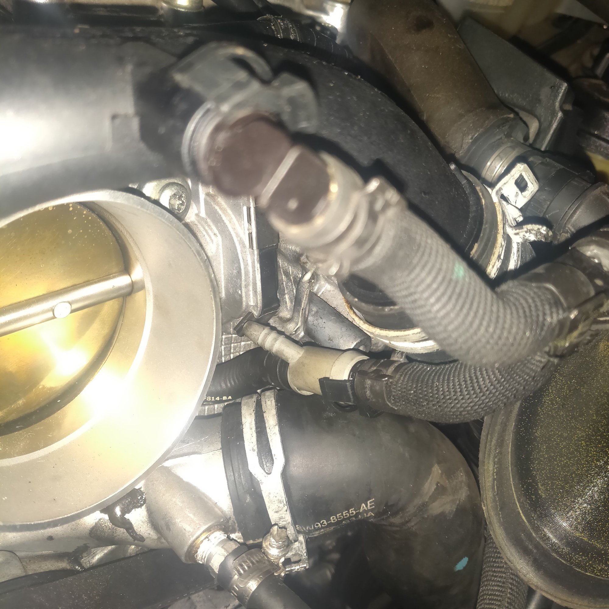

I pulled the supercharger. To get to the notorious tube that goes underneath the supercharger replaced it. but when I put the whole thing back together I found by the throttle body there's a coolant tube that has a y on it. That y isn't connected to anything. comes right off the coolant Reservoir. Anybody know what that might be? And I don't know if I missed putting the hose on that when I put it all back together and it's a hose that runs underneath the supercharger I'm not sure?
Right there in the middle of the picture by the throttle body.

My F-Type V6 looks exactly the same so I don't think you have missed anything.
Of course that doesn't explain the mystery of the extra ribbed protuberance!

Nothing goes connected to the ribbed end of the Y Fitting. It is oddly plugged/blocked.
