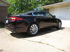

I did install a set of 235/50r18s over the weekend. They fit perfect and the difference in ride quality between the original 245/40r19s is phenomenal. Combined with the Spires, its almost a real luxury car now. Plus I think it even looks much better.
