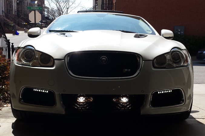

I get bored fairly easily, so I jacked my car up, dropped the under tray (belly pan?), and added a few sets of Hella fog and driving lights behind the grilles for people who won't get out of the left lane at night (in addition to my Stebel 139db mini air horn). They're controlled by a single 3-position rocker switch which I discreetly mounted under the dash. I integrated the wiring for the two sets of lights because I knew I wouldn't feel like taking the time to find multiple switches for the lights, whenever I "needed" them. The bottom lights have dual bulbs, one for fog and one for driving; I switched out the stock 55w fog bulbs for 55w yellow bulbs and I switched out the stock 55w driving bulbs for 100w bulbs. I left the top lights as they were. But, I also have some 100w yellow bulbs, as well as some H3 LEDs with which I might experiment. I sealed the housings with some rubberized coating to prevent water from getting in. As I expected, having them mounted behind the grilles reduced light output and spread, but I didn't really care. I just felt like playing around with something for the weekend. Ultimately, I really like them. You can't really see them mounted behind the grilles when they're turned off, but they add a bit of fun whenever I flip the switch.
Yes, I took everything into consideration regarding local laws, wiring issues, heat issues, etc. I'm sure a bunch of "purists" will hate them, along with most everything else I've done to my toy, but I thought I'd share anyway, in case it interests anyone else who might be a little more open minded.

That's a lot of lights! What are the LED strips - and how did you install them?

I rarely use the fog/driving lights, but they're nice to have whenever I need them. And, like I said, I was just bored a few weekends ago, so felt like playing around with something. I've also upgraded my high beam lights to HIDs, converted all stock bulbs to LEDs (including strips in the trunk), etc.
The LEDs are Philips DRL8 DRLs (12824WLEDX1) and work in conjunction with my headlights; they're full bright until my headlights come on, then they dim. I think I posted a few pix of them somewhere else on here, too. I also put them on the front of my '12 Range Rover Sport Supercharged (see attached pic). They're extremely high quality and have been perfect, after close to a year. To answer your question regarding DRL install; they're fairly easy to do. I used 3M double-sided auto tape to attach them, which is completely reversible without hurting the finish of the car, etc. I just ran the wire through the upper grille mesh holes. I ran the driver-side light wiring behind the bumper to the passenger side of the car, then I ran both sets of wires to the passenger-side headlight. I pulled the signal from the passenger-side headlight, and there was an existing ground bolt in that area, which I'm also using for my fog/driving lights and additional horn. I ran the power to the engine fuse box, which is also on the passenger side of the car, using a fuse tap, and voila.
My car has a ton of wires running around it from the sub box, amp, bass knob, capacitor, Escort Redline radar detector, Escort Live Direct Wire, Laser Interceptor Quad laser jammers (and separate rocker switch), the Escort external speaker, the Laser Interceptor external speaker, the Stebel mini air horn, the three sets of additional lights (and separate rocker switch), etc. But, they're all completely hidden, as I'm extremely **** about everything.
