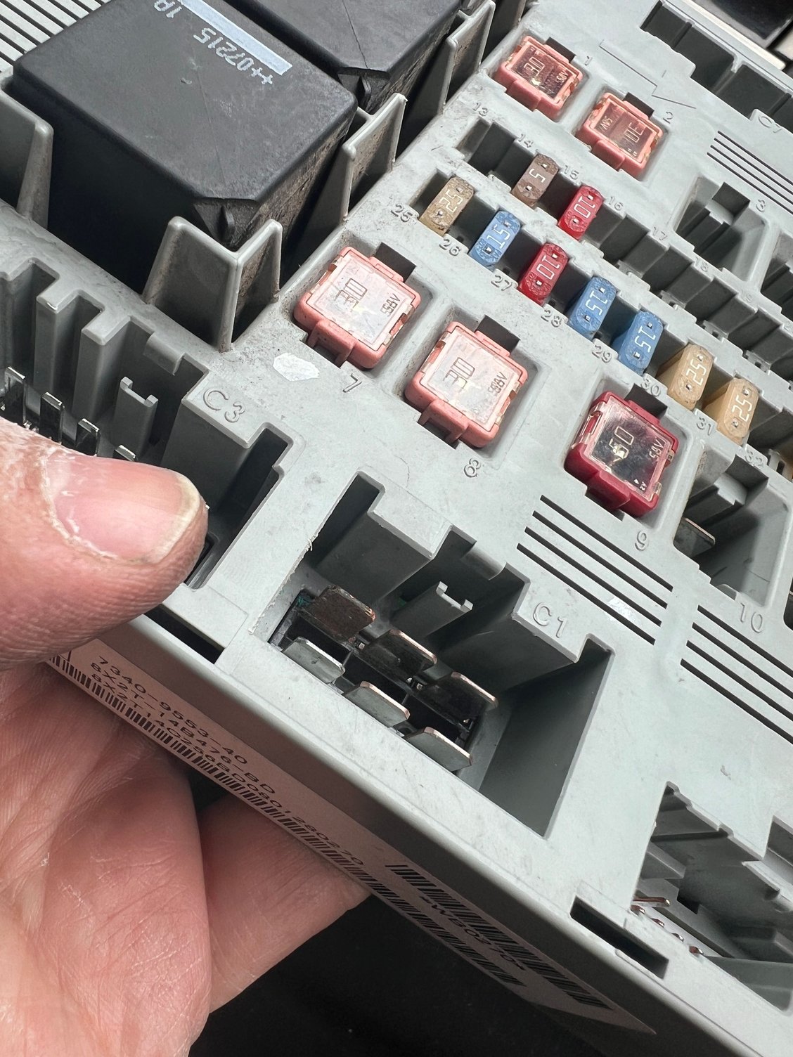

Same situation here... I turn the ignition or the car on, and all the interior lights will not turn on or off (odometer illumination, cabin illumination, other dashboard illumination element, left or right signal), but the hazard triangle with hazard signal will be ok. After this period of 20-30 seconds, I can turn off and on the interior light, and this is the same for the exterior light. I can`t command them during this period. Even the auto light will be turned on after this period. On the rear BCM (RJSB), I can see that 3 pins are slightly corroded, which means the water from the trunk has been present in the past. The corroded pins are on the C1 connector. No error codes for the lighting module.

- So far, I`ve cloned my front BCM (CJBS) unit, but nothing changed. I want to do the same for the rear BCM (RJBS), but I don`t know if my issues are related to these two units or something else, like ground in the car or another module which can cause all these faults. I don`t want to just clone the module and be in the same situation, but as the last step, I will do that also. Any suggestions will be more than welcome. Also, forgot to mention that I bought the rear yaw sensor and steering wheel sensor because they were cheap and could also be the cause of my ABS / DSC EBD issue, but I didn`t install them yet. I would like to have some suggestions which might help me with my issues. Another thing I would like to ask is what ground I should have for my issue?? Any suggestions for the ground which I should look more carefully at?? I`ve already checked the rear power distributor for loose connections, but it looks all fine and nothing loose there. Thanks, folks, in advance, and sorry if I didn`t explain my issues good enough, maybe.
