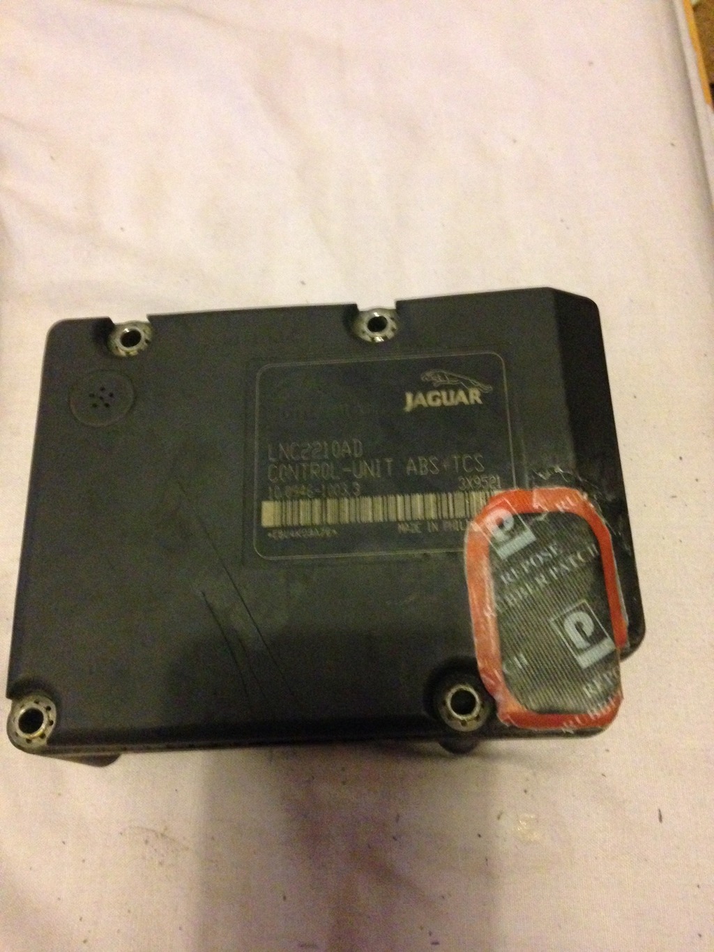

I pulled out the ABS module and opened it up, the solders looked fine but I resoldered anyway just in case , see pic below just opened up
I put it back together holding out little hope and no differnece

You do not have a C1095 code, so the connection to the pump is probably okay. But I don't think the picture of the pins shows a good enough solder repair. It is often necessary to scrape the insulation away to get a good flow to the circuit board.

I should have posted other pics of module repair, the one in first thread is before repair, the solders looked OK, i just went ahead and soldered since I had it open and is known as a weak point.
I am also going to change the brake fluid also, car needs it anyway.
Heres pic of repair, I used a bicycle patch to cover opening, will see how it stands out but seems as if it will be up to the job.
Fredd, I had done what you said about wriggling the wires around on both front cables and had no continuity problem, Its starnge that both would just go together anyway as the car has been sat where it is/not driven and had no problems before been parked up.
