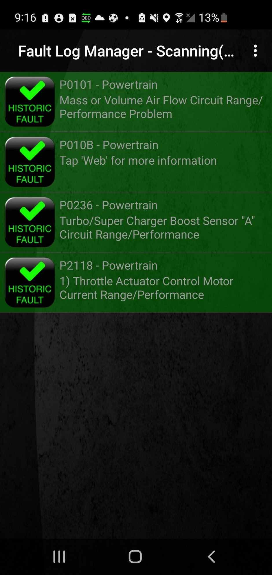

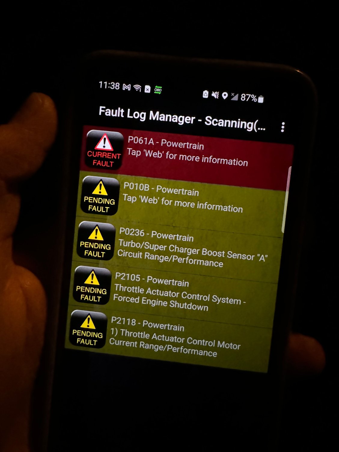

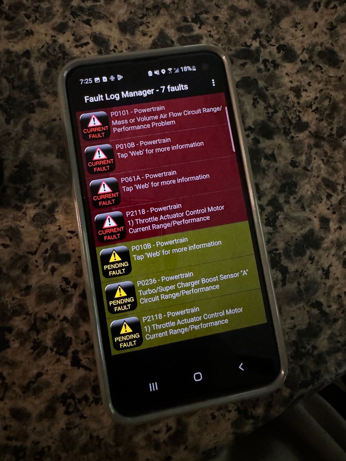

Default Supporting docs
A lot of these have different codes shown, but I’m including here because they all pertained to this same issue we both had, and all had the same fix
Codes
Codes Cont’d; Getting ready to change underpants
All green checks after cleaning throttle body!
