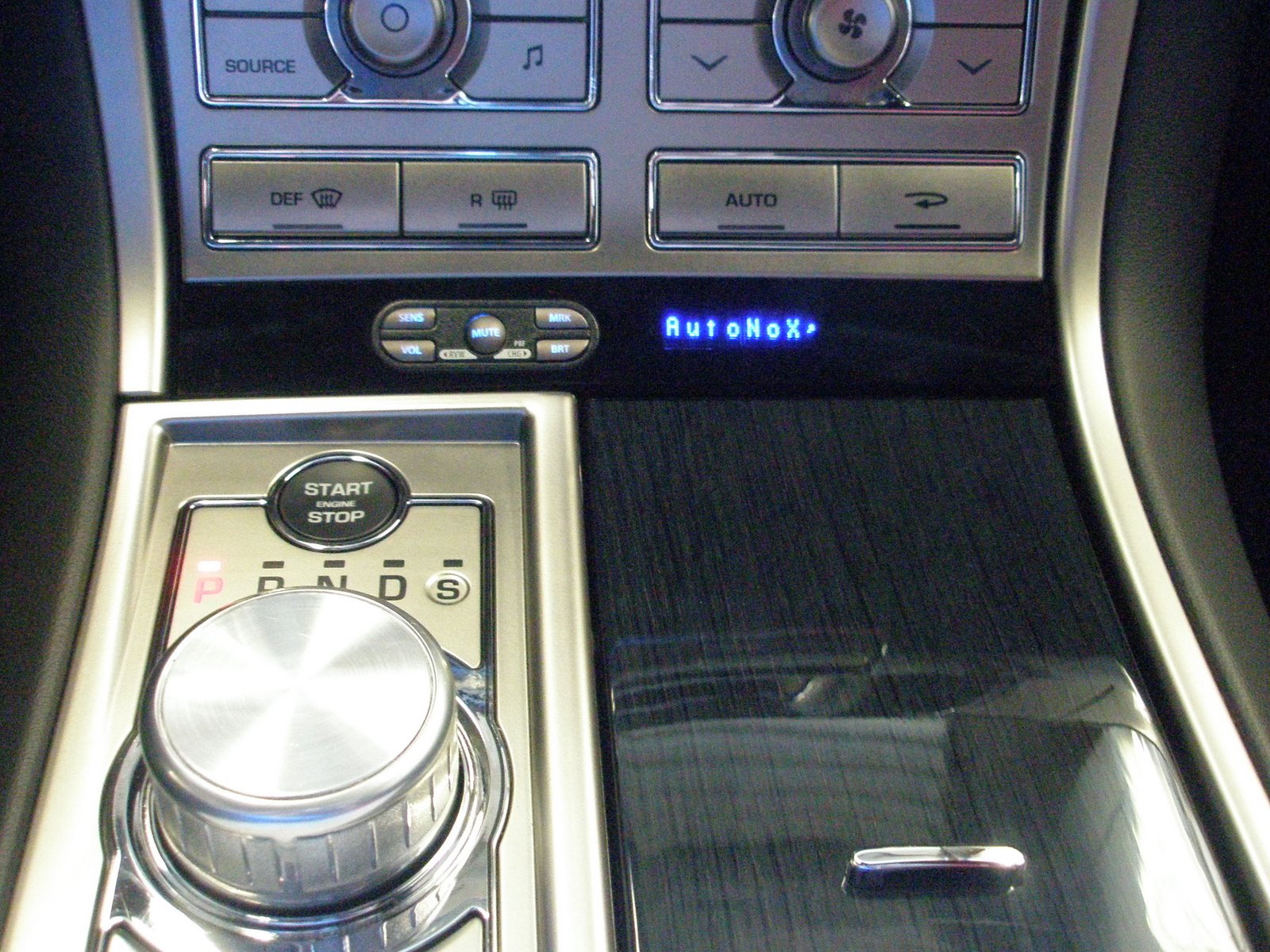

Here is another install of the control module that I found to look nice.
Jaguar+XF+9500ci+display+and+controller+in+center+ console+(3).JPG (image)
Yes, very nice, too. It's nice to be able to hide the control unit and display when you want to, though.

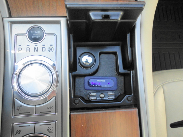

Update- Dropped my XF off for the install today at a reputable auto shop. Will cost me $575 to have the install with the control module placed above the cup holder identical to Need4Spd's, getting the car back tomorrow.

Default Couple pics
Thanks to Need4speed for the ideas
Attached Thumbnails Escort Radar 9500ci install-dsc01546.jpg   Escort Radar 9500ci install-dsc01547.jpg
