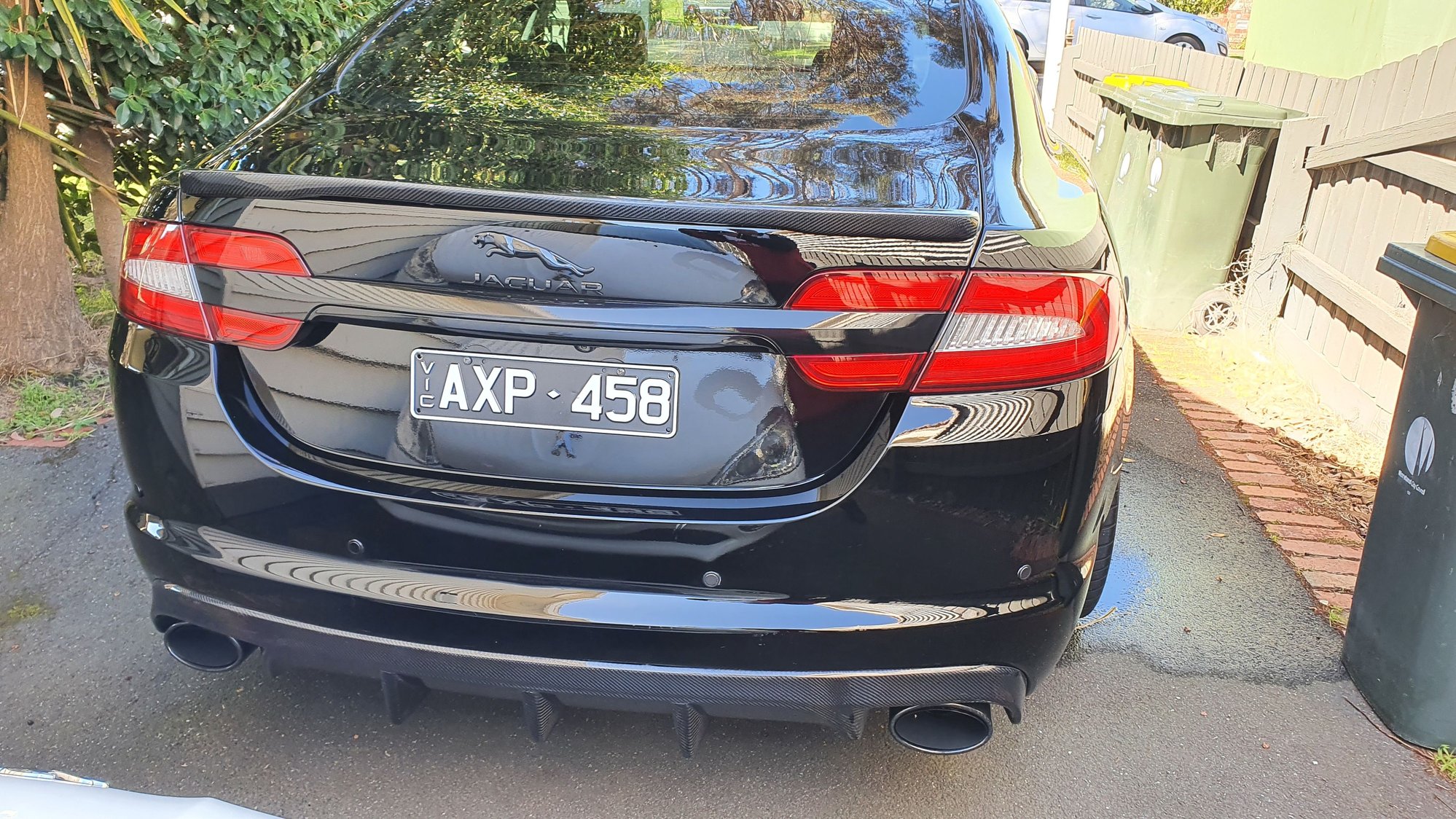

Hi, the diameter you need is 63mm inlet...many of the exhausts on offer on Ali are fairly long (250mm) from end to end and sometimes extend too far out and don't blend in well with the body. I went for the oval tips on my V6.

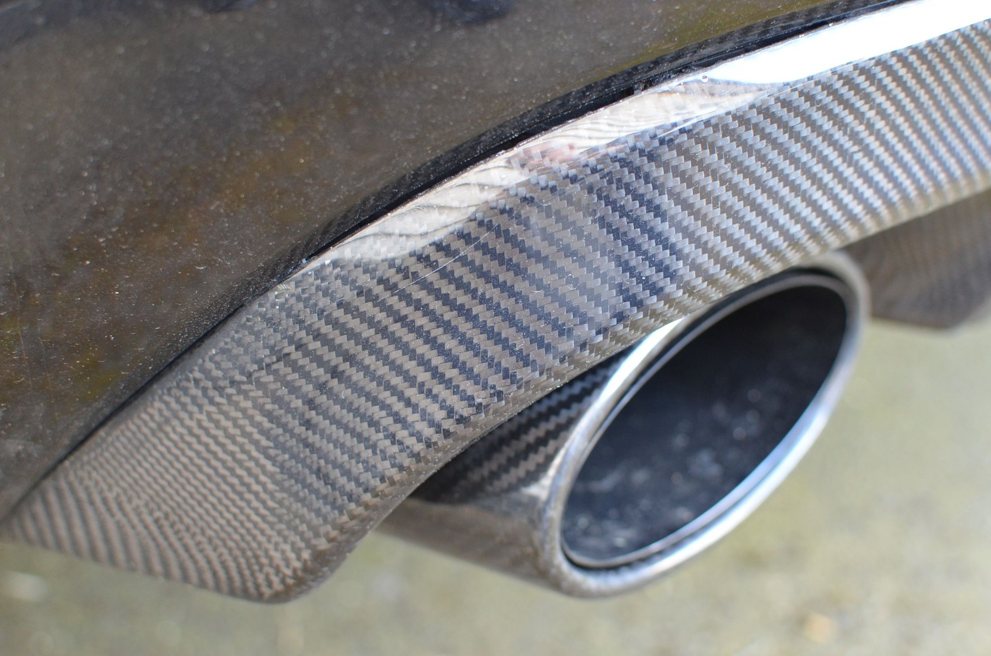

I bought a caliper and measured my exhaust pipe right after the muffler (just before the tip) and it measured 60mm OD.
I got the tips from AliExpress (60mm ID) x 89mm double, but I modified them to suit.
Took the rivets off to remove the carbon outer part, painted the inside yellow to match a few other yellow highlights on my car.
Also, because they are too long, at 250mm overall length, I cut back a few mm and cut new slits to allow it close tight over the existing pipe, just enough for the bracket to grab on and hold it in place
This is the result.
