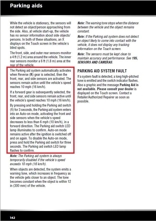

Originally Posted by Swimref
This is exactly how the car was designed. The system comes on every time the car is placed in reverse, or if you press the overhead "P" button while going forward at low speed. Press the button and you won't need to go into reverse first. A 2016 car is an X 260 and not an X 250 which this forum is for, so your car may be different.
+1
Relevant section from the Owner's Handbook for your Model Year:
