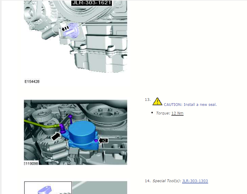

Can someone tell me what this cover is called? From the manual, there is a tool used and it is JLR-303-1621. I think I have an oil leak from this cover shown in blue and there is a vacuum? hose attached to it I think. The manual says to install a new seal but I need to know what to look for to get a new seal. Thanks in advance for your help.

You need one of these.....
https://www.ebay.com/itm/38367965932...mis&media=COPY
2 screws to remove. No special tools needed.

You are awesome!!!! Thank you. Found this video about them leaking and probably will order their rebuild kit.
Attached is pic of mine.
