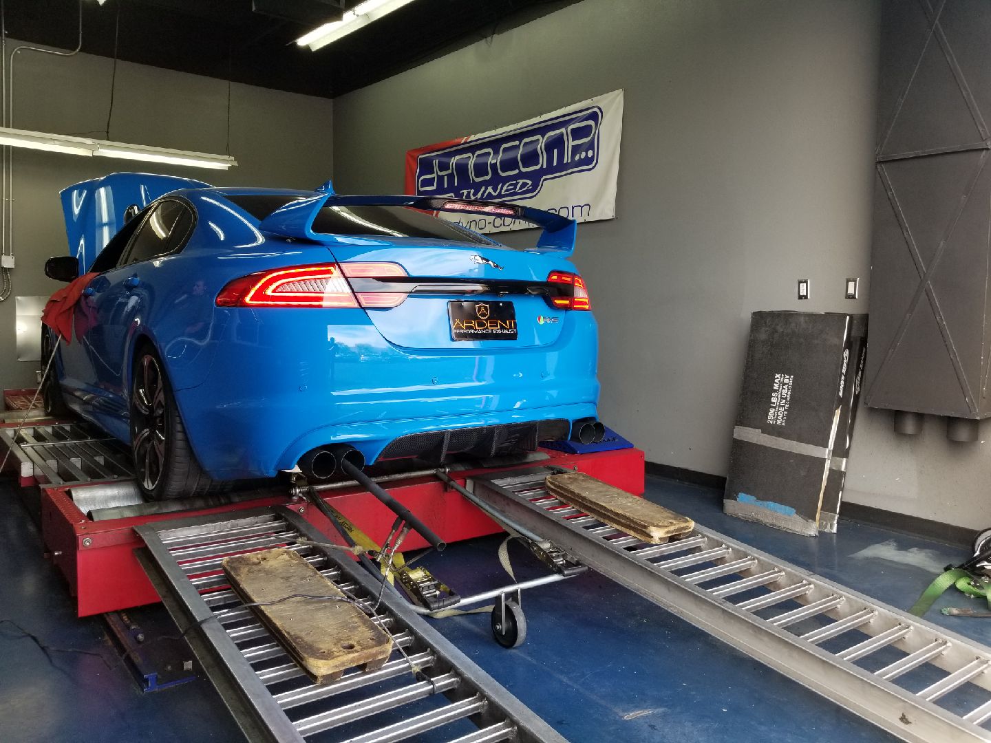

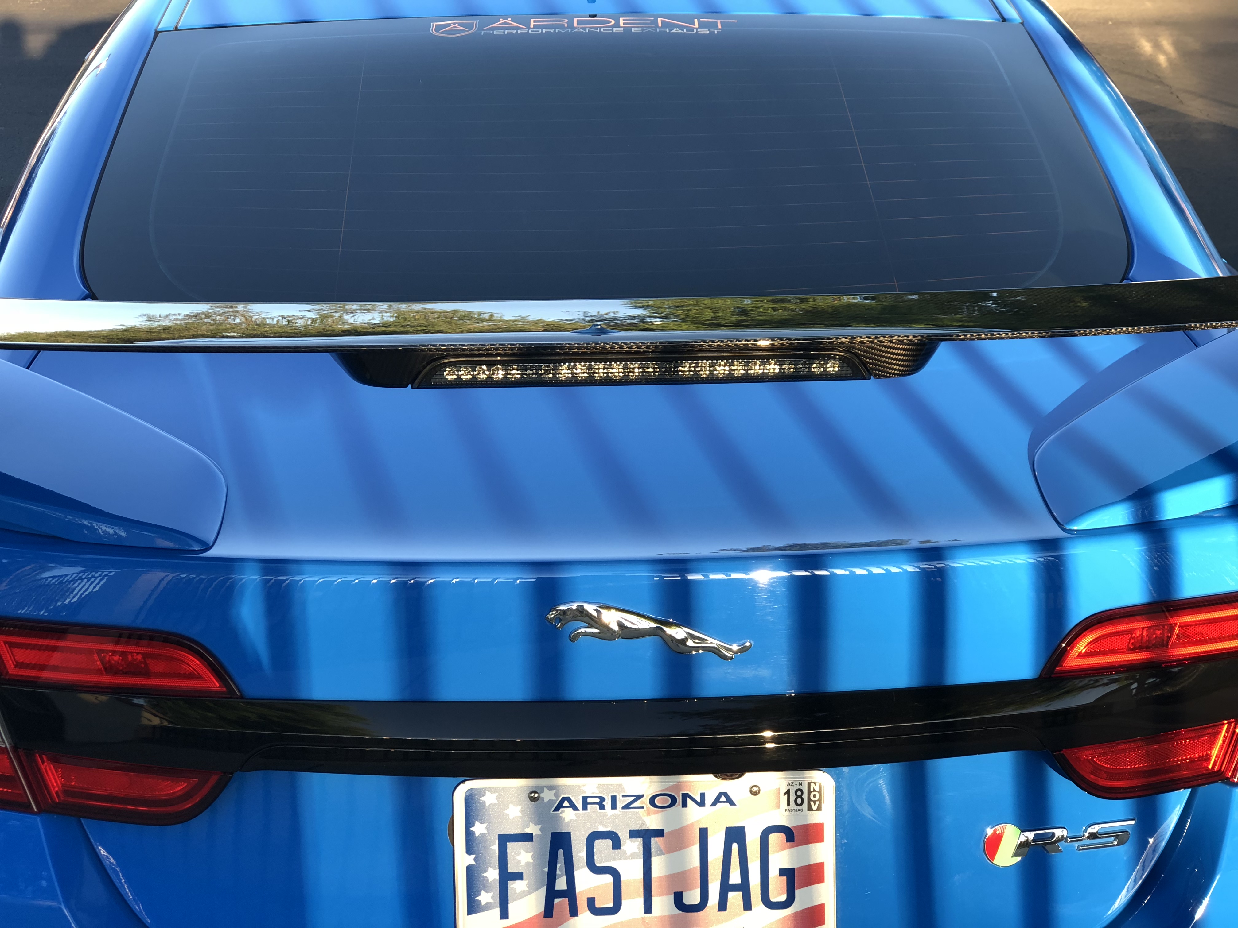

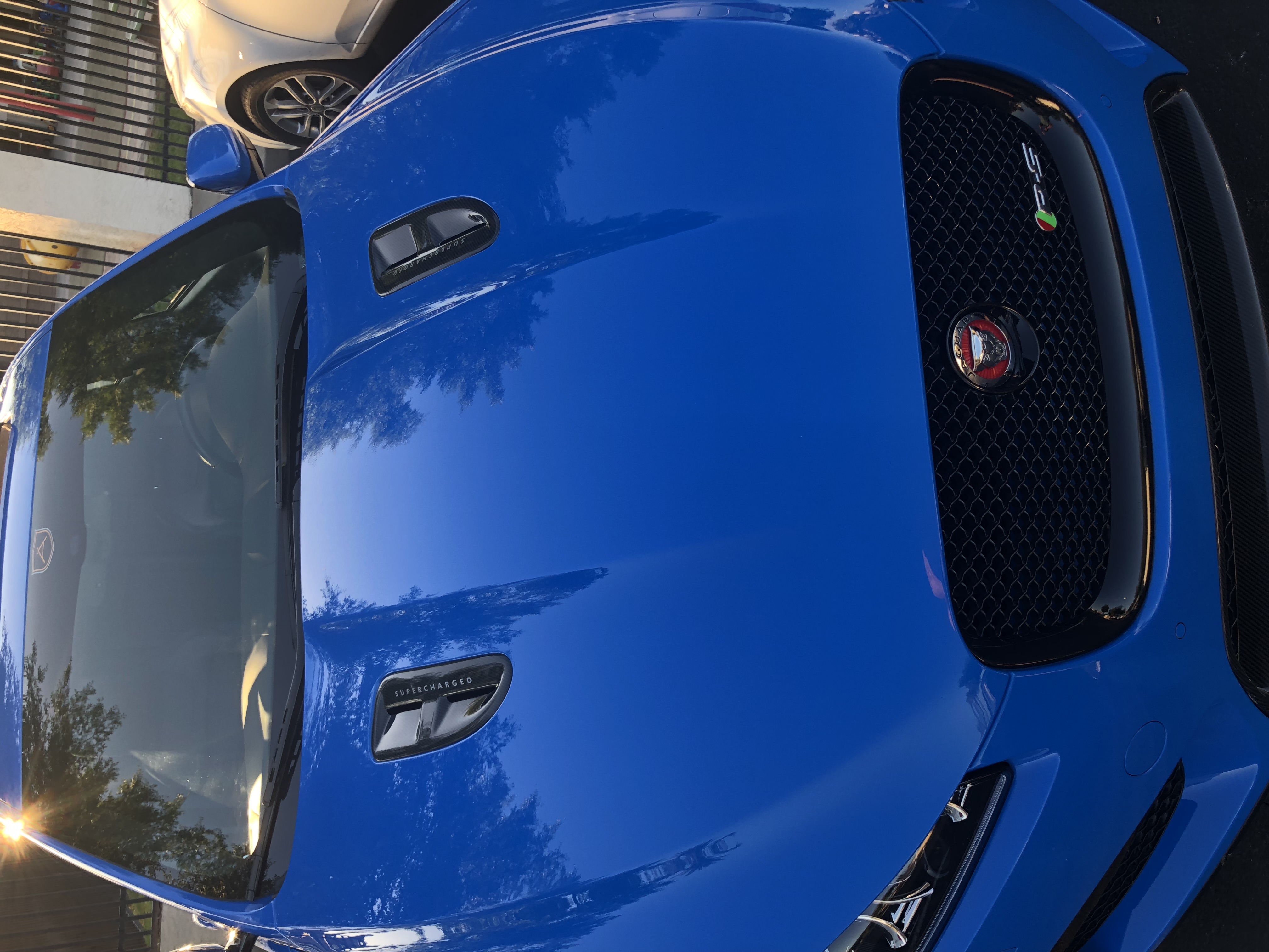

Default A grainy exhaust vid and a few overall pics
First time trying to upload a video...we'll see how this goes. It's a grainy one from me leaving a coffee and cars event a few weeks back. I promise to post better vids in the future. As mentioned before...possibly a YouTube channel as well. Throwing in a couple overall pics of the car too...just for good measure :-)
I reiterate to everyone, the exhaust has been bulletproof since it's been done. Truly outstanding in my opinion. I've had numerous high performance vehicles with full custom exhausts on them, and this is by far the best one I've had yet.

Looks like next time I'll preview my post to ensure pics don't end up sideways!
