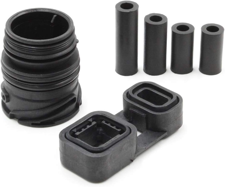

For what it's worth - I'm afraid I can't give any advice on cost, but there are usually 2 main causes to this on our car's ZF 6HP28 transmisisons: 1) Failed seals 2) Failed bushings.
To illustrate the failed seal issue, here's an image of a replacement seal kit for the transmission - you can get these everywhere on ebay etc.
First likely seal failure: The seal for the connector to the mechatronic unit, which locks into the transmission casing - this is the threaded plastic tube on the left of the image above. This has O-Rings that break down over time, and can leak - this is usually easily spotted just from crawling underneath the car and looking around the wiring connector on the rear of the transmission.
Second likely seal failure: The valvebody-to-transmision seal - there are 5 of these (the remaining seals in the image above), but the rectangular plastic one is usually the one to go - the plastic goes hard and brittle over time (much like our coolant pipes ) and then cracks under vibration/heat cycles, causing fluid to leak.
Both of these things can cause loss of fluid pressure or overheating, which can cause the issues discussed. You can actually replace all seals necessary with the car up on a lift (or even jack stands) - there are a couple of threads on the forums including one I've written that detail this.
The second problem is more serious, which is a bushing failure - the bushings inside the transmission wear out over time, meaning that when the transmission is hot the fluid can leak past the bushings causing clutch slippage etc. This is usually most obvious in the higher gears. This will require a transmission rebuild to resolve (or replacement with a good used one). However, it's worth noting that the ZF 6HP26 or 28 is a ubiquitous transmission used in BMWs, Audis, etc, so plenty of companies like Sonnax sell bushing kits like this one, but also there are plenty of transmission shops with the knowledge and tools to rebuild these units, so having the transmission rebuilt may not be cost-prohibitive or even difficult.
