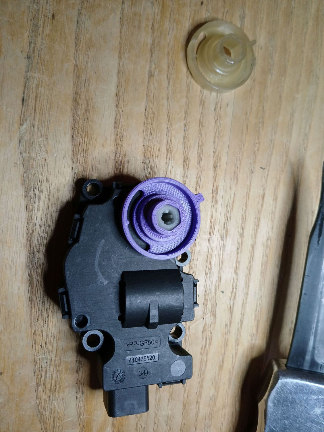

I've just dismantled mine and found the broken plastic ring clutch thing. Found a mob on the internet who supply an aftermarket part for a fraction of the best price I could find the genuine one, reviews are good. I ordered two, never hurts to have a spare with such things. I'll put things back together until they turn up. https://www.cs2000-z-tech.co.uk/prod...h-jlr-c2z31321

I just installed the non-genuine vent clutch.
And the vent still doesn't work. It rotates only partially, pretty much what it was doing with the broken part in it. I guess the next step will be to take it apart again, I'll try operating the stepper motor with it detached from the assembly and see what it does.
