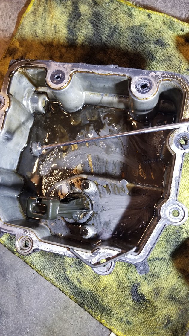

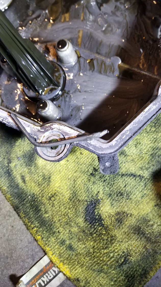

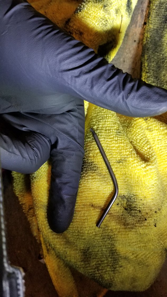

Dropped oil pan today after finding limited shavings elsewhere, found this big pin looking piece of metal just laying in the bottom, any ideas? Also the grey sludge in the bottom of the pan is magnetic what could it be? And lastly there was no metal in the oil pickup and no real chunks other that this pin looking piece which is pretty large and worrisome
Oh wow, that's one of the oil spray jets from the timing chain area. This suggests the chains were so loose they interfered with the jet and snapped it off. Bad.

THe front covers upper and lower are off, waiting on a fuel injector tool to take the injectors out to look inside. The grey sludge in the pan to me looks like what happens when a piston is rubbing the wall while an engine is knocking....someone feel free to correct me if its not. As for the oil spray jet, should I be able to see where is came from with the front covers off?

Quote: THe front covers upper and lower are off, waiting on a fuel injector tool to take the injectors out to look inside. The grey sludge in the pan to me looks like what happens when a piston is rubbing the wall while an engine is knocking....someone feel free to correct me if its not. As for the oil spray jet, should I be able to see where is came from with the front covers off?
Sure - from memory, there's a single jet that points at the gears at the end of the crankshaft, and then another Y-piece jet that sprays at both primary timing chains. From the length of yours in the picture, it's from this second Y piece. Check around the left-side of the block as you're looking at the front of it with the center timing cover removed, you should see the remains of this Y piece still screwed in.
