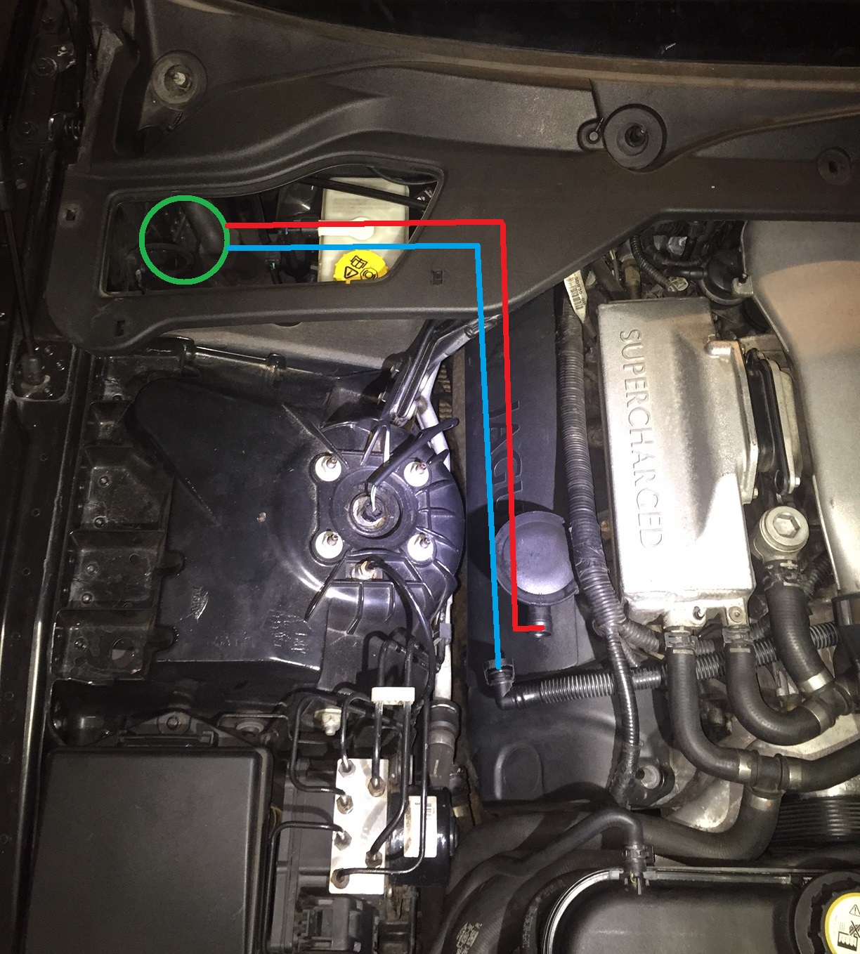

The catch can has an inlet and an outlet.
It is spliced into the existing line of interest.
Green circle is the location of the catch can.
Red line is from the PCV to the inlet of the catch can
Blue line is from the outlet of the catch can, connects to the existing PCV line that goes to the intake.
Or the other option is to relocate the PCV valve to the same location as the catch can, but it's still plumbed the same way, just with a line from the valve cover, to the PCV, to the catch can, and then connecting to the existing line that goes to the intake.
It was the talk about o-rings that confused me into believing
you were boring an additional hole in the valve cover.
One way to avoid the fitting problem is to cut the existing
hose beyond the coupling and use two hose joiners. The
fitting can be swiveled towards the fender to lead towards
the catchcan.

I'd rather keep it reversible, and cutting the hose means that if I want to go back I will have to remove the throttle body (and strip back the entire scuttle & cabin filter assembly) to connect a new hose at the intake, there is virtually no access to the fitting at the back of the engine.
It would be neater to re-route that hose along the back of the engine to where the brake master cylinder is, rather than how it is now making a big U shape.
The PCV valve has two o-rings on a spigot where it slips into the valve cover
You can also see the barbed spigot, that's where the Norma coupling clips on.
So to relocate the PCV valve to the same spot i'd have to make 3 new fittings, 1x elbow for the valve cover (spigot with two o-rings, and a hose barb), one straight coupling for the PCV valve connection (socket to seal on the o-rings, with a bracket of some kind to hold it tight) and a male barb to hose, for the Norma coupling.
The two straight couplings are easily done on a lathe, the elbow is more complicated, but it would be very neat and OEM looking.

The proposed catch can requires a permanent drain to the sump, not good. Need to find a better one.
