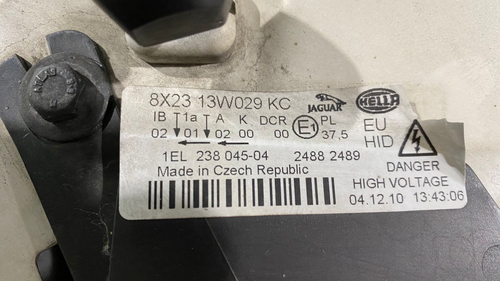

Hi, this is for a 2011 5.0 n/a (pre-facelift) Premium in the South Korean market.
I'm trying to work out what spec the lights are; US or EU or something else. The main beam is HID Xenon, high beam is halogen. Some people refer to the XF headlights as bi-xenon, but I'm not sure what they are referring to. The bulb is not a bi-xenon bulb. Is the projector a bi-xenon projector, with the moving shield which changes the light pattern? Or, are they just xenon lights, not bi-xenon?Also, I understand there are different standards for light patterns in different markets. I wonder which standard my lights are ... can you help?
The RH headlight has this code on the sticker: 8x2313W029KC. I don't know if it is the original headlight. My search on the code brings up mostly Russian sites.

Those look like the US spec HID lights. It's a Xenon bulb for the normal headlight (D1S as far as I remember). And a separate Halogen H7 for the main beam
People describe it as bi-xenon but really they mean it's a dual headlight with xenon dipped and halogen main.

Thanks for your reply. After some more reading, I think the lights are US spec, too. The light pattern is definitely DOT standard and the units are certainly not bi-xenon by any of the various definitions.
I'm not having any issues at the moment, just ageing bulbs. When I started to investigate what bulbs I need to replace the old ones, I stumbled upon a video of a chap refurbishing an old set of BMW xenon headlights, and that raised more questions about the spec of my lights. Consequently, I've learnt a lot about projector lights that I don't need to know

The light is labeled as an EU HID?
I would think that means an EU light and NOT an US one?

Yes, that was my first thought. However, internet searches on the code threw up enough confusion for me to ask here.

Well I guess that answers your initial question. They are not the North America spec given the bending light and not having the little extra side marker.
And I'm sure the xenons were all bi-xenon per the workshop manual.

I checked for the shutter again by covering the high beam section of the lights. You are correct, they are bi-xenon projectors.
Thanks for helping me on this little journey of discovery and understanding.
