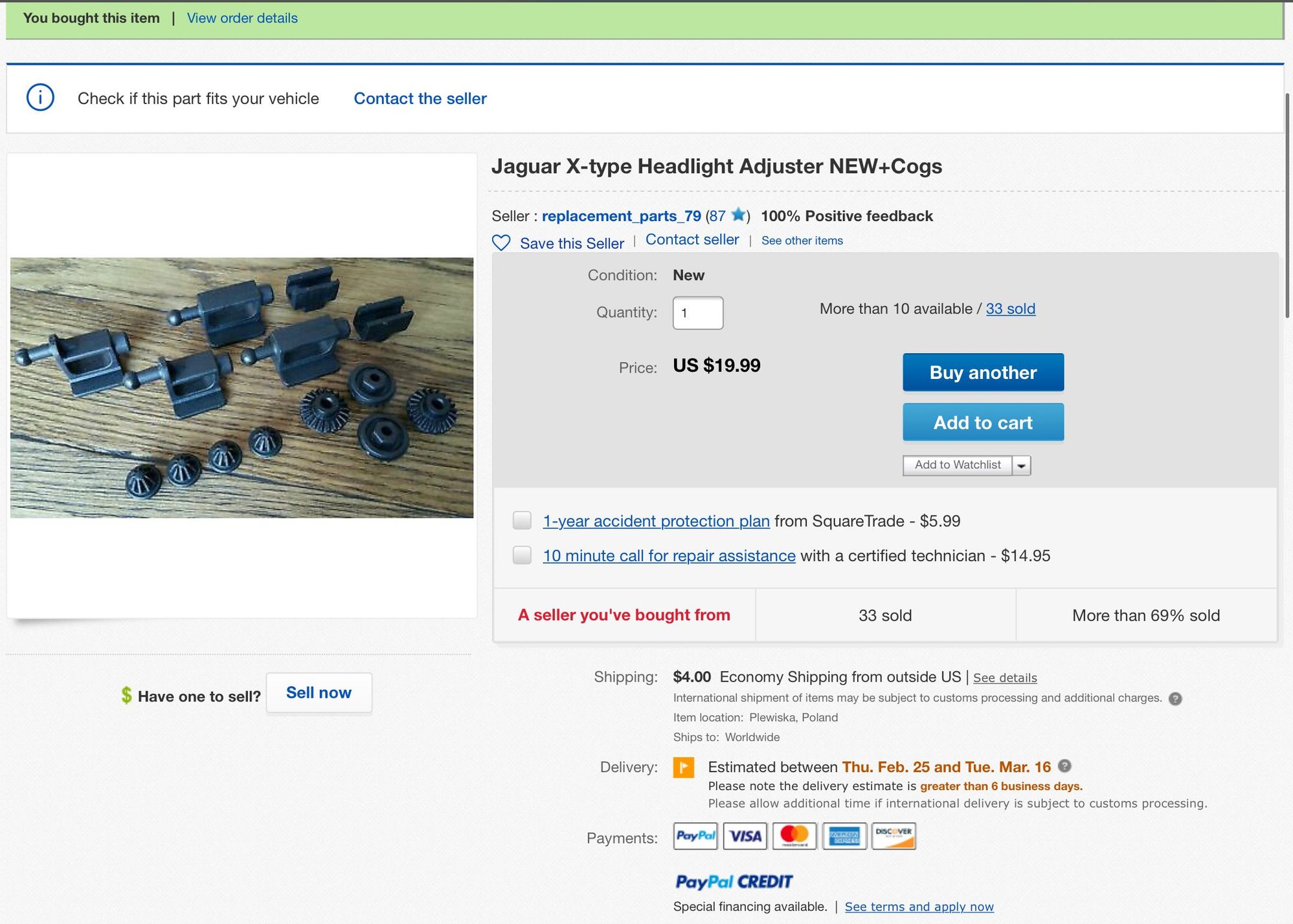

As for your passenger side housing. You are suffering from a common X-Type problem. At some point, your housing has taken a good shock or someone has pressed on the internals too hard and this has broken the mounts that hold the interior still. As a result, this will cause the headlight to either aim way high into the air or to a spot immediately in front of the car. So, repairing/replacing this is a must for good light display. If you look on here, there are a few good write ups on replacing the "headlight mounting". You can find these replacement kits on places like E-bay for around $30 USD. This will do both headlights. The big problem is you have to bake the headlights at about 250F to soften up the glue to let you pull the clear part of the headlight off so you can access the insides. The write ups will go into a lot of detail on this and then tell you how to seal it back up. This will also require you to remove the front bumper cover to be able to remove the headlight housing. The other option is to look around for a used part and buy that. Then you simply need to find one that doesn't have the same problem you have now. What that will cost is dependent on whether you have the halogen headlight setup or the HID setup (you don't state which you have, if you are not sure, there are a few give aways that will differentiate between the two).

It was after that I started seeing where the running light bulb was and then tried to remove it. Good grief. Turn, twist, pull, nothing! I was afraid I was gonna break something. My mounts are shot and I ordered new ones on ebay for the 20 bucks + 4 dollar shipping. I got the one Dell posted in another thread. I will replace one weekend when they come in. I ended up watching a YouTube video of another guy changing them and he said they pull out with about 50% more force then he was comfortable with so after hearing that I just pulled until it came out. Bulb was blown and I replaced it. Now they all work.
