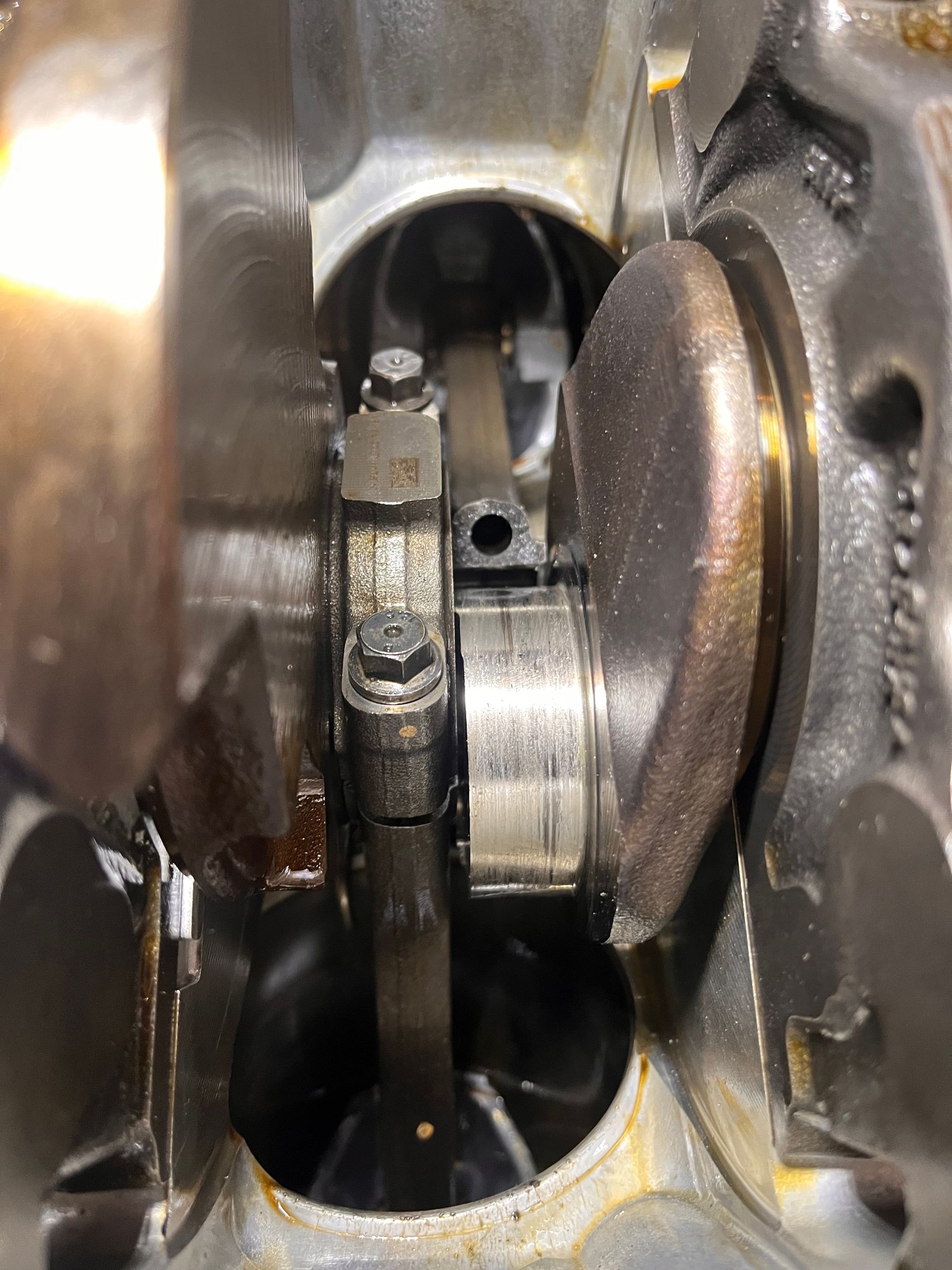

Rod knock. It has lost a rod bearing.
Mine lost one, same knock. I safed my engine, new bearings, new rods and a crankshaft resize. It was very nice job to do.
Journal seems good
Journal seems good
A former rod bearing
Journal seems good
Journal seems good
Ok, Thanks !. Did you pull the engine to perform the repair ?. I'm not sure this can be done under the car, looks like the crossmember gets in the way.
Yes, best way is by dropping the subframe. It is a total dismantling of the engine. I saw it as a chance to fully build it. These are really nice engines to work on.
