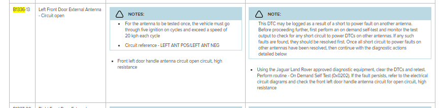

My code reader shows this fault code.
B1336M-13 is a Jaguar fault code logged in the Remote Function Actuator (RFA) module — the system responsible for keyless entry, remote locking/unlocking, and passive entry functions.charm

  • 13 – Failure type suffix: Circuit Open (indicating an open circuit in the associated component or wiring)

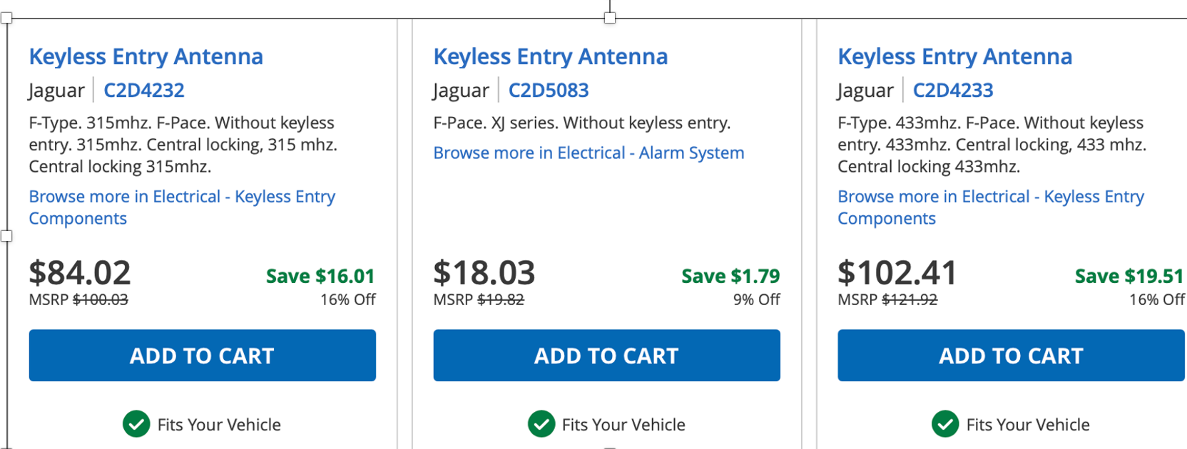

That leaves number 3 above as the likely cause. When I start looking at the parts catalog and maintenance manual there seem to be 2 different parts that could be the problem.
One is the Keyless Entry Antenna I show below, either the C2D4232 or the C2D4233. The parts catalog says fit my 2017 S. But the mhz specs are different so I’m assuming they are not interchangeable and I need to figure out which one is correct if this is the faulty part.
https://www.jaguarparts.com/search?s...nna&ptid=20025

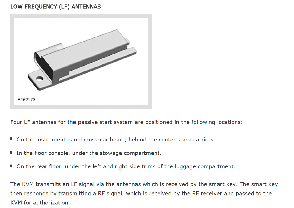

When I look at the Workshop manual however I see something called a Low Frequency Antenna
Page 2029 of the Workshop manual shows this.

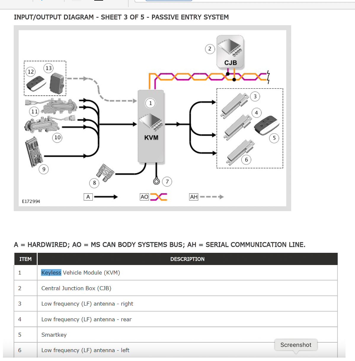

And page 2033 shows this
C2D4232 or the C2D4233 and not shown in this schematic above.

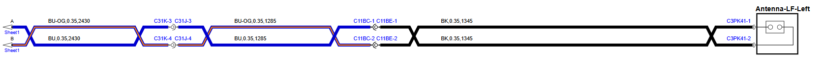

And page 5832 shows this.

Which of these two antennas is likely to be at fault? The C2Ds or the low frequency ones?
If it is the C2Ds, where are they on the car?
If it is the low frequency one which of the 4 locations applies to the driver’s door and not the passenger door?

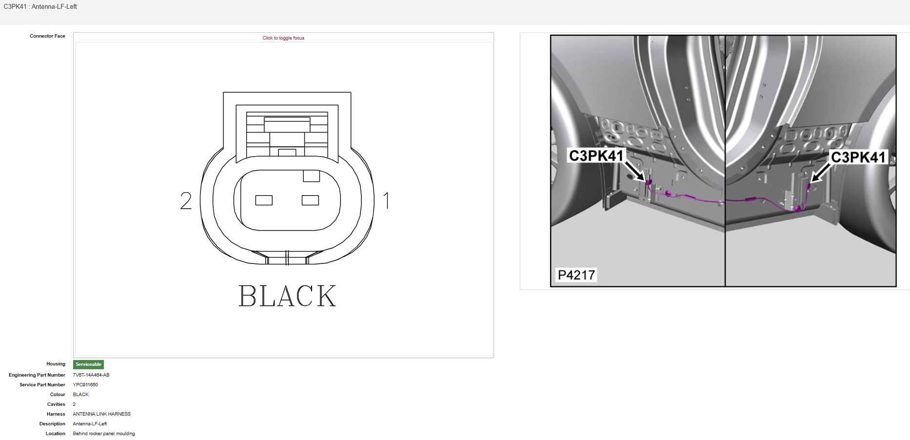

Code is the left antenna open circuit, best bet would be to test at RFA and verify the circuit first, as there are 3 connections between the RFA and the antenna itself.
Antenna sits on the outside in front of the rear tire, behind the sill trim panel. The wiring runs down the side of the car, into the interior, and across the car.

I did some digging and found that the part number for the RFA aka KVM is J9C16073, and I found where it mounts in the car, behind the trim panel on the passenger side foot well.
Since I got a DTC code with my scanner I’m making the assumption that that CAN bus connection to the module is OK.
I’m also assuming that the antenna itself is unlikely to fail.
I think that leaves the most likely causes to be either the wiring from the antenna to the KVM or the KVM itself. Does that make sense?
I don’t know how to test the connectivity between the KVM and antenna since I don’t know what pin the antenna connects to. Does anyone know that? Looks like JLR does not share that.

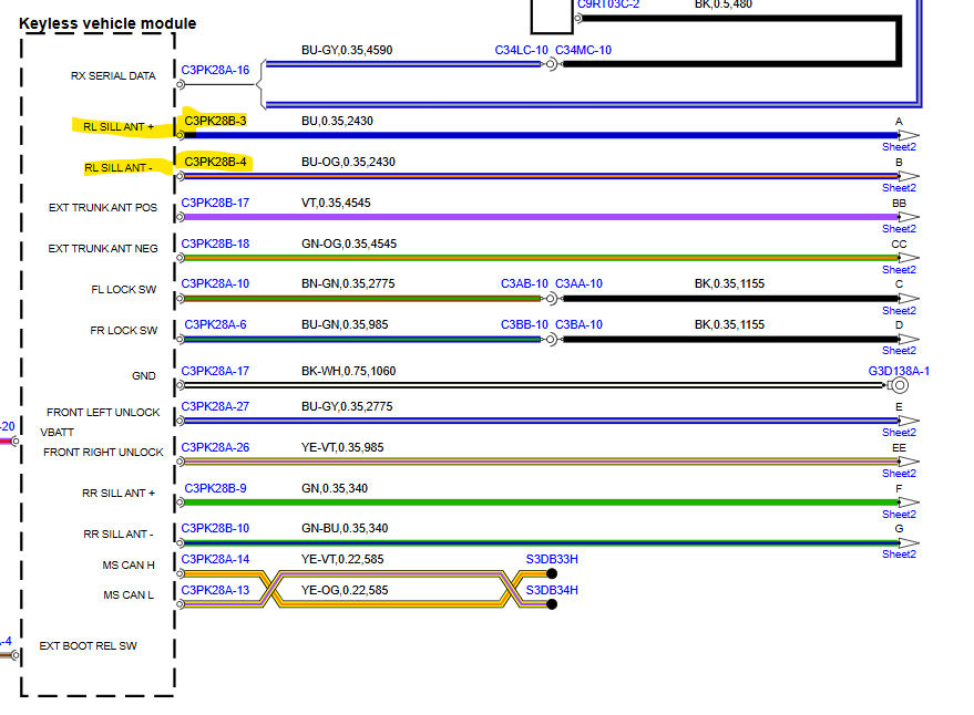

I highlighted in in my diagram, what pins and wires at the RFA/KVM for the antenna in question.
You should have about 10k ohms I think through those antennas, I would unplug from the RFA and test across that antenna, and then the other side to compare.

Doh! I wasn’t thinking apparently, but the color of the wire in the diagram will, of course, match the wire color at one of the 3 plugs into the KVM, right?
Can you share where you accessed that wiring diagram. Did not see anything like that in the Workshop pdf I have.

That's from Topix, I have a regular login because I work for JLR, i don't think you can download the whole thing as it's online based and can be changed live.
The connector name/pin# is there, it's connector B so probably the middle one, I'd have to look it up.
