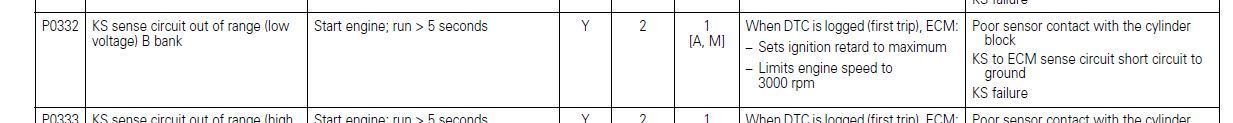

First thing is that P0332 code (DTC excerpt below) could still be the cause of your "Restricted Performance." I suggest you physically check the engine Knock Sensors even after resetting with your OBD scanner.
