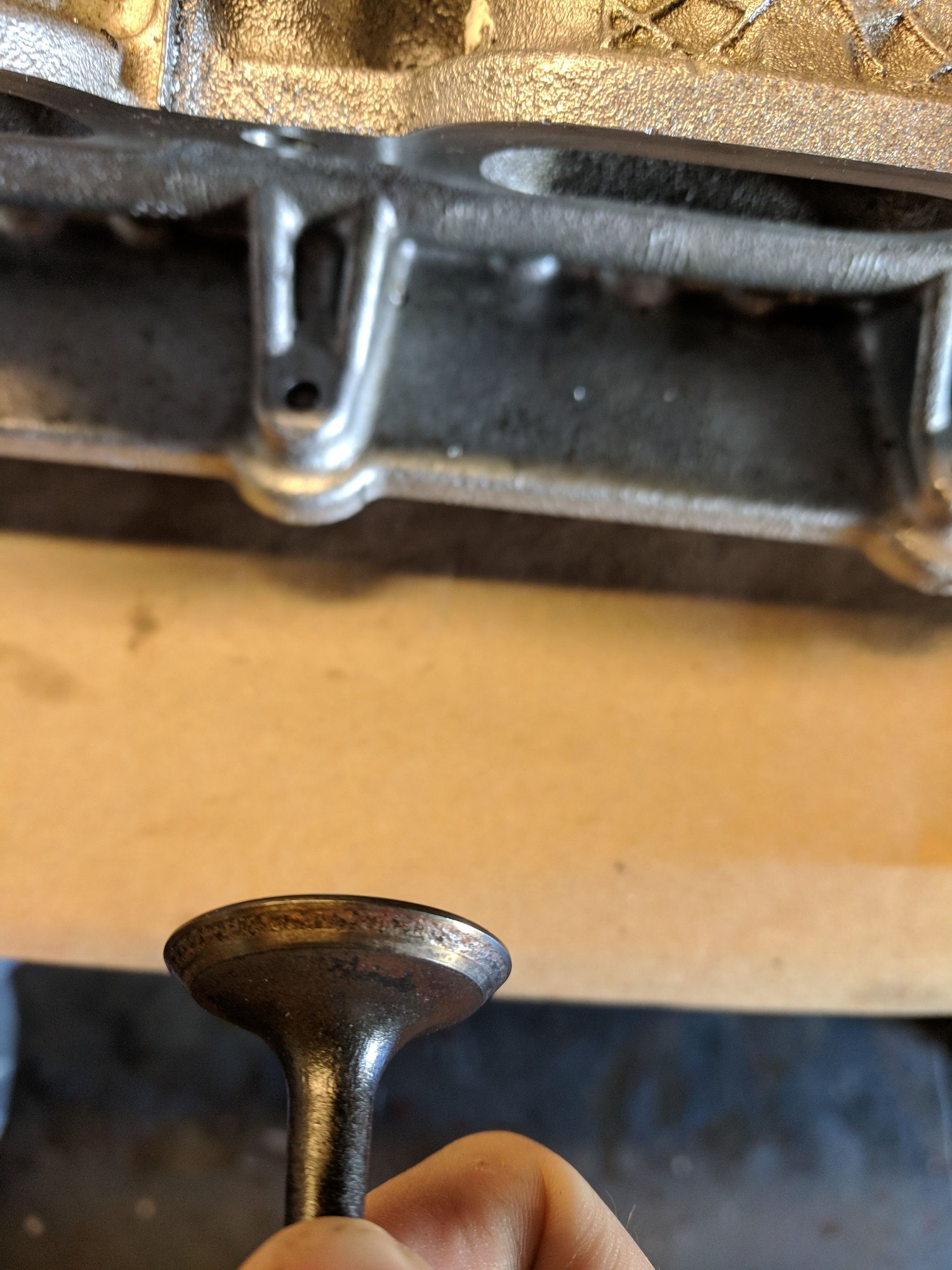

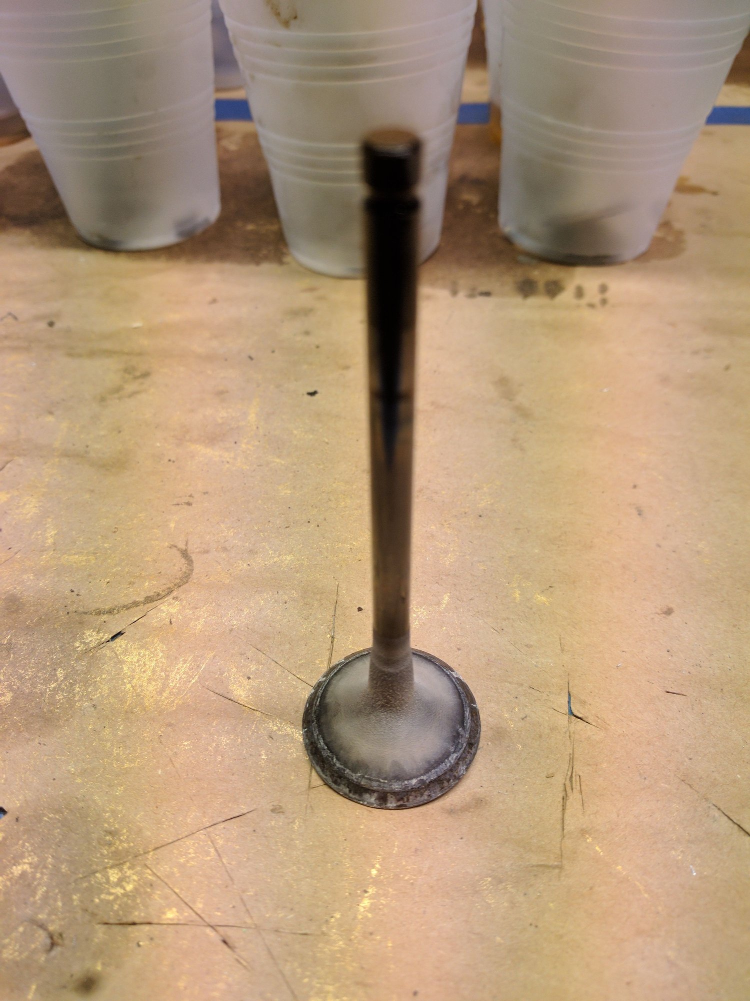

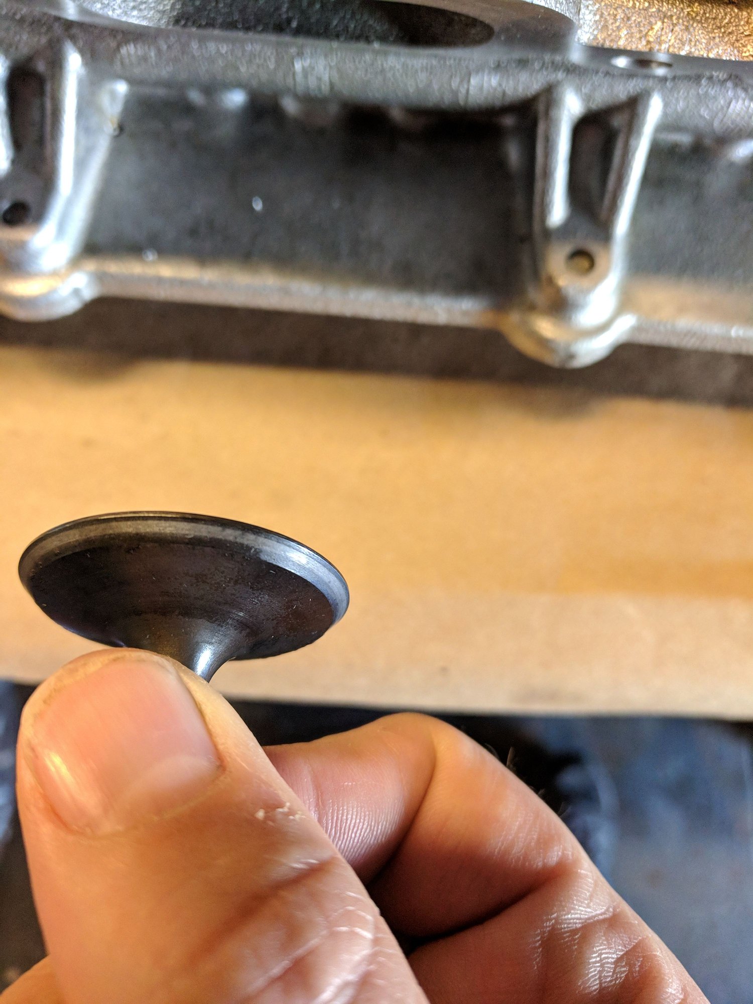

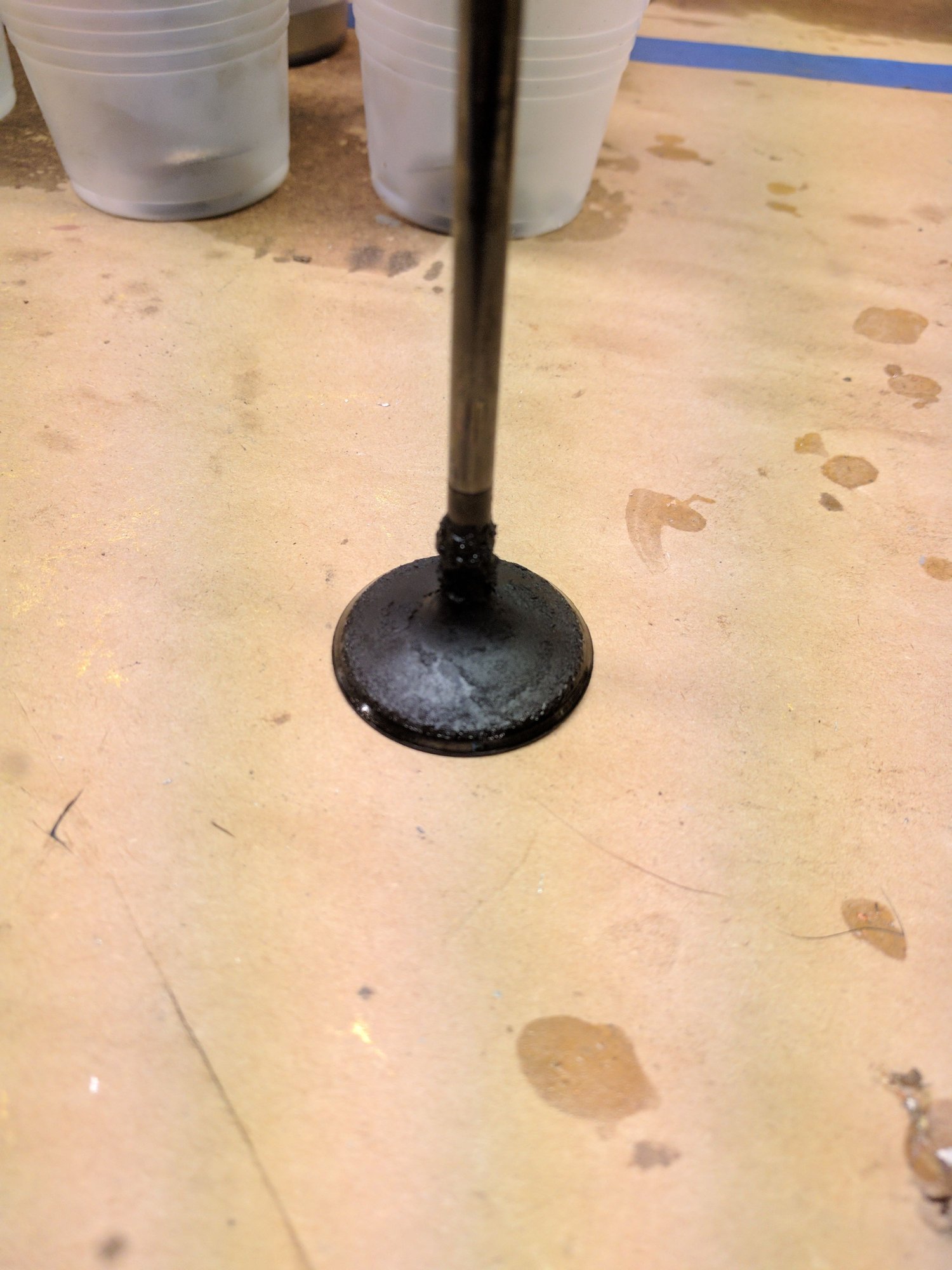

Intake valves were in a pretty appalling state:
But cleaned up and lapped OK:
Exhaust valves didn't initially look as bad....
But once I'd cleaned them up they were pitted beyond repair, so I replaced them:
