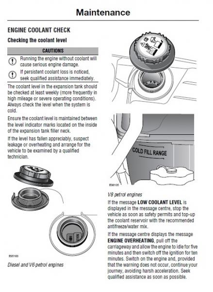

All Jaguars are very sensitive to overheating so if you think there may be even a slight coolant loss, check the level. Do this with the engine COLD.
A slight loss could be a warning of a loose hose connection or a failing hose.
