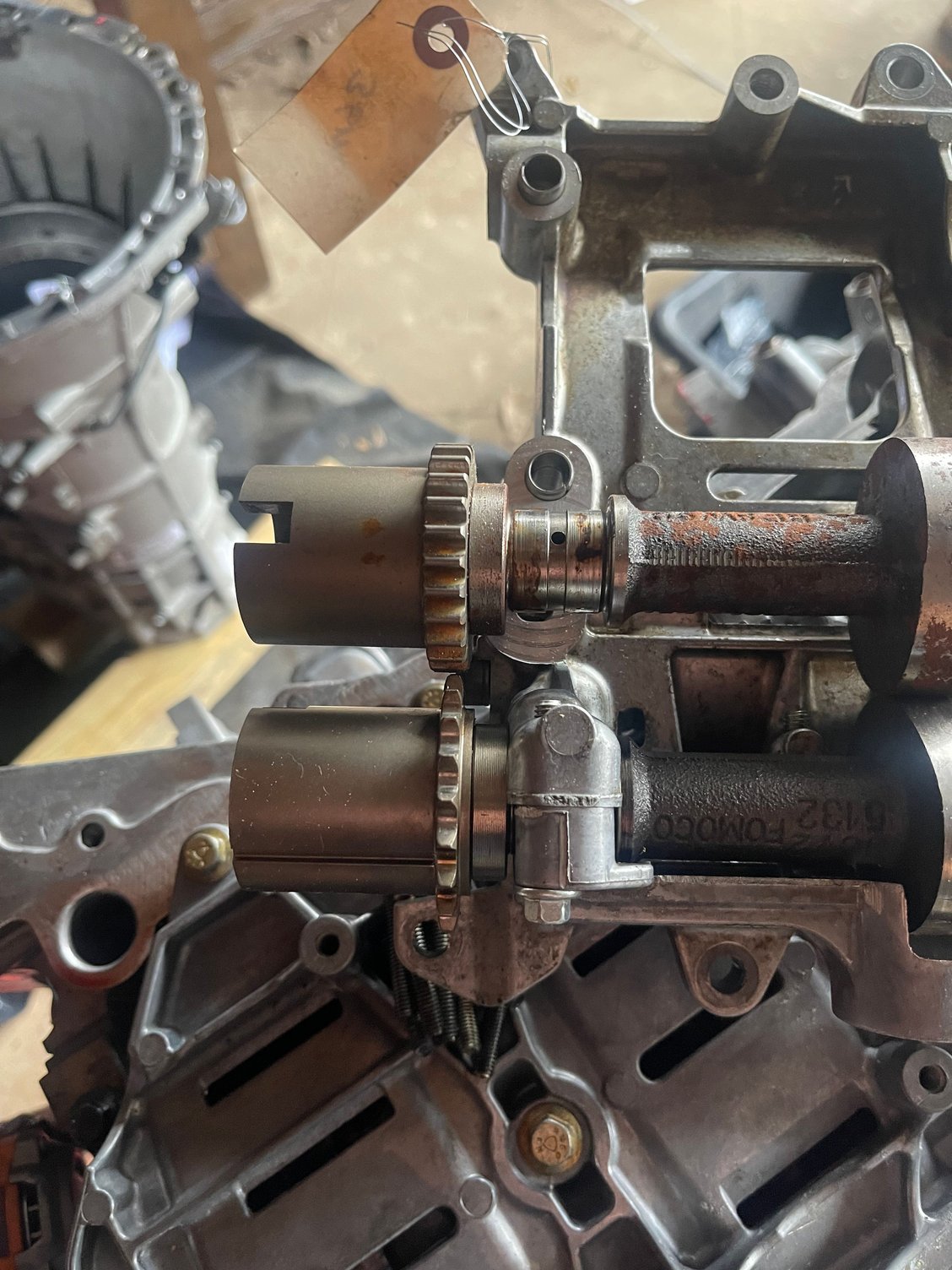

Thanks again for the insight. It's appreciated. I've always hand cranked it from alignment to alignment...no real procedure that calls for it, just for personal reassurance everything is perfectly aligned. However, in retrospect, this may be the reason the shop manual only tells you to rotate 2 turns to check for interference. So there's that.
As for the bottom end, they used Tsubaki width chains and then switched. Again, as I believe we both agree, the Tsubaki chain is superior to the INA chain...it's wider, stronger and "smoother." If it wasn't for the fact that I was worried about the variators on the donor engine, I probably wouldn't have swapped them out.
I took a pic of the 2 different HP fuel pump cams...really illustrates the difference between the 2 styles. (Sorry, I feel like the pic is gonna be real big, I don't know how to shrink it down)
Here's another funny one for ya! I saw a couple different "conversion" kits. All of them included a new crankshaft sprocket and oil pump cog...but NONE of them included the HP fuel pump cam!! I mean, what do they think you're gonna do? That said, I couldn't find a new HP fuel pump cam and had to get a used one...still attached to the windage tray.

Interesting. My Tsubaki based engine has the normal narrow pump chain.
